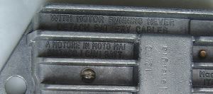

Concerning disconnecting the battery while running, not sure it would be a safe thing to do, especially in flight :
[img]cid:1729f48fe02ee31c21b1[/img]
