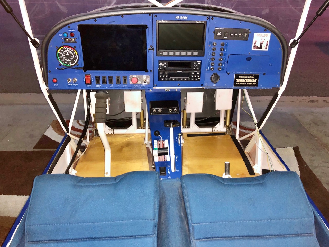

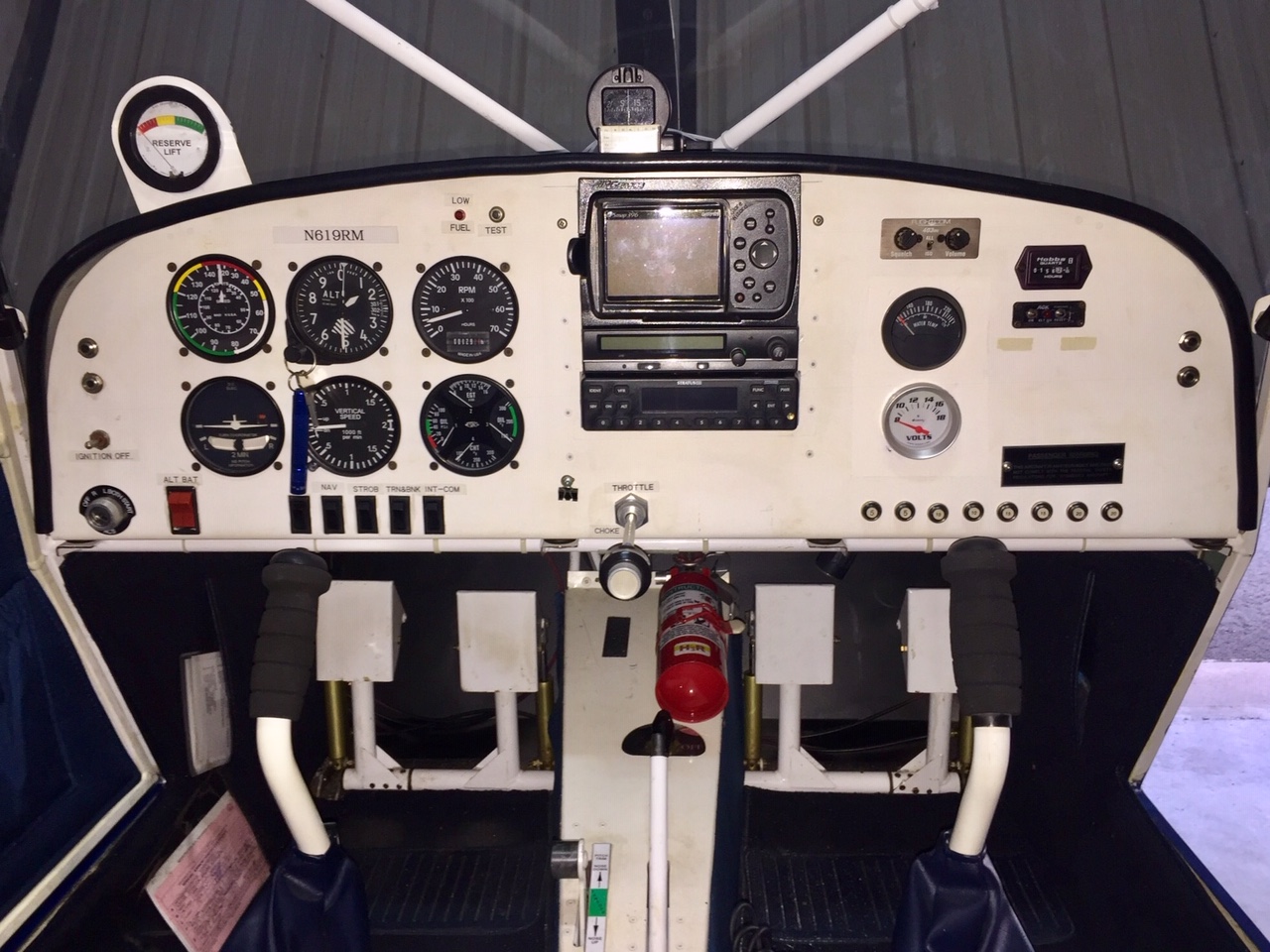

Hi all,

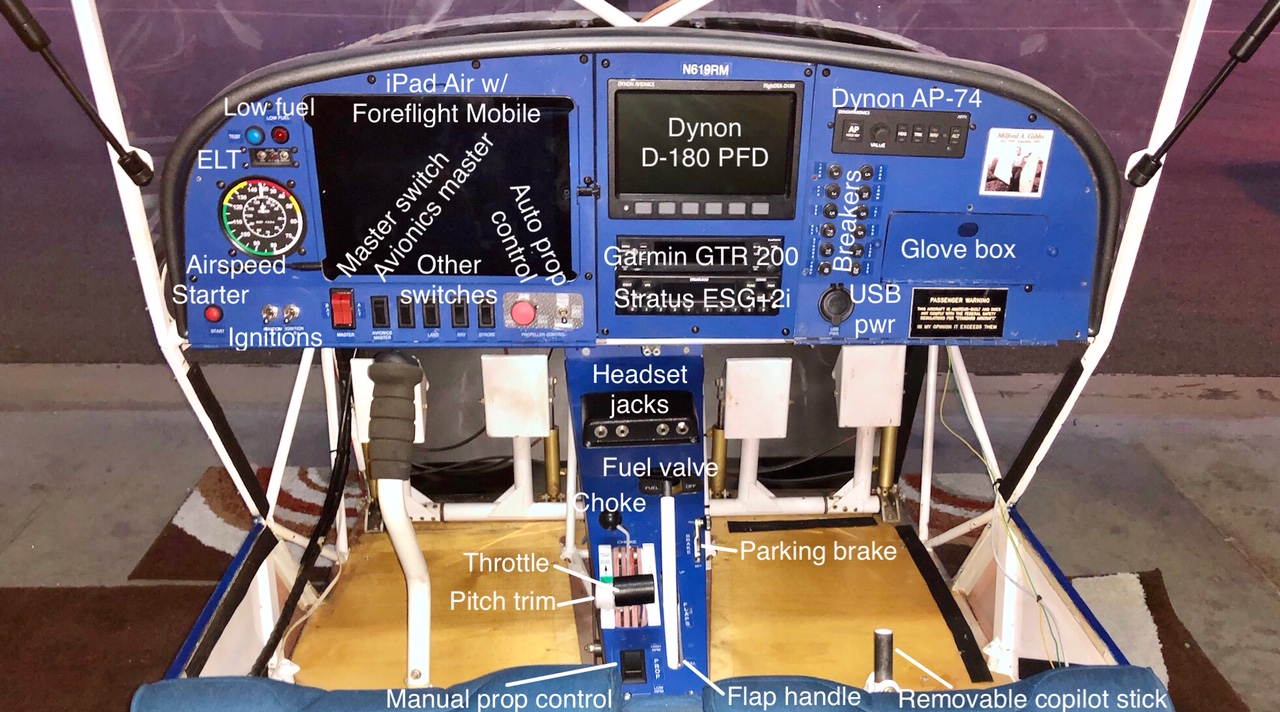

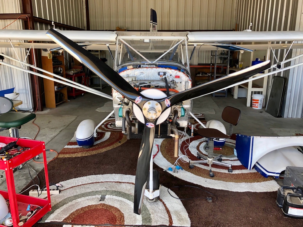

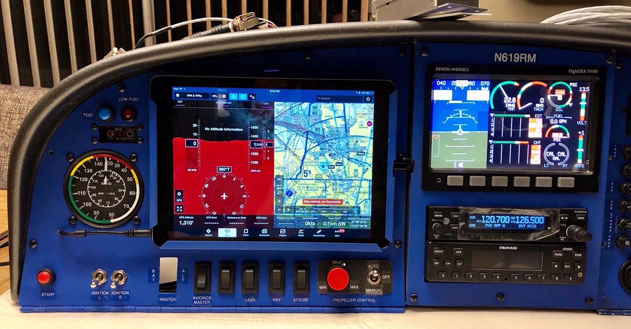

I thought I’d share the upgrade project I completed last weekend. My Kitfox Series 7 was in need of a panel upgrade. The new panel was built in the shop and assembled on the living room table. A few months ago I pulled the old panel out of the plane and started working on installing the new one.
Original panel (2005-2019)
New panel (in the dining room)
New panel (installed). I moved the engine controls down to the console while retaining the mechanical pitch trim handle there. It’s a tight squeeze underneath but we got everything to fit.
Here’s what’s what. There are no autopilot servos installed at this time, but the Dynon AP-74 has a knob that makes things like altitude/heading bugs and altimeter settings much easier than poking buttons on the main unit.
She also has a new Ivo in-flight adjustable prop with constant speed controller. The previous prop was a very nice Whirlwind but it was ground-adjustable only. Of course, the new prop required the Rotax hollow prop shaft and she had the solid one, so that added $$$ to the project!
I finished the last of the ground testing on Saturday, so I think she’s ready to return to the skies.
Mike G.

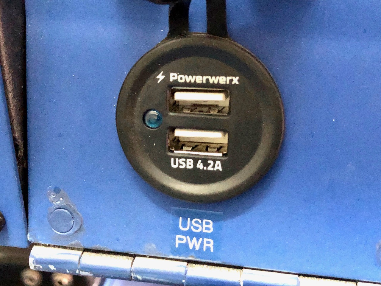

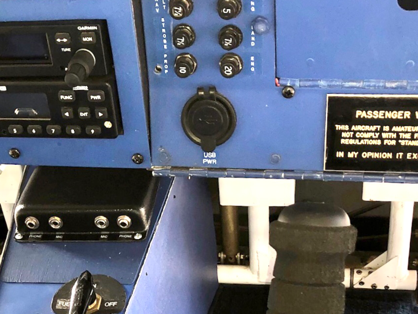

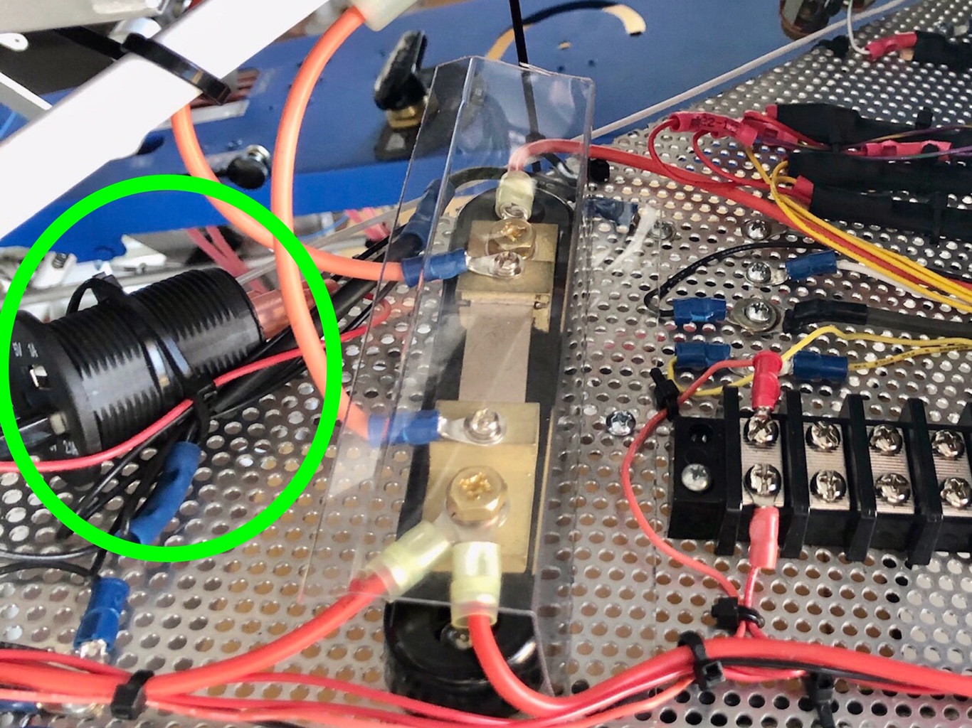

I have found my 2.5 amp USB charger can't keep up with the Ipad on long flights. What are you using for power?
(the home Ipad charger is 5 amps I think)?

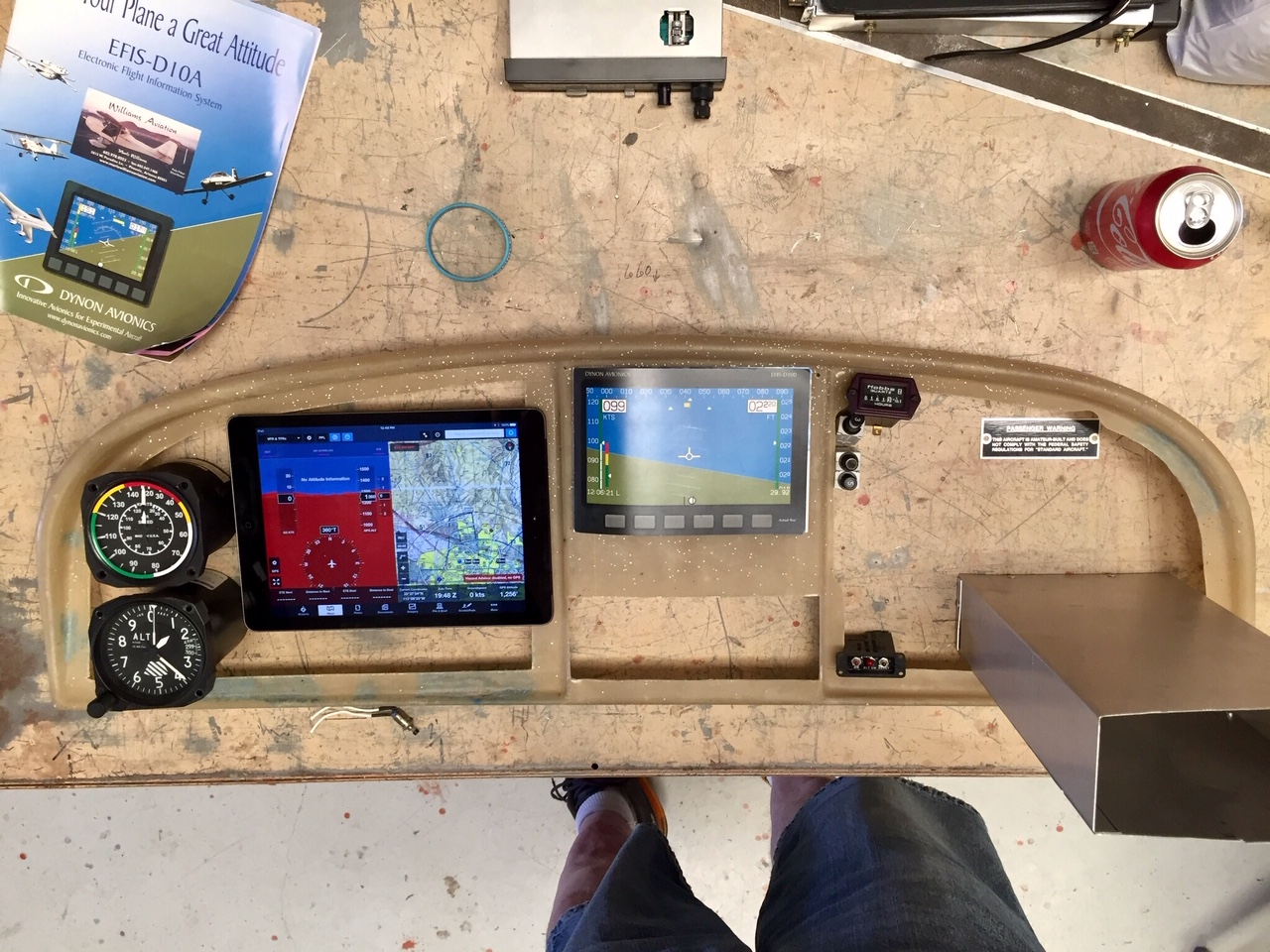

PostPosted: Mon Jun 08, 2020 7:39 pm    Post subject: Panel Replacement Reply with quote
Thanks for the kind comments, everyone.

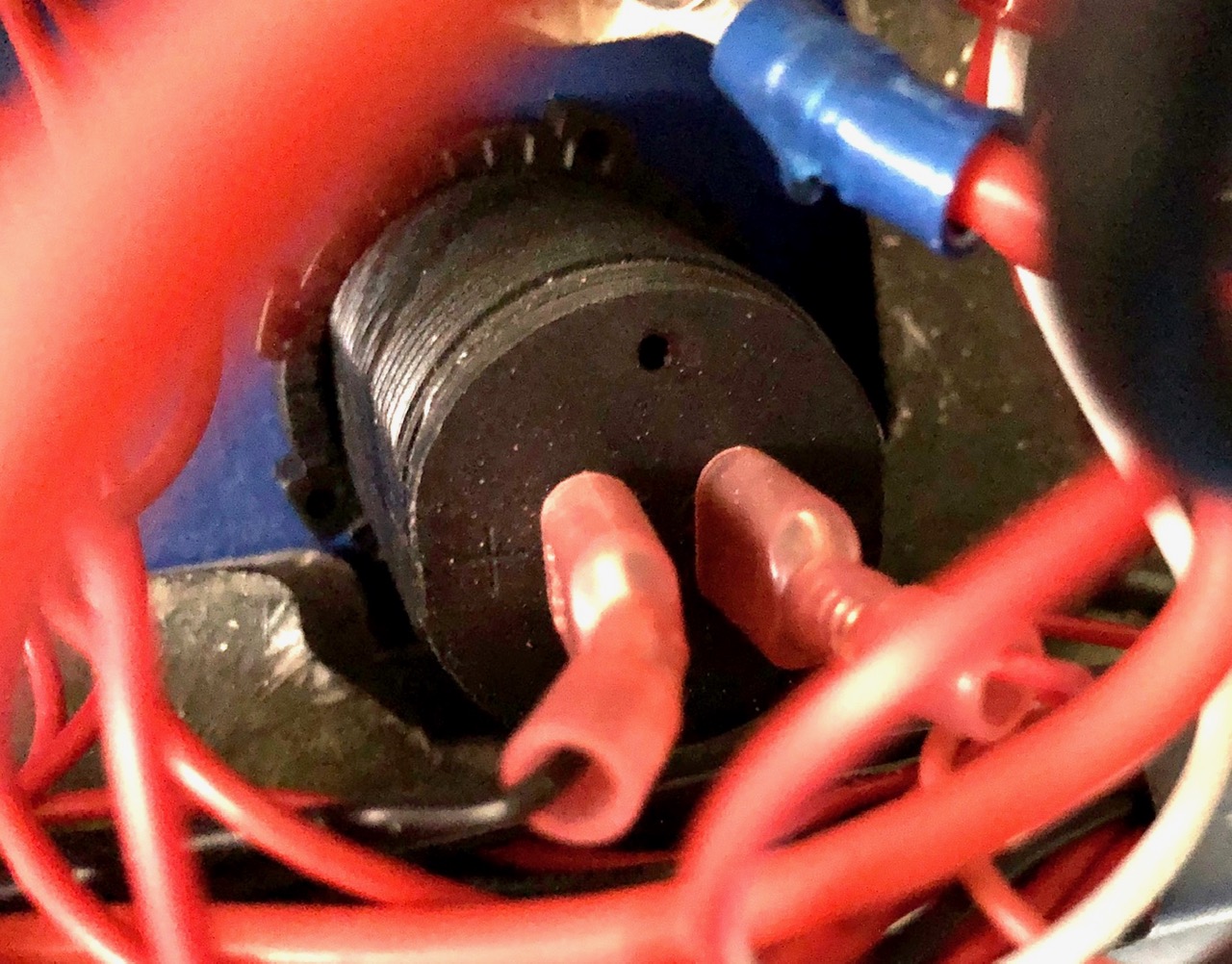

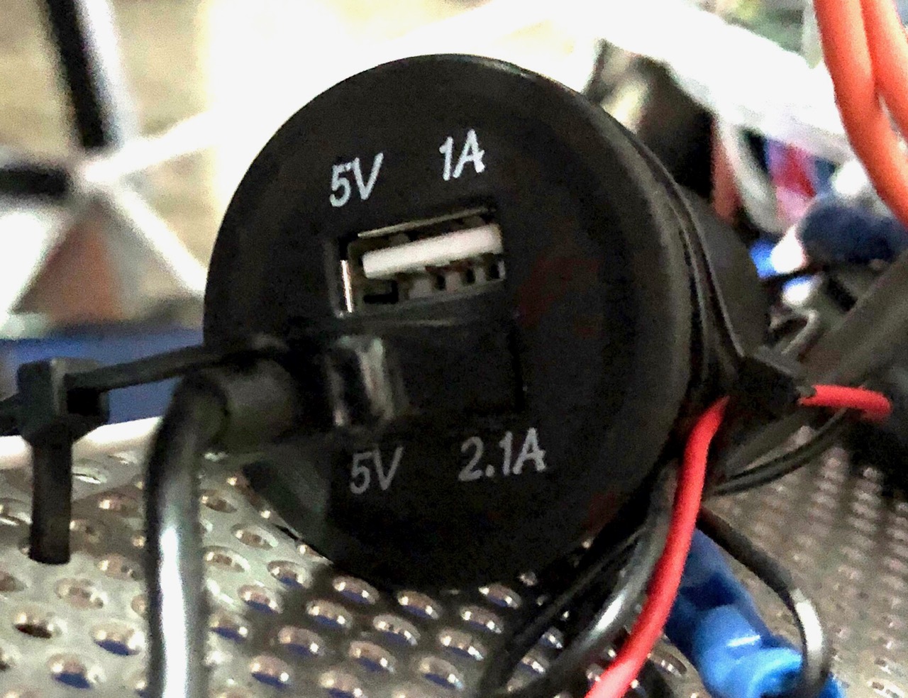

Actually, the iPad mount is home-grown. It’s just a sheet of aluminum with three edges folded over to grip the edges of the iPad. The top is open and it pivots on a piano hinge, so I can pull the small latch up, tilt it forward, and slide the iPad out, if needed. There’s also a small computer fan behind it that comes on with the master switch to help keep the iPad cool.
I used a small USB plug behind the panel for power. It provides 2.1 amps to each of two USB sockets (only one is used). This is an iPad Air, so 2 amps is enough to power and charge it. You have to be careful with power plugs, a lot of plugs that are labeled “2 amps” also have two plugs, and each plug only provides 1 amp, which is not enough to power the tablet. This one is rated at 4.2 amps, so 2.1 is available for each plug.
It’s not a good picture, but this is the USB plug before it was mounted behind the panel. There is a second one on the front side of the panel for pilot and passenger use.

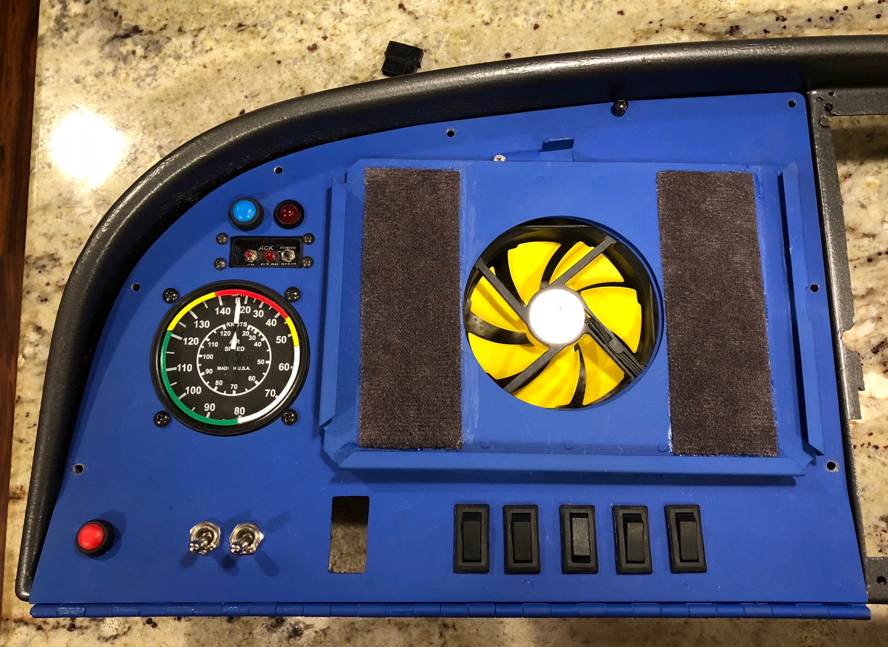

michaelgibbs(at)cox.net
PostPosted: Tue Jun 09, 2020 8:33 am    Post subject: Panel Replacement Reply with quote
Hi Kirby,
The fan is just a generic computer fan I picked up at Fry’s electronics. It seemed like a good idea. Smile It’s very quiet (not really important in a noisy airplane!) and moves a lot of air.
I don’t have the original packaging but it turns out I used two different devices. Both are meant to be panel-mounted but one of them is hidden behind the panel.
This is the one that is available for cockpit use, it’s from Powerwerx. Note that it is a 4.2A model, with 2.1A available on both ports.
There are no additional markings on the back of the unit.
The one that is behind the panel powers the panel-mounted iPad. It is a 3.1A unit that provides 1A to one port and 2.1A on the other. The 1A port is not used.
I hope this is helpful.

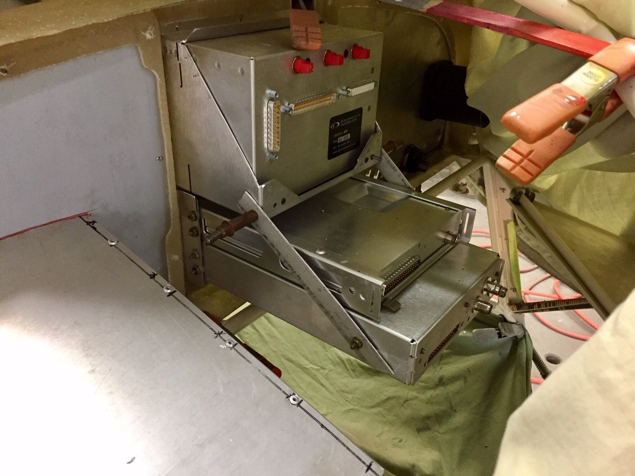

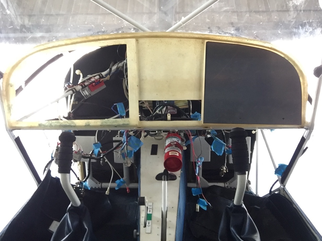

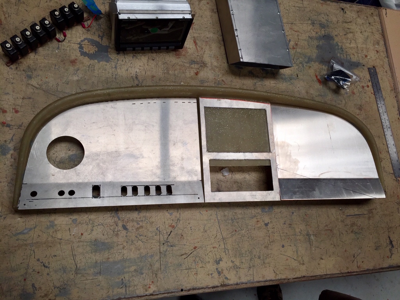

In case any of you are interested, here are a few pictures from the build process on the panel.
Fitting the fiberglass frame. Yup, that should work.[img]cid:9D8B5960-286A-42FC-9457-A3CB92BCAB84[/img]
Hmmm...where will all this stuff fit?
[img]cid:42CF93A1-B952-46B9-B8A4-B56699CC326C[/img]

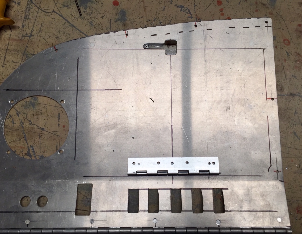

Cutting out the aluminum panels. It’s in three pieces and the two outer ones each have a piano hinge along the bottom so they can fold down to make it easier to work on the back side if that’s ever necessary in the future. The radios and PFD in the center section make it too deep to hinge down so it is built to slide right out the front when you remove the screws.
[img]cid:40581577-4434-4E00-AC62-022727A4DE3B[/img]
Center panel section with Dynon, radio and transponder installed. The supports needed for the back end of the longer components are all self-contained so the entire assembly can be removed as one unit.
[img]cid:1497F303-21C5-4BBB-A484-DFFF15B3ECF6[/img]
