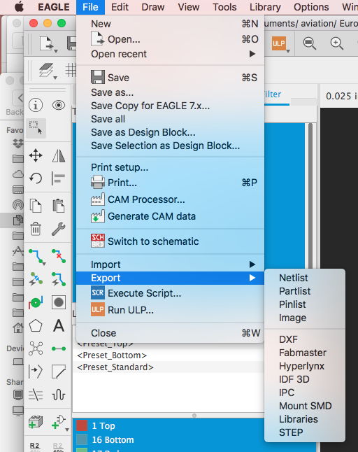

I’ve had a look at the export possibilities provided by my version of EAGLE (9.6.1) and the file format possibilities do not include Gerber - see attached screenshot. Maybe someone can say if one of the options shown would be more universal than a .BRD file. Or once the .BRD files are put up by Bob, folk can play with them and try translating to Gerber.
Hi Rowland,
Thanks for that.
If I recall correctly I tried the CAM option(s) to generate the gerber and .drl files.
Will post them on the webpage for anyone to download.
