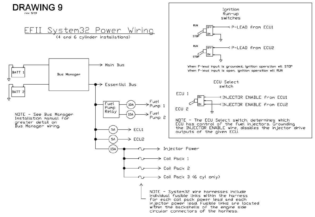

I’ve followed EFII System 32 power wiring schematics (see attached file) logic and breakers/fuses value recommendations, but I will not be using its Bus Manager.

Single points of failure:
    All four injectors are powered by one reley, wire, and fuse link.
    Both pumps are powered thru the same switch.
Questions:
    The injectors have fuse links in the harness. Are they sized so they won't pop the one fuse link that feeds all four injectors?
    What happens if both injector enable inputs are un-grounded?
    Why are there relays for removing power from the coils?
    What is the EFII Syst 32 Inj Pwr Module? I would have thought each ECU box has open collector injector drivers inside.
    Will the automatic aux pump feature result in a relaxation oscillator? (No pressure, pump on... now we have pressure, pump off, repeat.)
    Where are the batteries located?
Thoughts/IMO:
    It would be simpler to have separate toggle switches for left and right coil "P-Leads".
    It wouild be simpler to have an SPDT switch for injector enable grounds like EFII illustrates but what is the effect if the ground is lost to both injector enables?
    EFII shows SPOFs that will stop the engine in Dwg 9 rev 5/19 that you attached.
*** The one wire & fuse link is supplied by the manufacturer and is the recomended setup. I added a relay to be able to switch power source between EB1 & EB2 when selecting an ECU (or both). The relay could be replaced by diode protected feed wire, Not sure if this would be safer?
*** Agreed, but what is the failure mode of a switch? 1) Welded shut contacts? The one pump would always be ON. 2) Worn contacts, then 1 of the 2 pumps should be able? I'm I wrong?
*** Fuse links / Are provided and sized by the manufacturer, so they are sized appropriately.
*** Un-grounded injector enable inputs / Then both ECU will try to drive the injector, not a good thing, but their is no work around that I can see. However, with my setup, the first step to trouble shooting is always using the KEY switch in the BOTH ECU position (normal position), select ECU 1 and MAIN FUEL PUMP, if the situation does not improve, selct ECU 2 and AUX FUEL PUMP.
*** Relays for coils / This is to create 2 independant subset of components that can be isolated along with ECU 1 or ECU 2 using only the KEY switch. So the KEY switch allows to kill either ECU 1 or 2 and all their sub-components in one action "kill ECU 1 & TOP COIL and transfer control of the INJECTORS to ECU2" or "kill ECU 2 & BOTTOM COIL and transfer control of the INJECTORS to ECU 1". This could be done with 2 DPDT switch, 1 switch powering ON at the same time ECU 1 and TOP COIL, and a second switch powering on ECU 2 and BOTTOM COIL.
*** Automatic pump feature / This one is over my head. I have no clue! That behing said, I will have to check with EFII as the system preset pressure is 35PSI, but I have not seen a minium PSI value.
*** Battery location / In a Cozy, they are typically located on the cabin side of the firewall.
I don't know how to have faith in Bus Manager (I know you mentioned you are not using Bus Manager) or EFII in general when they show un-necessary SPOFs that will stop the engine. Ref EFII Dwg 9 rev 5/19 that you attached.

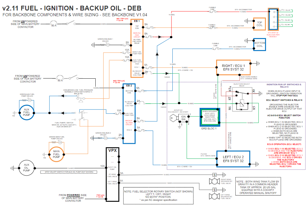

OK, I revisited one of my previous diagrams and went back to dividing components between EB1 and EB2 instead of controlling them through various relays.
This division will allow me to shut down a subset of components by killing either EB1 (shutting off ECU 1, TOP COIL & MAIN FUEL PUMP) or EB2 (shutting off EC2, BOTTOM COIL, AUX FUEL PUMP).
The injector selection and P-LEAD grounding is still controlled through a standard OFF/1/2/BOTH key switch and a single changeover relay.
I've also changed the power path to the AUX FUEL PUMP. By changing the low pressure switch power source from EB2 to EB1, if the fuel pumps DPDT switch fails, the AUX FUEL PUMP will still be powered through the previously mentioned low pressure switch. That should solve the single point of failure issue of having both fuel pumps powered through one switch,

Re v1.04 and v2.11 and in light of my experience applying (designed, not implemented) SDS EFI+I to Z-101 (one batt, dual alternator).
Questions:
    What is the EFII System 32 Injector Power Module? Is that something EFII supplies? It shows the injectors grounded/always on which of course is not the case.
    Does the automatic aux pump feature come from EFII? I was thinking it comes with Bus Manager which you are not using so I was thinking you designed this feature.
    Is there a need for powering the injectors select relay from EB1? If EB1 is off, ECU 1 is off.
    Is the flyback diode built in to the relay?
    What injectors are used? SDS uses 14.5 ohm "saturation" injectors.
IMO:
    Removing the injector auto fail over and coil select relays of v2.10 was a good idea. No need to buy, install, preflight, explain and remember functionality, fewer failure points.
    The automatic pump feature is not required. No switch SPOF, no diodes, no pressure switch. Run both pumps at low altitude (which is legacy training). If the engine stops at cruise altitude, the crew:
      Moves the injectors to the bku ECU.
      Turns the bku fuel pump on.
      Opens alternate air.
      Checks fuel.
      Restarts with starter or windmill.
    Ignition switch function is confusing because when it's on both you have both coils but injectors are on ECU 1. There's no way to fire both coils and have the injectors on ECU 2 (a good idea in any case and may be required for fine-tuning ECU 2 although EFII seems to say this is not the case). Assuming EB 1 and EB 2 are both powered:
      Off - boths coils disabled, injectors will fire from ECU 2
      Right - bottom coil disabled, injectors will fire from ECU 1
      Left - top coil disabled, injectors will fire from ECU 2
      Both - both coils enabled, injectors will fire from ECU 1
      Delete key switch and relay, use toggle switches for P lead 1, P lead 2, injector enable (SPDT). Or if you really want the key, use it for ignition only and replace the relay with toggle switch.
    Replace 2A fuses with 5A so you stock one less size.
    The batteries and the engine are in the back. Power EB 1 and EB 2 with relays in the spirit of FAR 23.1361. The feeds can be unprotected if short or you can use a MIDI 23 or 16 awg fuse link wire on 12 awg feeder.
Notes:
    Injectors:
      I don't know the awg of the fuse links at the individual injectors or the the one in the common wire but they do nothing (24 awg melts at 29A). A short to ground anywhere will blow the fuses and you will lose all injectors. I don't know how to justify powering all injectors thru one path. Seems likely a three cylinder engine will hold altitude.
      The 5A fuse is too small for four injectors. The injectors might run up to 85% duty cycle in normal circumstances which means 3.4A. At 100% they will draw 4A. Better make them 10 A or even 15A.
      I plan to use individual 5A fuses, one per injector. This leads Z-14 to an injector bus after the diodes, un-fused short wires from EB1 and EB2 to injector bus. Z-101 shows an engine bus instead.
    I have a different unerstanding of switch contacts "normally open" and "normally closed" compared to you. Relay terminal 87a is normally closed, opens when the relay is energized. Edelbrock pressure switch 72213 is normally open, closes with pressure.
    Coilpacks:
      I assume the coilpacks have integral drivers and their connections to the ECUs (not shown) are logic states.
      It looks like EFII uses the same Subaru coils SDS uses. (EFII uses three coils in six cylinder applications, one of which fires top and bottom of cylinders 5 and 6. SDS uses two coils on six-cylinder engines, on top, one bottom.)
      I'm taking SDS' advice of separate fuses for each coil, each 10A.
    Fuel pumps:
      Yes, failure of the DPDT fuel pump switch in such a way as to stop both fuel pumps is highly unlikely. The switch would have to fall apart. I mention it as an SPOF but not the highest priority SPOF (the highest priority SPOF is to power the injectors independently).
      It looks like EFII is using the same pumps SDS uses, Walbro GSL393.
      I'm taking SDS' advice of separate fuses for each pump, each 15A.
    I normally expect the left ECU to be primary. Is that just me?
    The main alternator only needs 6 awg, or even the 8 awg shown in Z-101.
    The aux alternator only needs 10 awg and its ANL could be 35A.
    You could use the physically smaller MIDIs from Littlefuse instead of ANLs. You could also use fuse link wire as shown in Z-101.
    Wires to crossfeed contactor and starter can be 4 awg.
    Batteries are labeled EXT; I assume you mean ETX.
    Battery temp sensors are not normally used with batt in engine or passenger compartment.
    The aux alternator field should have a 5A CB versus a fuse because it has crowbar OV protection.
