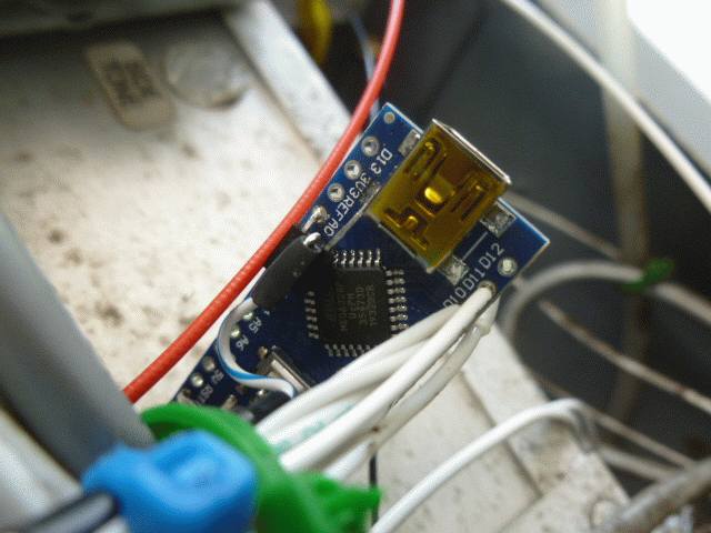

I was able to use an Arduino Nano to convert serial altitude output from my Dynon D-10A (same from D-100) to gray code altitude inputs on my Garmin GTX 320A transponder.
That replaced my AK-350 altitude encoder. Saved some weight, but mainly I now know that the altitude I see on my Dynon (set to 29.92) is what ATC sees.
I measured altitude inputs on the GTX 320A. Takes less than 0.1mA to pull an input to ground. Internally pulled up to 5V (I measured 4.35V), apparently with a 50K resistor and also has isolation diodes according to the manual.
That means that the digital outputs of the Nano can drive the transponder altitude inputs directly (but needs to be inverted from the altitude table on the aero-electric web site:1 = 0 volts).

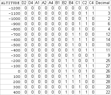

http://www.aeroelectric.com/articles/Altitude_Encoding/modecascii.txt
(Note that C4 is LSB and D1 is MSB,  so table should be re-arranged as:
[img]cid:part2.BBB064CB.A051C6CF(at)gmail.com[/img]
...  to make a lookup table in the program. (I'm sure there is an algorithm to calculate the codes, I just found it easier and safer to use the table.)
The serial altitude output from the Dynon are +-7V volts, so needs to be brought to 0 to 5V for input to the Nano. A 2N7000 FET does that nicely. Source to ground, Drain to Nano input (internal pull-up  resistor enabled) and Gate to Dynon output. Gate can handle +-20V, so if handled carefully needs no additional components. Also inverts the signal to what the serial software expects (active low).
