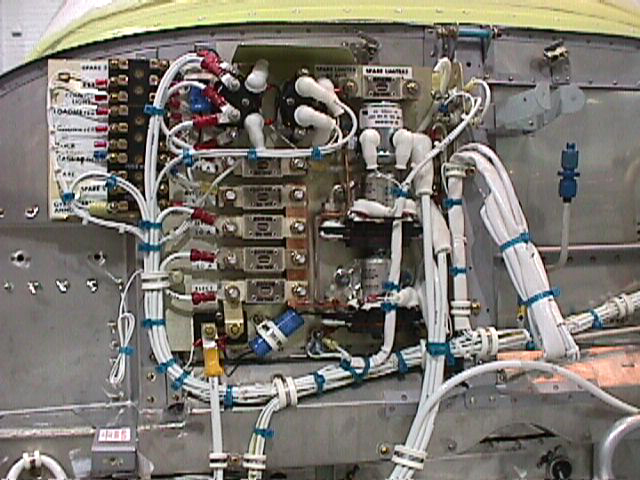

It's true that feeder protection is rare in light aircraft.
Not so rare in heavier singles and twins (See attached
picture of A36 firewall circa 1995) and quite common
in aircraft like the B787.
But to be sure, any circuit protective device
situated upstream of another CPD will be an
order of magnitude more robust than its downstream
brother.
brother.
Bob . . . <A36_Firewall.jpg>
