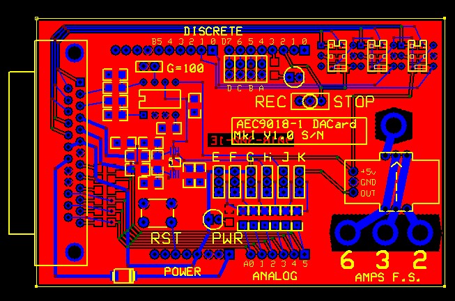

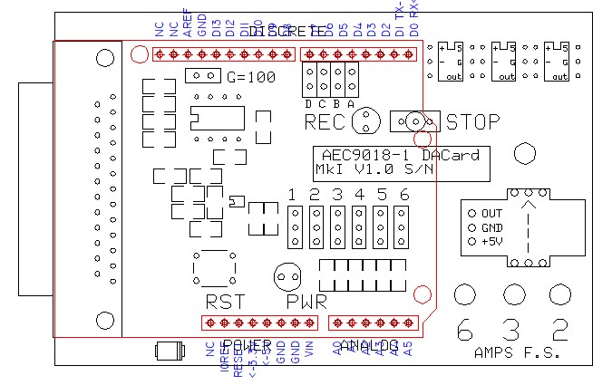

The microcontrollers I'm planning to use have lots of A/D pins, so that's not a problem. They're Arduino compatible, but at 3.3V, so I wonder whether the LTS 6-NP must have a 5V supply voltage? If so, that'll factor in to the multiplier produced by the parallel wires, to make full scale no more than 3.3V.
Which boards are you planning? I've got
an UNO DAS shield that was crafted to
mate with an Arduino R3. It's got one
dedicated LTS6NP sensor. The LTS6 has
three internal passes through the core
brought out on six pins. I've arranged
to exploit those internal passes with
terminals that place 1, 2 or all 3 in
series for 6, 3, and 2 amps full scale.
Of course, the drilled aperture is available
for customized passes on the monitored
conductor.

of the DAS shield illustrated. The assembled
Arduino boards includes an SD memory card
socket. The software allows user selected
sample rates and writes data to comma delimited
ASCII files. If you'd like to explore this
hardware in more detail, I'll get you the
schematics. AEC-Lister Paul Fisher has put
considerable effort into the supporting
software. I'm pretty sure he'd be interested
in spooling this project up again.

I've got
  conductor.

Thanks! I really want to explore the smaller Feather devices, but your
DAS shield is an excellent starting point, and much of Paul's software
may be usable since the Feathers support the Arduino IDE. (They also
have "Circuit Python," but I don't yet know the differences.)
