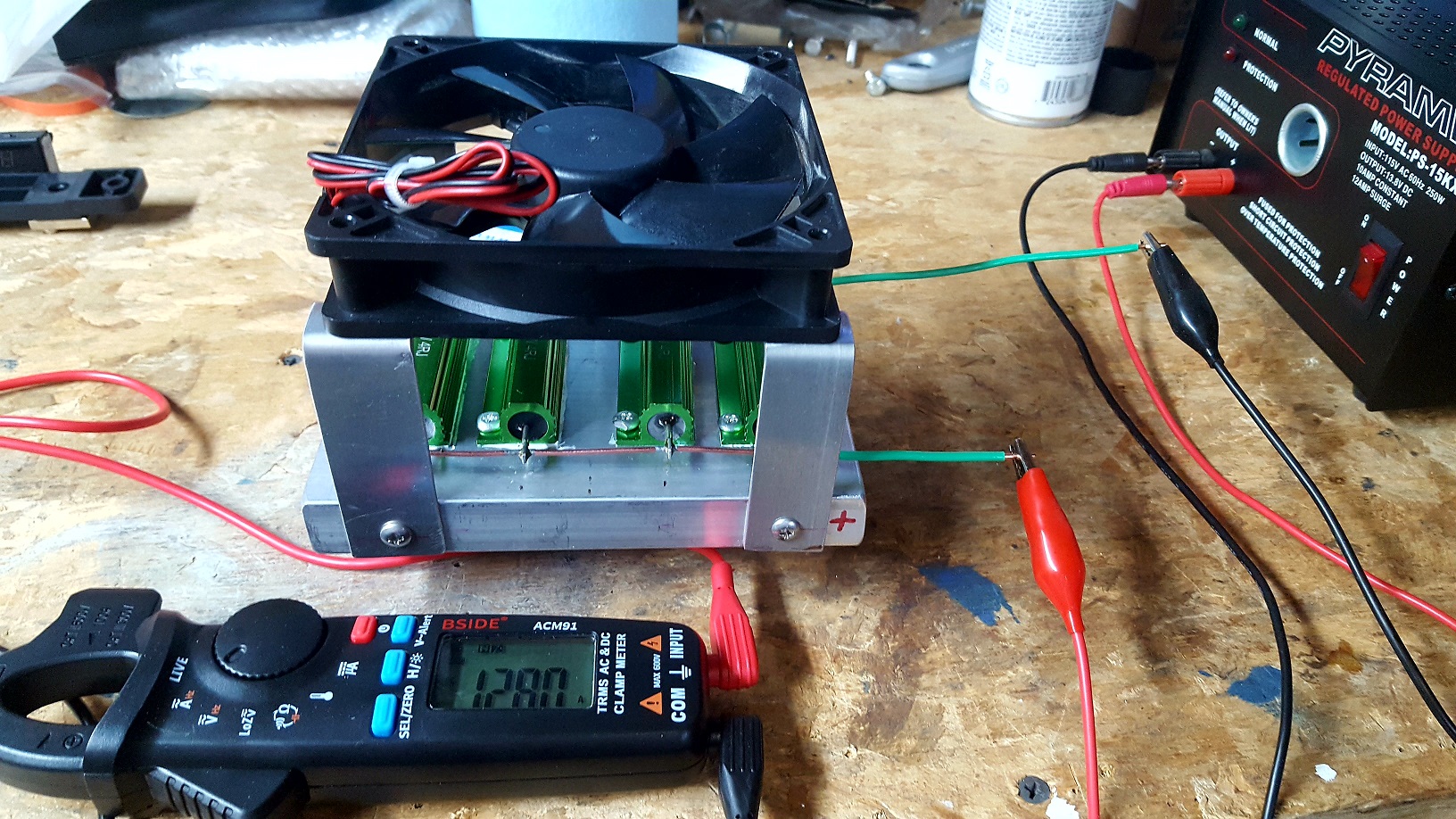

Bob, that's pretty clever. In my case how "fancy" should I go? For connections to the load from the battery, I was thinking of simply using two leads of #10 wire with alligator clips on both ends and having an inline fuseholder on one lead with a 15A fuse. Or...do I fabricate a switched/fused platform, with ring terminals for connections, etc? User preference?
What you describe would be fine. You're not
switching a really big current . . . yeah, there
will be some 'sparking' when you clip the final
joint closed but they don't call us electron-herders
'sparkies' for nothing.
20 AWG wire would be fine . . . the leads are
short and the anticipated 13A load is easily
managed by that size wire. Same with alligator
clips.
KISS my friend . . . KISS

Finally received my 4 ohm 100W resistors to make up a resistive load for doing my battery capacity checks. I get 12.8A through the load and plenty of heating of the heat sink (so I added a fan, and a couple of cooling fins) to the heat sink which is a 4"x6" slab of 3/4" aluminum. Will be interesting to find out what the EarthX battery will do for time before disconnecting.
