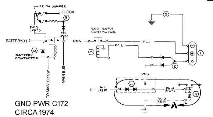

Bob, thank you for the long story. Actually I used your scheme with the OV protection and the GPU is wired to be plugged in directly on to the battery through the EXT PWR Contactor.
If I am not wrong, Marc Ausmann's scheme connects the GPU to the battery as well. This is what I am planning for..
But with your scheme there is no need to turn on the MASTER SWITCH..
Yes. I do that so that the external power
can also be used to charge a battery
in-situ without powering up the rest of
the airplane.
C172 and SR22 -both require to turn on the MASTER to close the BATTERY and EXT PWR CONTACTORS at the same time. Thus you are not able to charge your battery unless you leave the MASTER ON (stupid?) or you connect your charger directly with the battery poles or take the battery out..
Yeah, that theme goes back quit a ways. See
exemplar 1974 wiring attached. 1962 C185
does about the same thing. With the battery
master off, you can crank the airplane but
you cannot charge the battery. In the 74
172 drawing we see the avionics bus
disconnect relay (item 4) which unhooks
radios while cranking and/or when ground
power is hooked up.
Hinky ground power sources have been around
since day-one but the philosophy behind their
use is not an industry wide consensus.

Dead battery is clear but why not charge a weak battery if your charger is safe..?
Or is it that the intelligent charger might not provide enough amps to close the
EXT PWR Contactor when plugged in through the EXT PWR Socket?
This is why YOU need to become the system
integrator and craft your own procedures
that meet design goals while minimizing
risk. What you suggest is perfectly doable
if you understand how NOT to let it devolve
into a bad day.
