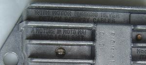

PostPosted: Fri May 15, 2020 4:08 pm    Post subject: Is there any reason to have a separate battery and alt swit Reply with quote
Le 15/05/2020 à 23:33, William Daniell a écrit :
Will,
There is a law in physics measurements : the more parameters you measure, the more you scratch your head^^!
That said, you wrote that your bus - or battery - voltage remained within the "green" limits during each of the events. So no reason to suspect the voltage regulator.
The only item capable of supplying more than the 21 amps of the alternator is the battery, but while doing this its voltage would sag due to internal resistance (Cf Ohm's law for a generator). 70 amp is no trifle.
So the main probabilty is an ammeter artefact. The best way to measure currents is with a Hall effect sensor, as the shunt may induce side effects in your circuits with high currents.
But first things first, without independent and reliable voltage and possibly current measurements or logging, no assumptions can be made.
Concerning disconnecting the battery while running, not sure it would be a safe thing to do, especially in flight :
