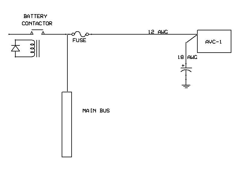

PostPosted: Sun Feb 14, 2021 5:44 pm    Post subject: DC Wiring Diagrams for SPA Panther LS Reply with quote
Hello everyone,
I created DC wiring diagrams for my Panther LS in Solidworks.
EAA offers this 2D/3D cad program free for members. It is very easy to use and fairly intuitive.
I based my electrical design on the Aeroelectric drawing files and B&C electric products. I don't mind sending these drawings out to use as a starting point in your own electrical designs. DM me for your preferred drawing format. .pdfs, .slddrw or .dwg formats.
Notes:
Based on the Aeroelectric Connection Handbook and drawing Z09A.
The ignition and fuel systems are for a Corvair with Dual Ignition.
The voltage Regulator is the new B&C Electric AVC-1. It features three functions in one and is Aircraft purpose built v the JohnDeere or Ford types of VR's.
Scheme uses GRT Avionics as primary EFIS and MGL Avionics as a backup.
Basic Day/Night VFR scheme. The lighting is FLYLEDS.
The drawings are my draft design. I have not wired my airplane yet. They are not 100% the final scheme.
Here are my concerns:
1. I chose to utilize relays to operate many of the devices that are on toggle switches (as long as the relay didn't draw more current than the actual devices). I can operate the devices by toggle switch without the intermediate relays, but wanted to see what everyone thought about how the S704-1 Relay is used in my schemes.
2. Inputs to the EIS device where the 4.8V excitation outputs are used to drive the sensors (oil, temp. pressure) and the way they are wired electrically for each circuit. Specifically how the Resistors are in series and parallel.
3. Use of flyback diodes on the relay coils and contactors, and the unidirectional diodes on the LED lighting circuits.  Are they wired in the correct direction (anode and cathode)?
4. Headset mic and headphone jacks. Curious if I have these wired correctly.
Thanks and many kind regards,
Rick Gamble
SPA Panther LS - under construction

PostPosted: Sun Feb 14, 2021 9:24 pm    Post subject: DC Wiring Diagrams for SPA Panther LS Reply with quote
Hey Rick,
Nice drawings!
Regarding Relays:
Relays can be used for all sorts of things. Two of the most common uses are:
1. To use a small current to control a big current
2. To implement special switching logic (like your trim control)
It looks like several of the things you are controlling with relays are pretty low current (less than 10 amp) so putting a relay in the circuit is superfluous. Those relays just add complexity, parts count, number of terminations, weight, etc without adding any real value. You'd be better-off using switches directly for the fuel pumps & auto pilot and probably the avionics relay (also consider that a single avionics switch is a possible single point of failure).
That's what I saw with a quick glance at your drawings. I did not study them.
-Jeff

PostPosted: Sun Feb 14, 2021 10:16 pm    Post subject: DC Wiring Diagrams for SPA Panther LS Reply with quote
What advantage is secured by doing this? It
adds weight and complexity. Why an 'avionics
switch'? It too adds complexity and offers
single point of failure for all avionics.
A Boeing 787 doesn't have one . . . they
were slightly useful in 1965 but totally
worthless by 1980.
Are these resistors required per manufacturer's installation
instructions? There are better ways to 'package' these.
Threaded fastener terminal strips are kind of a
last resort.
out of that stuff?"
user9253
Joined: 28 Mar 2008
Posts: 1978
Location: Riley TWP Michigan
PostPosted: Mon Feb 15, 2021 7:24 am    Post subject: Re: DC Wiring Diagrams for SPA Panther LS Reply with quote
The symbol for a 1N4005 has a straight line. The symbol on your drawing is for a zener diode.
The 1N4005 diode in series with the low voltage warning light is backwards and will prevent illumination.
What is the purpose of those diodes in series with warning lights?
If those warning lights are LEDs, then they need series resistors unless they are already inside of the warning lights.
Like others have said, get rid of the avionics switch and relay. They serve no useful purpose.
Connect avionics to the main power bus.
Remove that fuse between the battery contactor and the main power bus.
If it blows, everything goes dark. There is a reason that fuse is not on Bob's drawings.
The same applies to the battery bus fuse. Either eliminate it or increase its size to 60 amps.
The electrical system needs to be protected from a shorted alternator "B" lead.
That fuse should be located at the battery contactor end of the B lead.
Consider what will happen if the battery contactor fails open shortly after takeoff.
You will not know it because everything on the main bus keeps working, powered by the alternator.
The engine keeps running off from the battery until the battery goes dead. Then it quits, but you won't know why.
To prevent that scenario, connect the secondary fuel pump and secondary ignition to the main power bus.
Consider using Bob's Z-101
http://www.aeroelectric.com/PPS/Adobe_Architecture_Pdfs/Z101B.pdf
Notice that in Z-101B, neither the main power bus nor the battery bus are protected by a fuse.
The engine bus in Z-101B has two power sources: the battery and the alternator.
It probably doesn't matter, but the part numbers for the fuel-level-sender resistors indicate 475ohms, not 470.
If you use a terminal strip, do not depend on the screw to make the electrical connection.
Put the 2 or 3 wires into one ring terminal and solder or crimp. Then put the ring terminal under the screw.
A loose screw will not affect the connection. Use blue Loctite on screw threads.

PostPosted: Mon Feb 15, 2021 7:35 am    Post subject: DC Wiring Diagrams for SPA Panther LS Reply with quote
To all,
Thank you for your feedback!
1. I am pleased I asked about the relays in the design and am determined on removing many of them as suggested. (I was zealous to design with relays everywhere!)
2. Bob, are you saying the Avionics master switch is a feature that adds a point of failure and not normally used?
3. The resistors are per the manufacturer's requirements.  How can they be packaged other than a screw terminal with ring tongue terminals on the resistor ends? The resistors must be included in most other designs I assume however there are not many installation examples upon researching the internet.
Best Regards,
Rick

PostPosted: Mon Feb 15, 2021 11:08 am    Post subject: DC Wiring Diagrams for SPA Panther LS Reply with quote
Dear Joe and Group,
Again, excellent feedback I hoped for! I indicated my responses beginning with the >.
Please advise any more thoughts you may have about this design.
You are correct I drew a Zener with the angled tips.
I thought it was backward, it may have been overthought by me!  I looked at the diode connections as the anode side connected to the bus and the cathode side connected to the device side and this output is internal to the device and acting like an internal ground to complete the circuit. The action I will take is to delete these diodes as this will be a far more dependable design.
I was thinking of isolating any 12VDC at effectively 5VDC outputs.
The Warning lights are not LED. They are incandescent from B&C.  Do I still need the series resistors?  For the voltage regulator warning lamp diode I agree it's backward, but I intend on removing this diode.
The AVC-1 manual says the following on page A-2: Note when active this output pulls to ground; when not active, it is pulled up from a diode-isolated internal pullup to 8.5V. It will support up to 100ma continuous load and is intended to ground an annunciator light (incan or LED), or be used as an output to feed an aircraft EFIS or other similar display.

You are correct that B&C shows a fuse between the battery contactor and the main power bus.
But thousands of airplanes are flying without that fuse. Bob N does not recommend it.
Do a good job installing the main power bus feeder to be sure that it will not short out,
especially where it goes through the firewall. Then that fuse is not needed.
B&C also shows a fuse at the battery contactor end of the regulator "B" lead. That one IS needed.
On your drawing, there is fuse on the right side of the battery contactor. Rotate that fuse 90 degrees CCW.
Then interchange the wire going to the regulator with the one going to the main power bus.
See attached picture.
I do not know about the contactor mounting. Follow the manufacturer's recommendation.
Fusible links are more robust than fuses. But either will work if installed correctly using the proper size.
 Filesize:  13.08 KB
 Viewed:  10529 Time(s)
