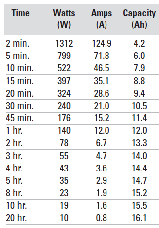

In the attached chart you can see how a battery
rated at 18Ah under a 20Hr discharge rate
delivers only 12Ah if discharge over 1Hr rate.
2/3rds of its capacity is tossed off as internal
heating of the battery.

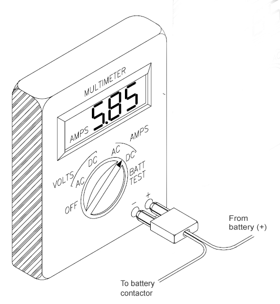

You can easily measure plan-b loads by inserting
an ammeter in series with your battery lead and
turning on the plan-b compliment of electro-
whizzies. This is a good thing to do to verify
your load analysis values.

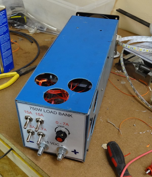

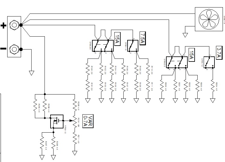

This bucket-o-resistors technique is
very versatile. For example, a couple
years ago I crafted a portable, 750
watt, variable load bank for the purpose
of airborne cooling tests on alternators.
An array of 21 resistors not unlike the
ones I suggested plus a handful of components
and a fan made for a device that would
offer loads from 0 to approx 50A fan
cooled.
I've used this technique to craft load banks
up to 2800 watts (28v, 100A) . . . with
a lot more resistors and a bigger fan . . .
but knob-adjusted at the control panel.
 Filesize:  140.7 KB
 Viewed:  14080 Time(s)
 Filesize:  62.41 KB
