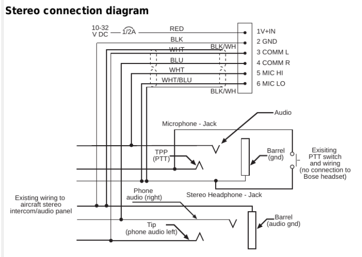

I am still trying to find out what color wire connects to the phone jack lugs of the Bose A20 “GA wire harness”…
From the recommendations you gave from my last post on this subject I tried to do a continuity check of the wires to the phone plug so as to determine what color wires went to the jack lugs however the wires were broken inside. I then tried to dig out the plastic molded on cable end and trace the wire colors to the plug however as the molded on plastic was removed it pulled off the colored insulation from the wires so now I…and my headset…are dead in the water because I do not know what wire is supposed to go where.
So I need to know what color wires (red/black/white/blue/green) are supposed to be soldered on to the replacement Neutrik NP3X plug’s three lugs (tip/center/ring) and
If you can help I would be greatly appreciative since Bose wants 300 bucks for a replacement cable.

Red (positive) and black (ground) will almost certainly be power to the headset electronics. White, blue and green are probably left, right and ground for audio. The correlation of those colors is anyone's guess, but they're easy to figure out.
You may be able to determine audio ground by a continuity check with power ground (black). Left and right are easily determined by experimentation with a 1.5V AA or AAA battery (do NOT use a 9V!).  Put the headset on, then hold one wire on the "-" pole of the battery and tap another wire on the "+" pole. You'll hear a scratching noise in the ear that's fed by that wire.

Whilst doing my research on how to replace the phone plug on my Bose A20 headset, I ran across an article by Matt Dralle who modified a Bose A20 headset to make it to automatically turn on. In the article he took the Bose electronics all apart and did the modification…and he was able to put it all back together again so I figure that he must be pretty smart and he would be the guy to know what color wires to solder to the headphone plug for my replacement Neutrix NP3X plug.
Does anyone out there know how to get a hold of Matt and can you please ask him the question:
What color wires (red/black/white/blue/green) are supposed to be soldered on to the replacement Neutrik NP3X plug’s three lugs (tip/center/ring)?

ceengland7(at)gmail.com
PostPosted: Fri Apr 24, 2020 10:16 am    Post subject: Bose Headset Replacement Plug Reply with quote
Bill,
Did you see my post on how to ID the leads using a 1 1/2 Volt flashlight battery?

PostPosted: Fri Apr 24, 2020 3:19 pm    Post subject: Bose Headset Replacement Plug Reply with quote
Sorry not when you initially posted it…just read it now.
Would it be safe to assume that the black wire is the ground? I am so close I do not want try fry anything.
I was hoping to find someone on this forum who has done this repair and knew the exact colors to place where. I was really surprised that the phone plug had 5 wires as I just assumed that it would have only three.

To cover all bases, you can power up the headset and check all combinations of wire pairs for *voltage* before doing anything else. Black is *likely* to be ground/common, but you just need to check for yourself.
I agree that it's odd to have 5 wires going to a 3 terminal plug, but maybe they just used the same cable for everything, & didn't hook up the extra conductors in the cable for the phones plug. I've seen similar stuff in things like USB and serial cables.
Does (did...) the headset work in non-noise-cancelling mode if the batteries are dead or removed? If so, you could do the battery trick even without it being powered up.
Another option, if you haven't tried it yet, is to take an exacto knife to the old plug. Cut along the molded housing (not across) a little depth at a time, trying to peel it away from the conductors before going a little deeper. You might be able to get past the broken spot in the wires so you can check wire colors with an ohm meter. I've had good luck doing this with molded connectors on other products.
Yes it did so I will try that first.
That is how I screwed it up. I tried to slowly cut down and peel the plastic back however that plastic was molded on very tight and as I peeled away the wire insulation came off and all I found was three wire conductors connected to the three rings of the plug.

PostPosted: Sat Apr 25, 2020 9:50 am    Post subject: Bose Headset Replacement Plug Reply with quote
Still striking out on my headset plug replacement…cant believe this is so dang complicated…
I did as Charlie recommended, I stripped all six wire ends and used a 1.5 volt battery to see if I could hear the headset speakers click hoping to find the mystery three wires.

on the manual page 32:
[img]cid:part1.6EC10994.0D8337C8(at)gmx.net[/img]
