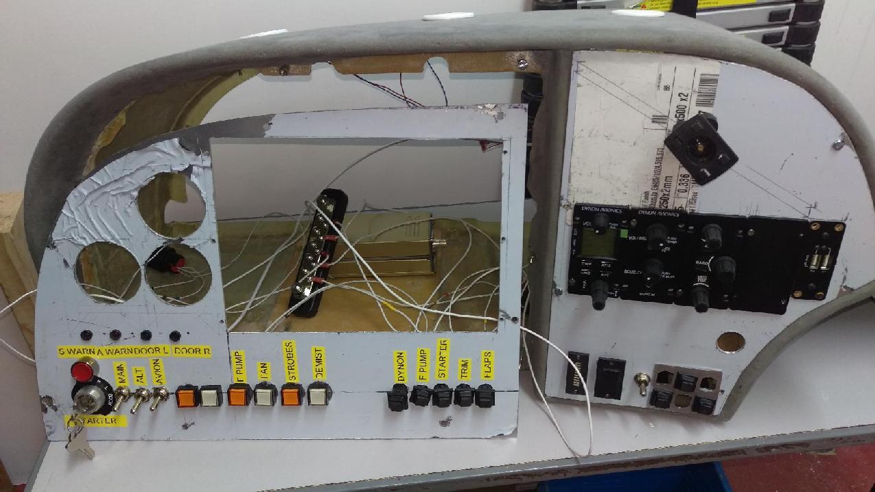

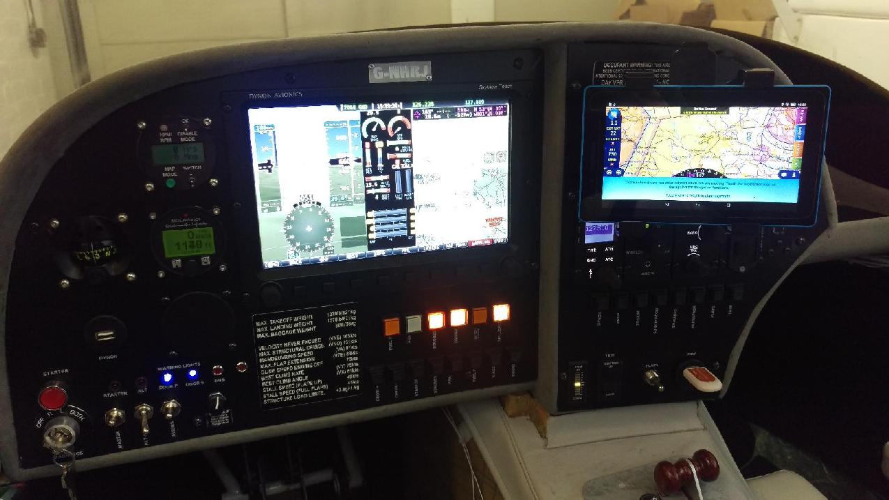

Whilst building, like you, I considered some of the MODS to dampen the vibrations of the Control Panel. However, I decide to follow the instructions from the original build manual, and I am glad that I did, as I have never noticed a problem in the couple of years my aircraft has been flying. Obviously some pilots have had a problem (hence the MODS), but it has been my experience that it is best to build the aircraft as designed, only making changes when experience has proved them necessary.
I have attached a couple of pictures of my panel, one showing the attachment points during the build, and one of the finished article.
