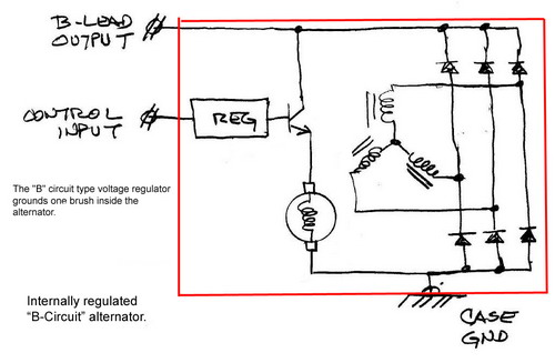

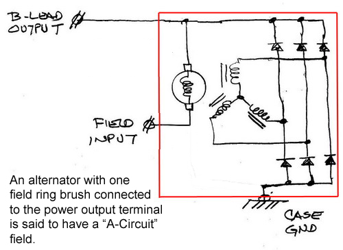

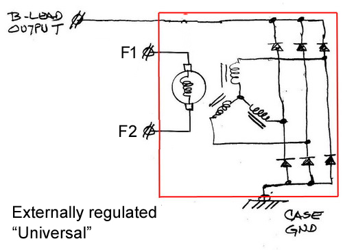

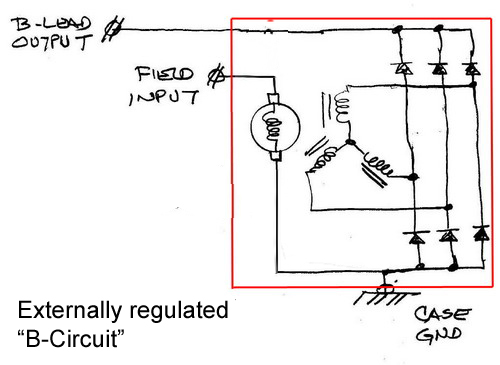

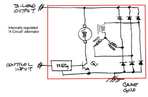

The terms "A-circuit" and "B-circuit" are holdovers from
the days of wound field DC generators. The terms were adopted
to define how voltage applied to the field terminal from
outside affected the output. They've migrated into modern
'alternator speak'.
The terms A and B-Circuit are applicable whether the
alternator is internally or externally regulated.
A fifth configuration is always externally regulated
because BOTH field leads are brought out.
The attached images describe 5 variations of alternator
field wiring:
 Filesize:  79.21 KB
 Viewed:  5365 Time(s)
 Filesize:  70.16 KB
 Filesize:  68.15 KB
 Filesize:  45.85 KB
 Filesize:  47.67 KB

For the new guys, the 'internal regulator A-Circuit' is what you're likely to see in a Nippon Denso (ND) IR alternator.
Q1 in the drawing is, effectively, what keeps us from having positive control via the 'control input'. If Q1 shorts collector to emitter, *or*, if anything inside the regulator block fails and applies full DC voltage to the base of Q1, the alternator 'runs away' in an OV event. I tried repeatedly to explain this to one of the VAF forum members who is quite active in the electronic section of the forum and is supposed to be very knowledgeable, but he adamantly insists that he has full control over his ND alternator via the control terminal. (Even after posting an ND block diagram showing exactly what Bob just showed us.)
I know that at least a few of us monitor both this list and the VAF RV forum. If you're new to electrical/electronic stuff, be very careful about trusting the E/E stuff you read on VAF. Odds of getting correct info over there are closer to a dice roll than a coin flip.

Are the typical ND IR alternators of the Internal Regulator A-Circuit type with the control input simply bonded to the B-lead? If so, then the mod I've performed with the non-conductive screw (in the other thread on Alternator Mods) only gives control in "normal" ops and does not protect from a failed regulator, meaning a b-lead disconnect would still be required. Correct?
