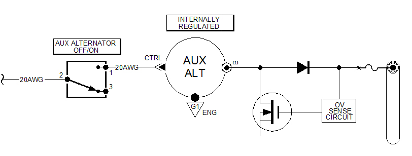

Figure Z24 has been a burr under my intellectual saddle
for over 20 years. It was a rather crude band-aid for
adding ov protection to an internally regulated alternator
where we, as system integrators, had no absolute control
over field excitation voltage of the alternator. This
produces failure modes initiating an uncontrollable
alternator runaway.

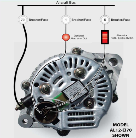

B&C's offerings to the OBAM aviation market exploited
the fine craftsmanship of some automotive alternators
by modifying them to accept field excitation from
an external controller. Plane-Power took a slightly
different approach . . . their first offerings retained
the built in regulator but included modifications to
(1) bring field excitation lead out of the alternator
and (2) add crowbar ov protection to that field power
feeder. You can see the crowbar ovm module piggy-backed
onto a P-P alternator in the attached photo.
The common theme for these offerings is MODIFICATION
of an off-the-shelf alternator to effect smooth integration
of the alternator into legacy aircraft system architectures.

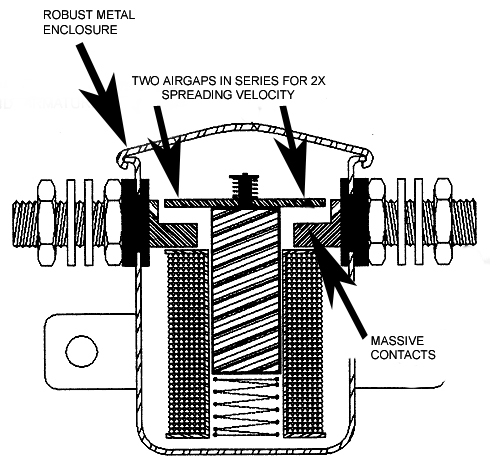

Selection of the disconnect relay is a
bit more problematic than routine
control tasks in the rest of the system.
Our relay must survive a break of this
rapidly rising, robust current source.
Spectacular arcing will most certainly
establish in the gap of spreading contacts.
The relay of choice should have thermally
massive contacts . . . and preferably
be of the double make-break variety.
Further, it the fire doesn't go out,
it's a pretty good idea to pick an
enclosure likely to contain the effects.
The other attached figure speaks to features
in the legacy 'whisky barrel' contactors.
There are two contacts in series for
2x the spreading velocity of a 'relay'.
The contacts are thermally massive
to help conduct heat out of the arc as
the contacts spread. The enclosure is
likely to contain any electrical conflagration
that fails to extinguish.
The short answer to your question is: That
contactor was selected for reasons beyond
the device's ratings. Substitutions are
not recommended.

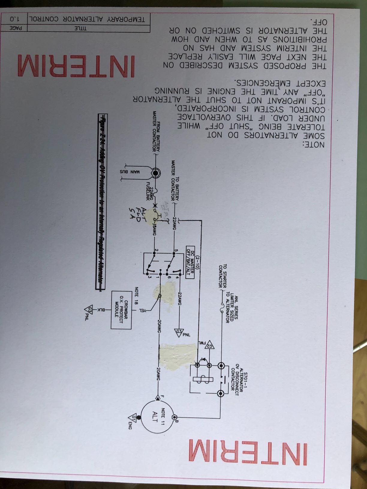

The elegant answer suggests you modify
your alternator to ground one brush and
bring the other one out to a generic
'ford' regulator as depicted in Z101.
It's not a difficult mod. Best yet, it
reduces energy release in an ov event
to a tiny fraction of that produced by
a b-lead disconnect. No arcs, no flame,
just a little 'click' as the field
breaker opens. No hardware in the alternator
b-lead.

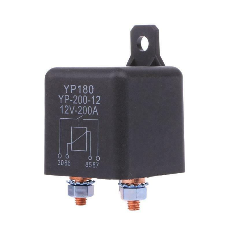

johnbright
Joined: 14 Dec 2011
Posts: 167
Location: Newport News, VA
PostPosted: Tue Apr 21, 2020 6:18 am    Post subject: Re: OV B-lead Relay Reply with quote
bobnoffs wrote:
... yp180, yp-100-12 and 12v-200a are printed on the unit...
https://www.ebay.com/c/20012698760
 Filesize:  28.14 KB
 Viewed:  16852 Time(s)

PostPosted: Tue Apr 21, 2020 8:01 am    Post subject: OV B-lead Relay Reply with quote
At 09:18 AM 4/21/2020, you wrote:
--> AeroElectric-List message posted by: "johnbright" <john_s_bright(at)yahoo.com>
Yeah, this is the one I did a tear-down on
but for the life of me, I can't find the
pictures in the archive. I'm skeptical of
the 200A rating and to be sure, the single
break contact gap is unsuitable for a
b-lead disconnect.

I have a design proposal on the hard drive
that takes a little different approach
to b-lead management of an ov condition.
This approach drive the bus through a
diode capable of carrying full alternator
output. Instead of attempting to BREAK
the b-lead, I simply short it to ground
with a fat FET. In a mater of microseconds,
b-lead voltage is reduced to millivolts.
Since the field is sourced from the b-lead,
the runaway alternator is simultaneously
deprived of field excitation. The whole
thing simply relaxes. The cited diode
prevents reflection of the crowbar
on the rest of the airplane.
Intuitively, this has to work. Best
yet, it would prevent the alternator's
suicide attempt.
I didn't push this idea forward . . . it
seemed like a lot of monkey-motion to
avoid the simple mod to run the
alternator with an external regulator.
If anyone would like to explore the b-lead,
crowbar method for bringing an internally
regulated alternator to heel, I'll publish
the sketches.

thoughts? Dan
P.S. did this "old school" with whiteout and a pencil, excuse the messiness...

On 4/21/2020 12:52 PM, Robert L. Nuckolls, III wrote:
� This approach drive the bus through a
� diode capable of carrying full alternator
� output. Instead of attempting to BREAK
� the b-lead, I simply short it to ground
� with a fat FET. In a mater of microseconds,
� b-lead voltage is reduced to millivolts.
� Since the field is sourced from the b-lead,
� the runaway alternator is simultaneously
� deprived of field excitation. The whole
� thing simply relaxes.
Is it possible that some car alternators have built-in filtering
(capacitor) in the internal regulator that would extend microseconds to
milliseconds or more?
Looking at the output windings as a coil, wouldn't shorting them result
in a huge spike destroying the rectifier diodes or would all the energy
stored in the coil be dissipated as heat?
Shorting B+ to ground would put the rectifier diodes in the shorted
path. Any chance that the rectifier diodes would be destroyed?
Finn
PostPosted: Tue Apr 21, 2020 4:24 pm    Post subject: OV B-lead Relay Reply with quote
Is it possible that some car alternators have built-in filtering (capacitor) in the internal regulator that would extend microseconds to milliseconds or more?
Looking at the output windings as a coil, wouldn't shorting them result in a huge spike destroying the rectifier diodes or would all the energy stored in the coil be dissipated as heat?
Shorting B+ to ground would put the rectifier diodes in the shorted path. Any chance that the rectifier diodes would be destroyed?
No, no and no. The alternator is simply modeled
as a current limited source of power the magnitude
of which can be controlled by adjustment to
input RPM and field current.
Whether you tax the alternator at nameplate ratings
in a normal energy production mode -OR- throw
a dead short across the b-lead . . . the current
that will flow in the alternator's output hardware
will be the same . . . at or slightly above nameplate
rating of the alternator.
Unlike a really fat capacitor or a battery, the
b-lead fault current is limited by the alternator's
magnetics.
Even if the field were continuously excited a
dead short on the b-lead would only produce a
STEADY current flow at or above nameplate ratings.
That condition WOULD continue to warm the diodes
and stator windings as if the machine were producing
useful power. Given that the field on an internally
regulated alternator is SUPPLIED from the b-lead,
hitting the b-lead with a short not only shunts
a nominal current source to ground, it deprives
the alternator of it's field excitation. The
current that flows would be very short and things
would settle down to what ever current is generated
by residual field flux. The whole thing is brought
gracefully to a low energy state.
That's an interesting bench experiment I'm
planning to conduct . . . I've attached
a sketch of what the system would look like.
The series diode would drop the alternator
output by a volt or so . . . no big deal.
Everything on the panel is lit up. This
'crowbar' needs to use a really low resistance
FET (easy to get). If you used an SCR to
effect the short, the SCR still drops about
a volt in the on-state. 1 volt on an ND
alternator at 10,000 rpm will generate a LOT
of snort.
Our short needs to take the b-lead down to
millivolt levels and hold it there.
But given the ease with which the alternator
can be modified into a real 'aircraft'
part, any notions of a Z24 update are not
so interesting.
