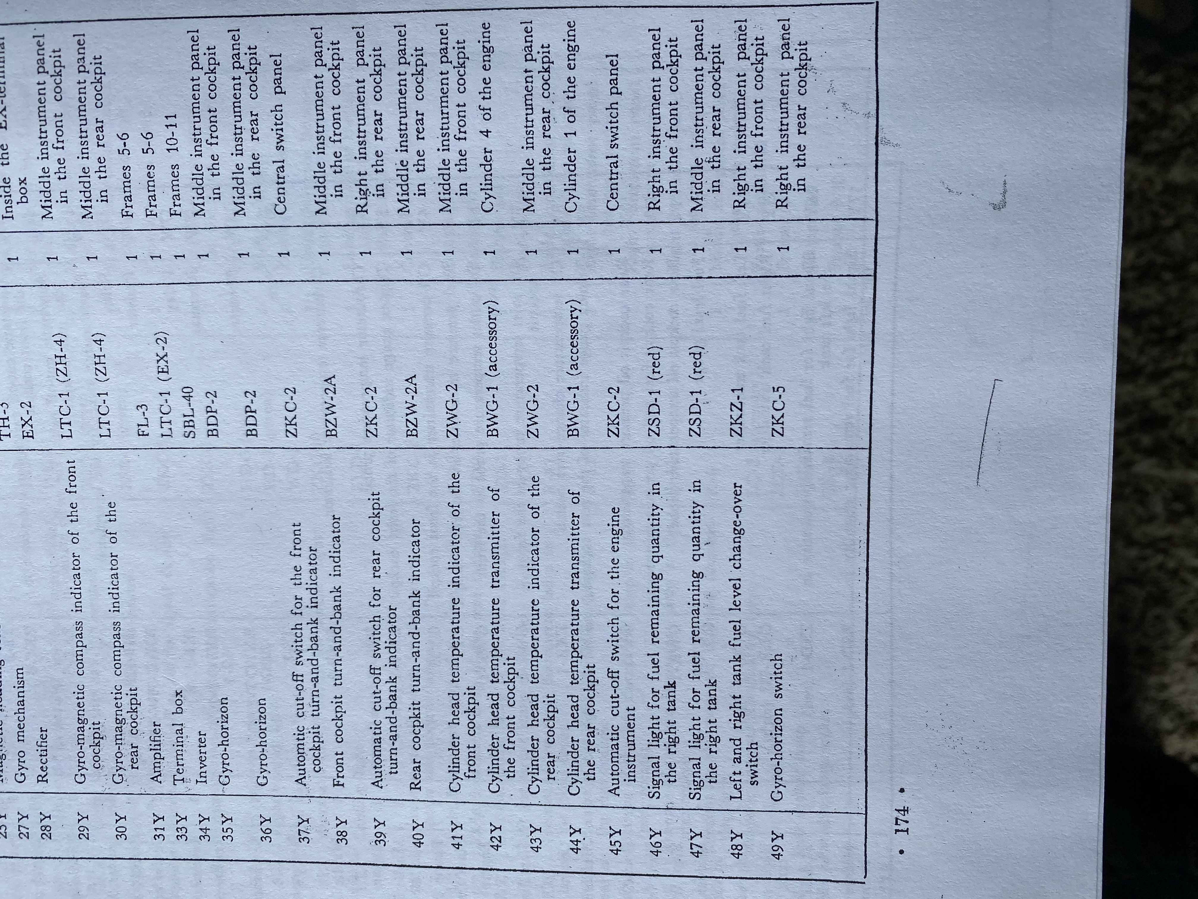

[img]cid:172cdc8b7dcccd417661[/img]
I am at the hangar with the tech manual for the Housai.
You are correct as usual.  It is cylinders 1 and 4.
And Cylinder 4 goes to the front cockpit.
I have attached a photo of the page in the manual.
Start reading at code 41Y.   42Y talks about front cockpit.  #4 cylinder.
Thanks Walt
Mark Pennington
On Fri, Jun 19, 2020 at 1:47 PM Walter Lannon <wlannon(at)shaw.ca (wlannon(at)shaw.ca)> wrote:
I can confirm that #1 and #4 rear spark plugs are the correct location for the CHT sensors.
These are the two hottest cylinders.  There is manual information that identifies those and to which cockpit but I have no time right now to dig it up.

PostPosted: Fri Jun 19, 2020 2:08 pm    Post subject: Cylinder Head Temperature Gages Reply with quote
Ok. At least I got everything connected to to the correct cylinders. 1&4. Now just following wire or swapping gages (rear to Front) to see if the problem follows. Y'all are great thanks a billion.

pennington.construction.i
PostPosted: Fri Jun 19, 2020 8:49 pm    Post subject: Cylinder Head Temperature Gages Reply with quote
Dennis.
We have this cleared up for the Housai.
Is it the same for M14P.   Cylinders 1 and 4.   Number 4 for the front cockpit ?

<IMG_3892.jpg>

Thanks again Walt for the verification on where the temp pickups are located on  which sparkplugs. Swapping gages after a wire check will be next.

FWIW.
M14PF 700mm/70% 5000'AMSL 140kts IAS winter over Oz
Sean Trestrail
ttail[at]internode.on.net
