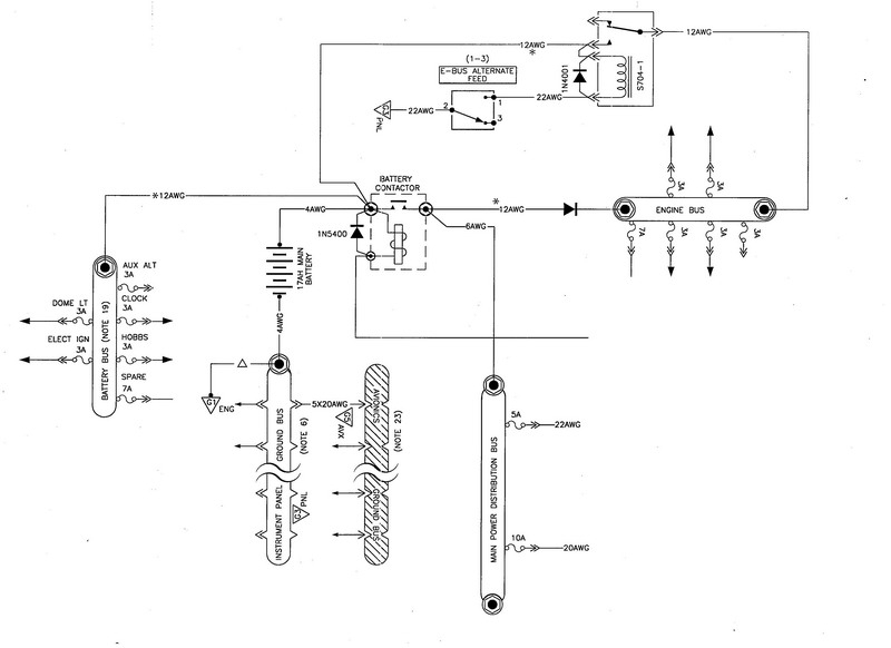

The usefulness of an endurance bus went
away with Z-12. Went you have two, robust
engine driven power sources the likelihood
of finding it necessary to complete a mission
battery-only becomes one of those 10 to the
minus bazillion risks.
However, if one wishes to honor both (1) legacy
crash safety goal of hitting the dirt with electrics
max cold and (2) independent feeds for the engine,
perhaps the E-Bus finds a new role in Z12 thusly:
[img]cid:.0[/img]
I think this comes close to some alternatives
offered by others in recent days . . .
The reduced reliability of the added relay and wiring
is not a big concern because it's the 'backup'
system. Further, it's easily checked for operability
in pre-flight. Anytime the MAIN bus is up, the ENGINE
bus is up. Finally, the main bus can be taken down
without killing the engine. The normal feed path
to the ENGINE bus has low parts count, no moving
parts and high reliability factor.
Let's thrash this around with a goal of offering
a failure-tolerant energy source to a electrically
dependent engine of any variety.
I noticed that one SDS drawing I've looked at
recently had 5A or smaller fuses for ALL feeders
to their system. Really cool . . .

PostPosted: Thu Feb 20, 2020 11:59 am    Post subject: New role for the E-Bus? Reply with quote
[img]cid:.0[/img]
P.S.
Speaking of pre-flight, this arrangement
would call for going to alternate feed
and opening the master switch after engine
start . . . of course this would reboot
electro-whizzies on the main bus.
 Filesize:  98.64 KB
 Viewed:  22063 Time(s)

PostPosted: Thu Feb 20, 2020 12:41 pm    Post subject: Re: New role for the E-Bus? Reply with quote
Proposed SDS EFI+I engine bus preflight:
    Close engine bus alternate feed relay from ship's battery.
    Energize both fuel pumps.
    Read battery voltage on SDS programmer.
      Engine bus alternate feed has now been tested at 10 to 11 amps and if main bus did not power on the diode is not shorted.
    Close battery contactor.
    Open engine bus alternate feed.
      If engine bus is still powered, diode is not open.
    Close engine bus alternate feed relay.
John Bright, RV-6A
Single battery, wound-field alternator on main bus, MZ-30 PM generator on engine/essential bus.

PostPosted: Thu Feb 20, 2020 1:17 pm    Post subject: New role for the E-Bus? Reply with quote
At 02:41 PM 2/20/2020, you wrote:
--> AeroElectric-List message posted by: "johnbright" <john_s_bright(at)yahoo.com>
Sounds like a plan . . .

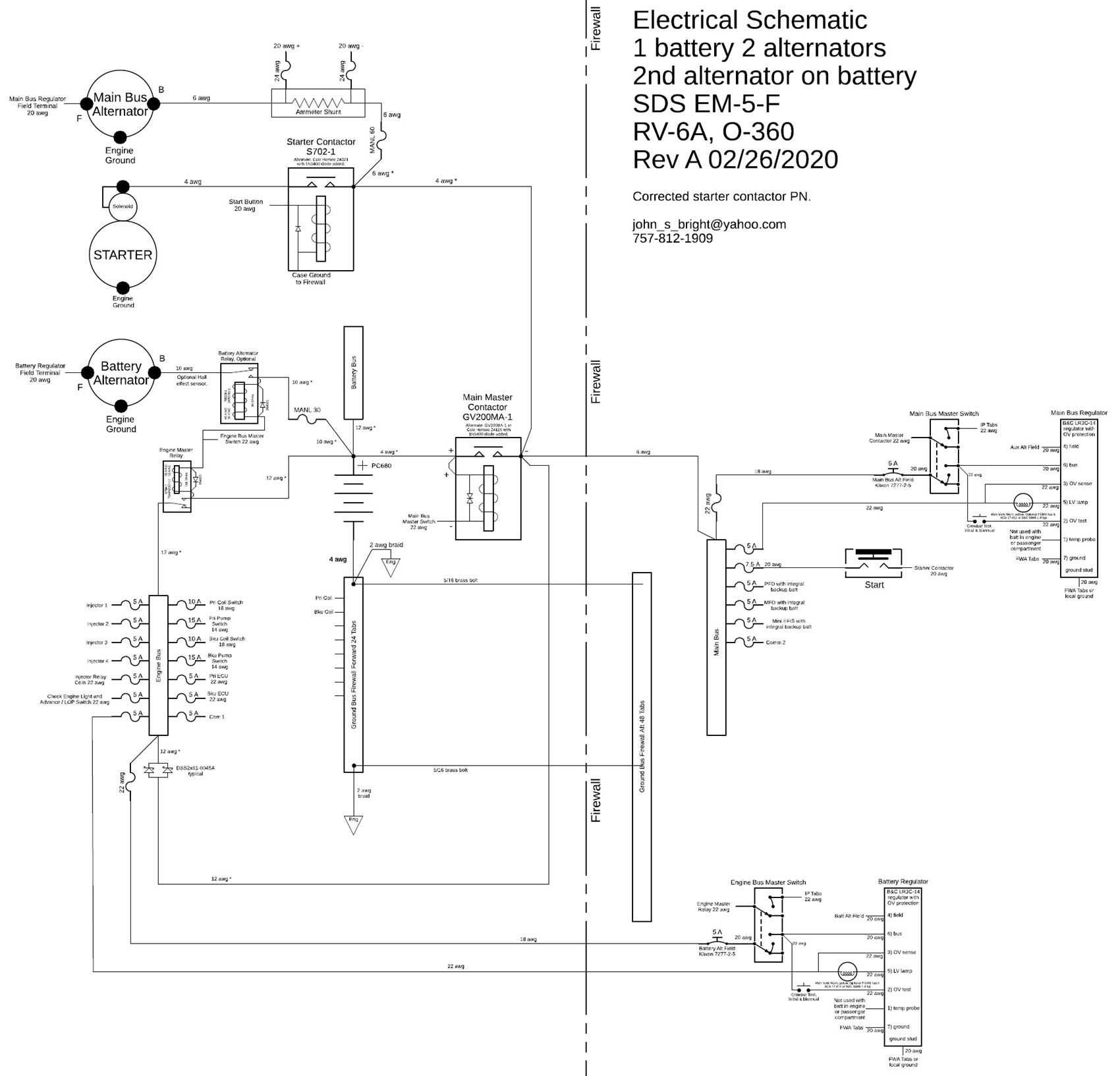

PostPosted: Thu Feb 20, 2020 5:17 pm    Post subject: Re: New role for the E-Bus? Reply with quote
Hi Bob,
I would love to see that drawing because SDS recommends 10 A fuses for coilpacks and 15 A fuses for fuel pumps. The Walbro data sheet for the fuel pump shows 5.25 A per pump at 45 psi which is the SDS recommended pressure. SDS says the four cylinder coilpacks draw "just over 1 amp each in cruise at 2,400 rpm".
How about connecting the aux alternator to the battery?
 Filesize:  251.37 KB
 Viewed:  22231 Time(s)

John Bright,
I suggest that the engine bus relay coil be connected to the relay common terminal instead of the relay normally open terminal.
In other words, the relay coil should be powered by the battery, not by the main power bus.
Thanks Joe!... Silly error on my part. I fixed it.

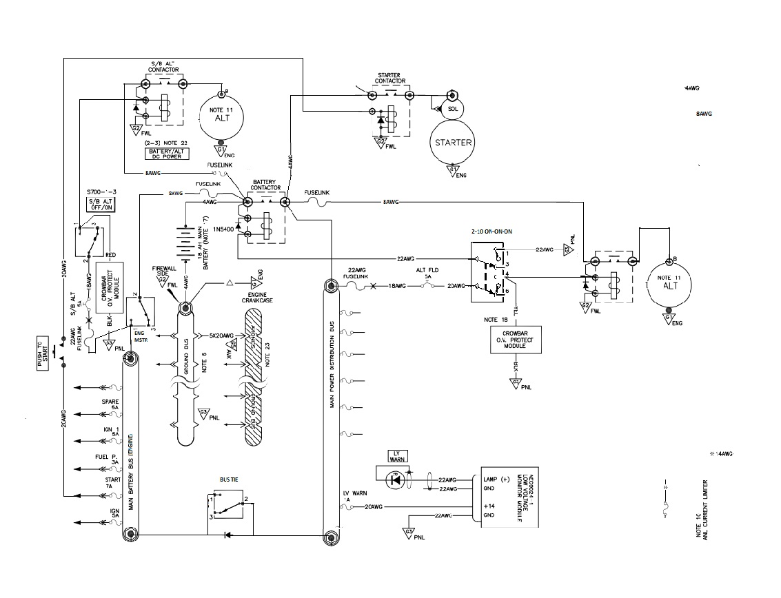

PostPosted: Fri Feb 21, 2020 10:51 am    Post subject: New role for the E-Bus? Reply with quote
Hi Bob,
Let me see if I can dig that up again . . . I don't
know if I saved it after discovery a ten or so
days ago when we started this thread.
In order to meet FAR 23.1361 I add relays for the pumps and coils at the engine bus.
How about configuring the engine bus as
shown in.
http://www.aeroelectric.com/PPS/Adobe_Architecture_Pdfs/Z01P2-Preliminary.pdf
Now you can run all engine loads through
separate protection and panel mounted switches
while still complying with the max-cold-
during-worst-landings design goal. No
at-the-bus disconnection necessary.
How about connecting the aux alternator directly to the battery?
The reason for doing that in Z13/8 was to bypass
the battery contactor thus eliminating that parasitic
load during main-alt-out operations. Given that
we're not offered a much more robust (30A) pad-driven
alternator, such frugality is no longer useful. Hence,
the Z13/8 architecture gives way to Z-12. Simpler
and even holy-watered by the FAA!
I've been gathering some of our thoughts over recent
months into a proposed new Z-figure to replace
Z13 and Z12.

Unfortunately, I haven't been able to see the diagram you posted on this (I get the "emacs" on the digest instead of a link). That said, it sounds like what you're proposing would look an awful lot like the Z13/20 diagram that you toyed with several years back. Would it provide the architecture we're looking for in this?
That one is already outdated. Go here
https://tinyurl.com/ukper7j

Hi Bob,
RE: the FAR23 issue, I was referring to a drawing posted earlier that had multiple relays fed from a bus which itself was already controlled. Most of the loads could have been handled easily by switches.
To separating the alternator feed-in locations:
Is my thinking incorrect about having both alternators controlled by and fed to the main bus? It seems that shutting off the master would also shut off both alternators. To solve that....
Attached is my MS Paint-abused rough draft, using cut/paste from an Aeroelectric drawing.
Both alts are internally regulated in this drawing (yeah, I know that you're not a fan, but it's ~$150 vs ~$1000, and I won't be randomly flipping alt switches in flight).
All engine related components, and one alternator, are fed from/controlled by the (badly labeled) 'Main Battery Bus (Engine)'. The correct name would be simply 'Engine Bus'.
Everything else, including the other alternator, is fed by the Main bus.
As I said, this is very rough; any labels beyond the basic battery, buses, alternators, and switching are 'artifacts' of the cannibalized original drawing.
Charlie

Charlie,
There is no reason to have the start push button connected to the engine bus.
The master contactor must be closed to crank the engine. So the start button
might as well be connected to the main power bus.
If the bus tie switch happens to be closed while starting the engine, then
starter current will flow through that switch. If you must have that switch,
then use a DPDT switch with half of the switch in series with the start push button.
Wire the DPDT switch so that when the bus tie is closed, the starter is disabled.
Joe Gores

Hi Joe,
As I said in the reply to Bob, most of the loads in the drawing are
'artifacts' of copy/paste operations from a basic AEC drawing to my
Paint program. The only items of significance for our discussion at the
moment are the two alternators and the way they connect to the system,
vs connecting both to the main bus as shown in other AEC drawings.
I'll ponder the bus tie issue. The reason it's there is a convenient way
to get alternator/battery to the main bus if there's a failure in the
master control path causing the master contactor to open.
Charlie
