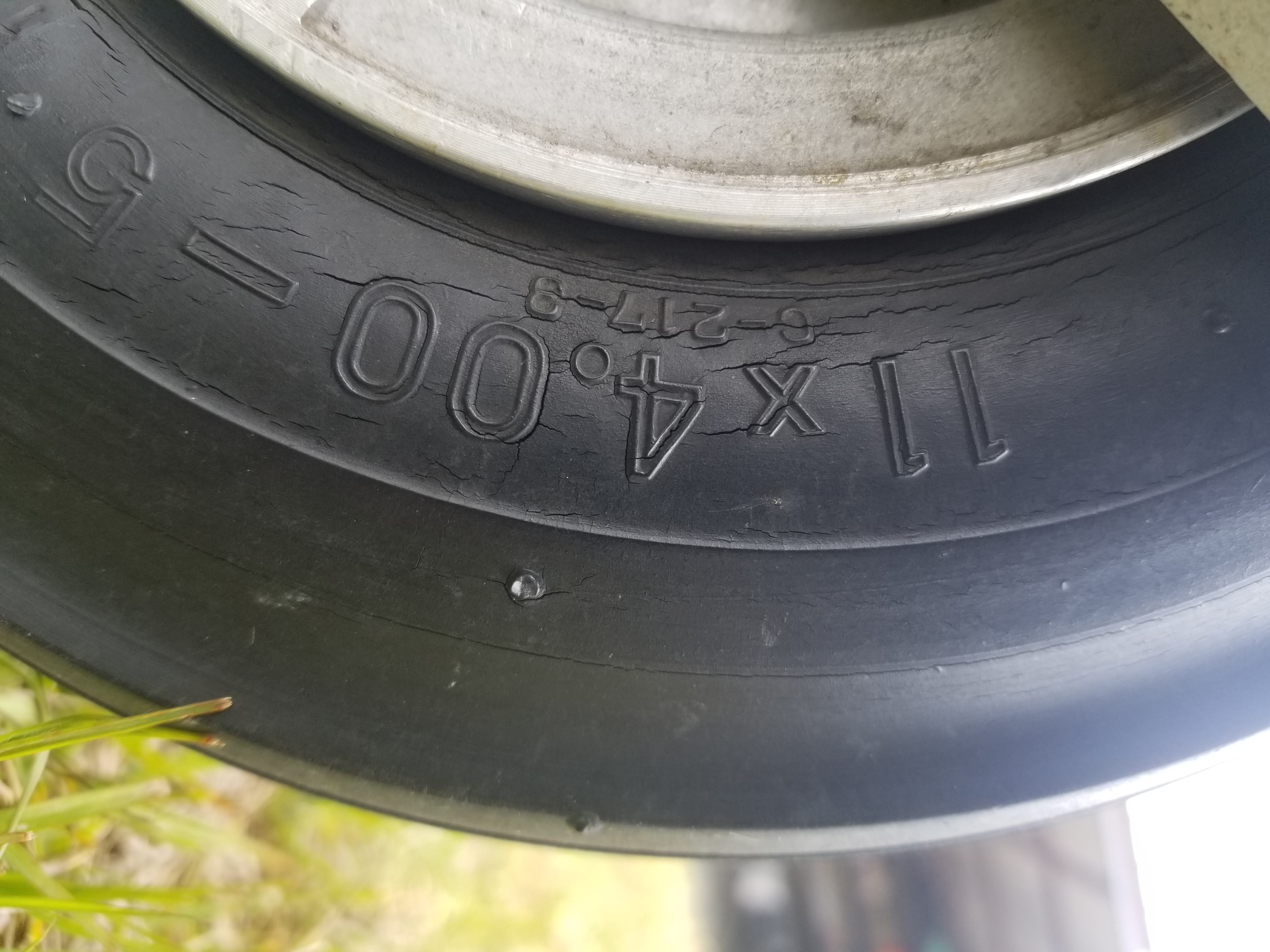

My front tire has cracks in it see attached.  Should I replace it.  Its about 2 years old.

I would change it. Should last a lot longer than 2 years. But the newness has clearly worn off.

Yeah....i fear i have to.   I dont think that it was the best quality to start with.

Take a look at AC 43.13-1B Chapter 9
9-14. TIRE INSPECTION AND REPAIR. Tires should be inspected frequently for cuts, worn spots, bulges on the side walls, foreign bodies in the treads, and tread condition. Defective or worn tires may be repaired or retreaded. The term, retread, refers to several means of restoring a used tire, whether by applying a new tread alone or tread and side wall material in varying amounts. The following guidelines should be used for tire inspection:
a. Tread Wear. Inspect the tires visually for remaining tread. Tires should be removed when tread has worn to the base of any groove at any spot, or to a minimum depth as specified by the tire or aircraft manufacturer. Tires worn to fabric in the tread area should be removed regardless of the amount of tread remaining.
b. Uneven Wear. If tread wear is excessive on one side, the tire can be dismounted and turned around, providing there is no exposed fabric. Gear misalignment causing this condition should be corrected.
WARNING: Do not probe cuts or embedded foreign objects while tire is inflated.
c. Tread Cuts. Inspect tread for cuts and other foreign object damage, and mark with crayon or chalk. Remove tires that have the following:
(1) Any cuts into the carcass ply. Page 9-10
(2) Cuts extending more than half of the width of a rib and deeper than 50 percent of the remaining groove depth.
(3) Weather checking, cracking, cuts, and snags extending down to the carcass ply in the sidewall and bead areas.
(4) Bulges in any part of tire tread, sidewall, or bead areas that indicate a separation or damaged tire.
(5) Cracking in a groove that exposes fabric or if cracking undercuts tread ribs.
