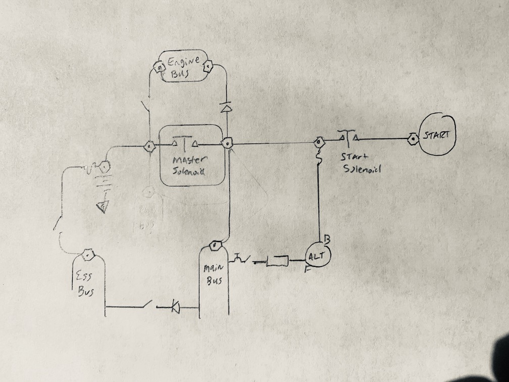

So, I'm proposing a Z11 system with one ignition wired directly to a normal size Main Battery, and the second ignition wired directly to a small single purpose Aux Battery.
Although Bob’s Book has a Dual Batt diagram, In the spirit of simplicity I didn't use a solenoid for the Aux Battery, I protect the aux battery with a diode, and I will monitor the voltage of the Aux battery.
What are your thoughts?

PostPosted: Wed Apr 01, 2020 8:20 am    Post subject: Re: Z11 Reply with quote

The Ignition is the critical item. I am comfortable loosing power to all the electronics other than the ignition, therefore the electrical system architecture is being designed to accommodate it.

Kind of......I considered the diagram but not the architecture. Dual alternators, brownout bus, it seemed complex for my application. My perception is electrical demands for EFI are large compared with my choice of ignition at 1.4A total. Since both ignitions tied to a single battery was not failure tolerant , the SureFly small second battery (12V 8Ahr is $50) seemed simple.

So lets reconsider that as archetecure and see what we come up with.
I have integrated the Architecture into my diagram, and removed the Aux Battery. The load on the Engine bus will be less than 5A so I will use a switch instead of a solenoid. I removed the Battery Bus to avoid a human error that might deplete the battery out in the bush.
If the power supply from the ALT side of the master solenoid fails, the engine dies until the switch is flipped by reliable human action. Not ideal. A diode to replace the switch eliminates human failure.
The next step I see is to remove the engine bus, bolt both power wires to the Battery side of the master solenoid. Now I am chasing my tail back to where I was. But lets say I did that. If the Solenoid fails open, then the engine is battery powered while the rest of the ship is powered by the alternator.
I think you already discussed months ago, but it looks to me like the Engine Bus duplicates the Essential bus.
How am I doing?
April Fools day revision

PostPosted: Wed Apr 01, 2020 9:39 am    Post subject: Re: Z11 Reply with quote
Why put a switch in series with the E-Bus diode?
I suggest that switch be eliminated. If it is not installed, it can not fail.
I suggest that a double pole switch be used for the engine bus switch.
The second half of that switch can enable the engine start circuit.
Properly wired, the engine bus switch must be on in order to start the engine.

bcone1381
Joined: 25 Apr 2017
Posts: 42
Location: Southeast Michigan
PostPosted: Thu Apr 02, 2020 8:19 am    Post subject: Re: Z11 Reply with quote
Merely Personal preference.....I like an avionics switch. The avionics will be on the essential bus.
In Bob's book he says that an avionics switch is a single point failure for every item on the avionics bus. Bob's fundamentals of aircraft design fixes that with a diode. If I place on the Essential Bus all the Avionics, my preference for an avionics switch is satisfied and no longer a single point failure because it has a secondary path from the battery.
The Switch and the Diode are used between the main and essential buses to avoid the main bus from ever drawing power through the essential bus.
Brooks Cone
Bearhawk Patrol Kit Build
