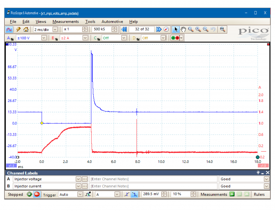

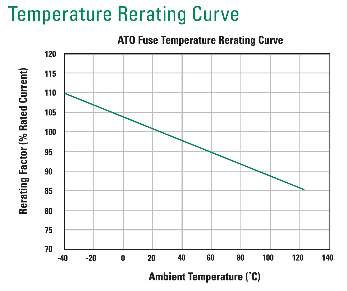

It seems to me that ATO fuses are OK.
There is no surge aka inrush current above continuous operating current. Since there is no surge current, we don't need to look at I2T. Surge currents come from motors, filament lamps, heaters, and large capacitors for instance.
Suppose a worst case temperature of 170F on the firewall. Per Littlefuse, an ATOF fuse is derated 25% to avoid nuisance blowing and 8% for 170F. 1/(.75*.92) = 1.45. Min fuse rating = 1.45 * normal operating current.
Injectors:
For example, SDS EM-5-F system uses 14.5 ohm "saturation" (as opposed to peak-hold which are to my knowledge used in single-point systems) injectors. Steady-state current is 1 amp per injector at 14.5 V. SDS recommends 5 A fuses, one per injector.
Repetitive: Yes, once per crank revolution I guess.
Current spike above continuous on level: No.
Current rise very sharp: Not compared to a resistive load. Inductor back EMF causes current to rise more slowly than a that of a resistive load.
Duty cycle: 85% max recommended.
Google found a typical plot at picoauto.com, attached, of saturation injector voltage and current. The plot even seems to be for 14.5 ohm injectors given the voltage and current levels shown. Note it takes a little over 2 mS for the current to reach saturation level. BTW the dip in current rise at 1.3 mS is when the solenoid valve armature moves creating back EMF in addition to what comes from the increasing magnetic field of the stator. Another BTW, the voltage plot shows the flyback voltage created when the inductor is de-energized; this is diode clamped, at 82 V in this case, to prevent damaging the drive transistor; the higher the flyback is allowed to go, the faster the injector will close.

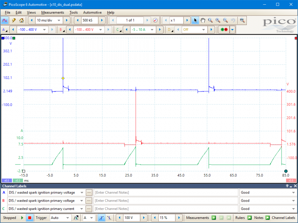

Coilpacks:
picoauto.com also has voltage and current waveforms, attached, for a typical distributorless dual driver wasted spark coilpack. Such a coilpack would be used on a four cylinder Lycoming.
This plot shows the same phenomenon of current rise slower than that of a resistive load. Saturation is not achieved, peak current is limited by dwell time rather than coil resistance. I2t of the sawtooth shown is the same as a square wave of 1/sqrt2 the height so the 6.25 A height would be 4.4A if it were a square wave of the same energy.
SDS says each of their coilpacks draw "just over 1 amp in cruise at 2,400 rpm". and they recommend a 10 A fuse for each coilpack. Using the 0.043 mS dwell time from the picoauto.com plot and assuming a four cylinder engine at 2,400 RPM I calculate an average current of 1.13 A at 2,400 rpm so this coilpack seems to be representative of the one SDS uses. In my calculations, current varies linearly with rpm.
