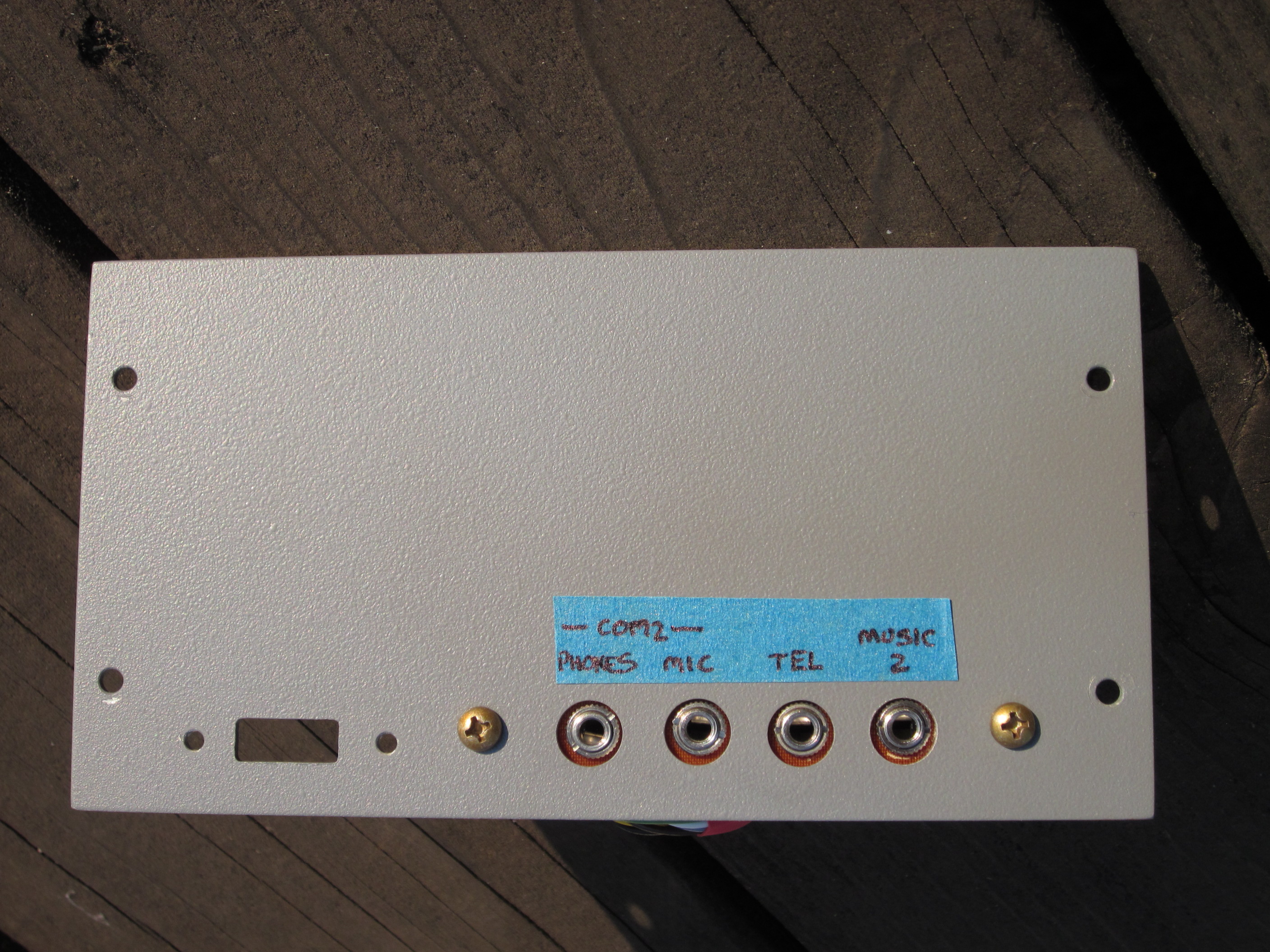

Yikes, those are some expensive pieces of phenolic! Not in terms of other
airplane parts measured in AMU ($1000 bills) of course but certainly in terms of
dollars per ounce.
In the past a friend has turned some on his lathe from some phenolic stock I had
on hand. Like nearly all machining operations, the setup is time consuming but
"production" is quite speedy.
I have also used 0.062-inch printed circuit board material (after cleaning off
the traces) to fabricate a rectangular strip that would mount jacks through
oversize clearance holes. Image attached.
The latter technique works for 1/8-inch jacks where no insulated mount is
available AFAIK.
