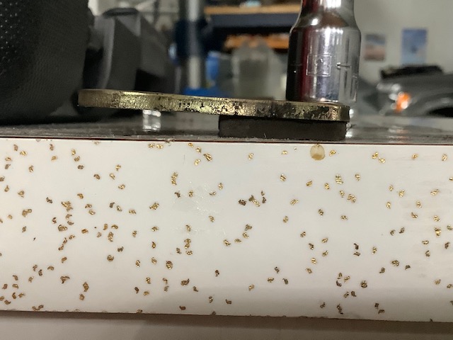

Hi folks,
I assume that others have already seen this? The caliper’s offset piston position (dumb design) puts asymmetrical pressure on the pad, wearing it to an angle, until the piston jams in its bore, so it does not release. Gonna have to sand it down straight, which will fix it for a bit. Just bought a replacement tubed tire for the shelf, so will have to wait to switch to the Beringer.
Cheers,
Pete
C-GNPZ classic mono.
