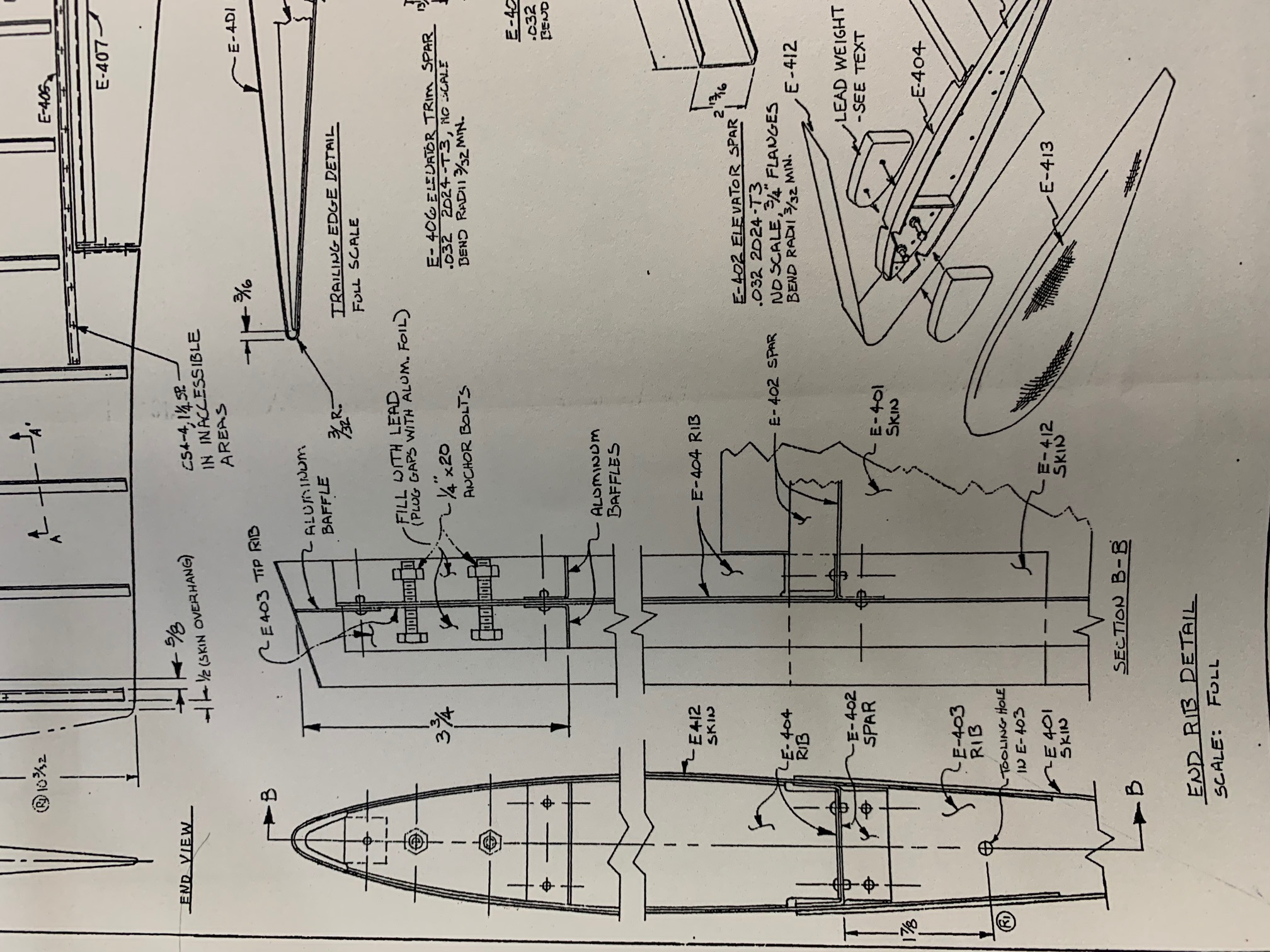

I built my RV4, and Did melt lead and pour it in. If I remember correctly, there are bolts that go through the two ribs back to back that form the elevator counter balance arm.
It you take off the fiberglass tip you might be able to see if the nut(s) holding a bolt is loose. Let us know if that works. Good luck.

Hal is correct, see attached.

If I could get to the area and the lead isn't too banged up, I'd be thinking about some really thin epoxy to both fill the gaps and 'glue' it into place. Is that a possibility? Unfortunately, it would likely involve removing the elevator
so you could pour the epoxy into the cavities.

Thanks for the idea and drawings Charlie.

Thanks Alain.
