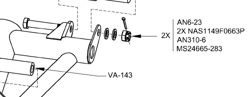

PostPosted: Fri Feb 28, 2020 12:47 pm    Post subject: Fwd: Service Bulletin SB 19-09-09 Published - Inspect RV-10 Reply with quote
Looking at the picture in the SB, it seems the inner ears are thicker (Bolt lenght -1 longer)
Further AN6 Bolt instead AN5 and some NAS washers.
[img]cid:part1.5A4EE10B.FC937636(at)gmx.net[/img]

isaac.schantz(at)gmail.co
PostPosted: Fri Feb 28, 2020 1:02 pm    Post subject: Fwd: Service Bulletin SB 19-09-09 Published - Inspect RV-10 Reply with quote
Also, note the lower ears with the WD-1016 attachment.  The extra washers appear to have been removed and what appears to replace them are washers bonded to the bolt attachment ears.
