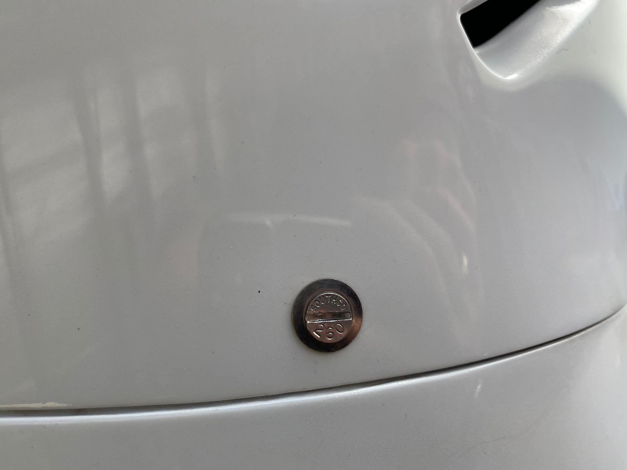

We also had problems with Phillips head screws becoming worn. We have changed to 100 deg stainless steel Torx head screws. We purchase them from MicroFasteners.
Here is the webpage: https://www.microfasteners.com/home.php?cat=620
We use a small amount of BoeLube to handle the possible galling due to different metals.

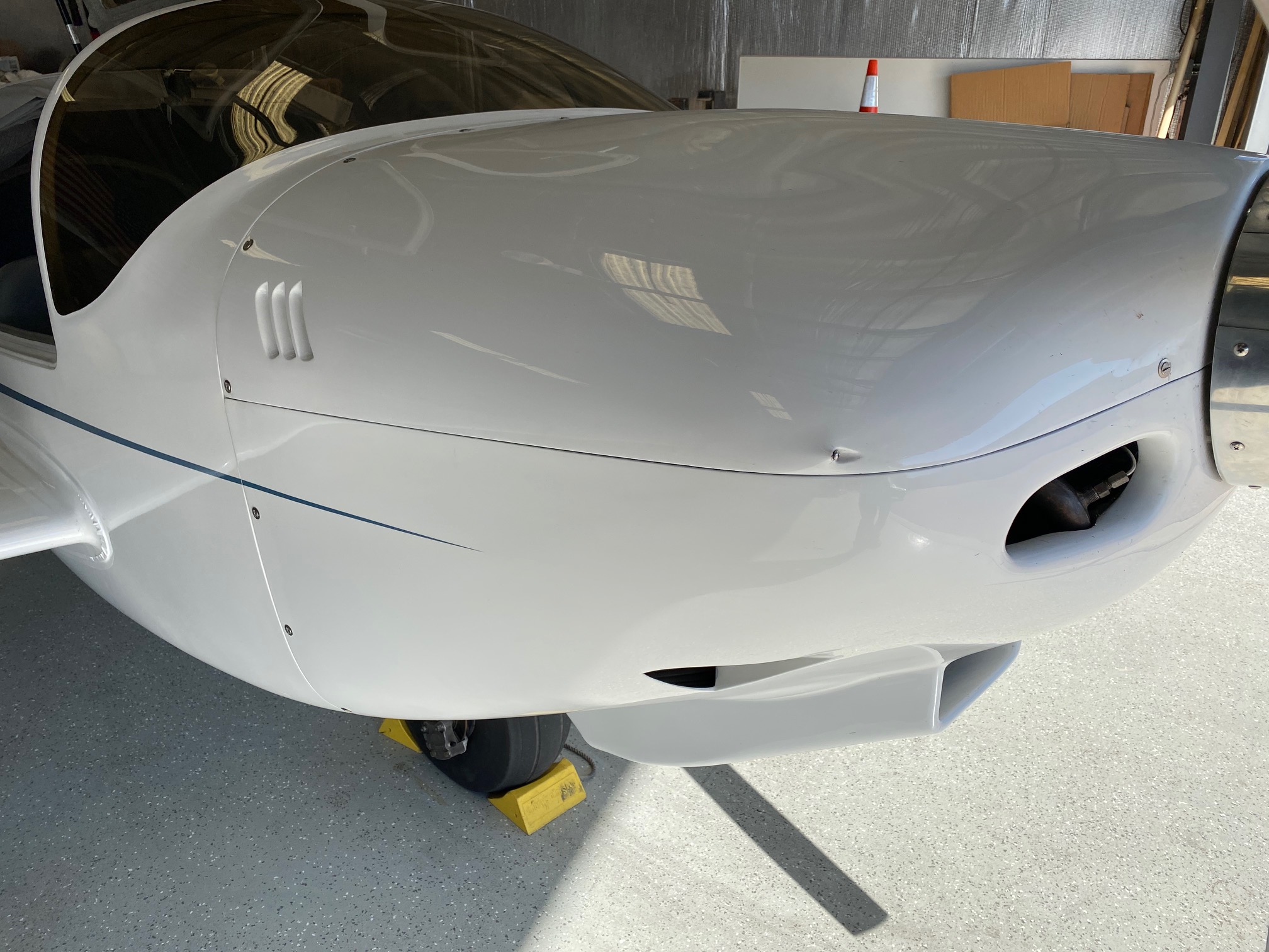

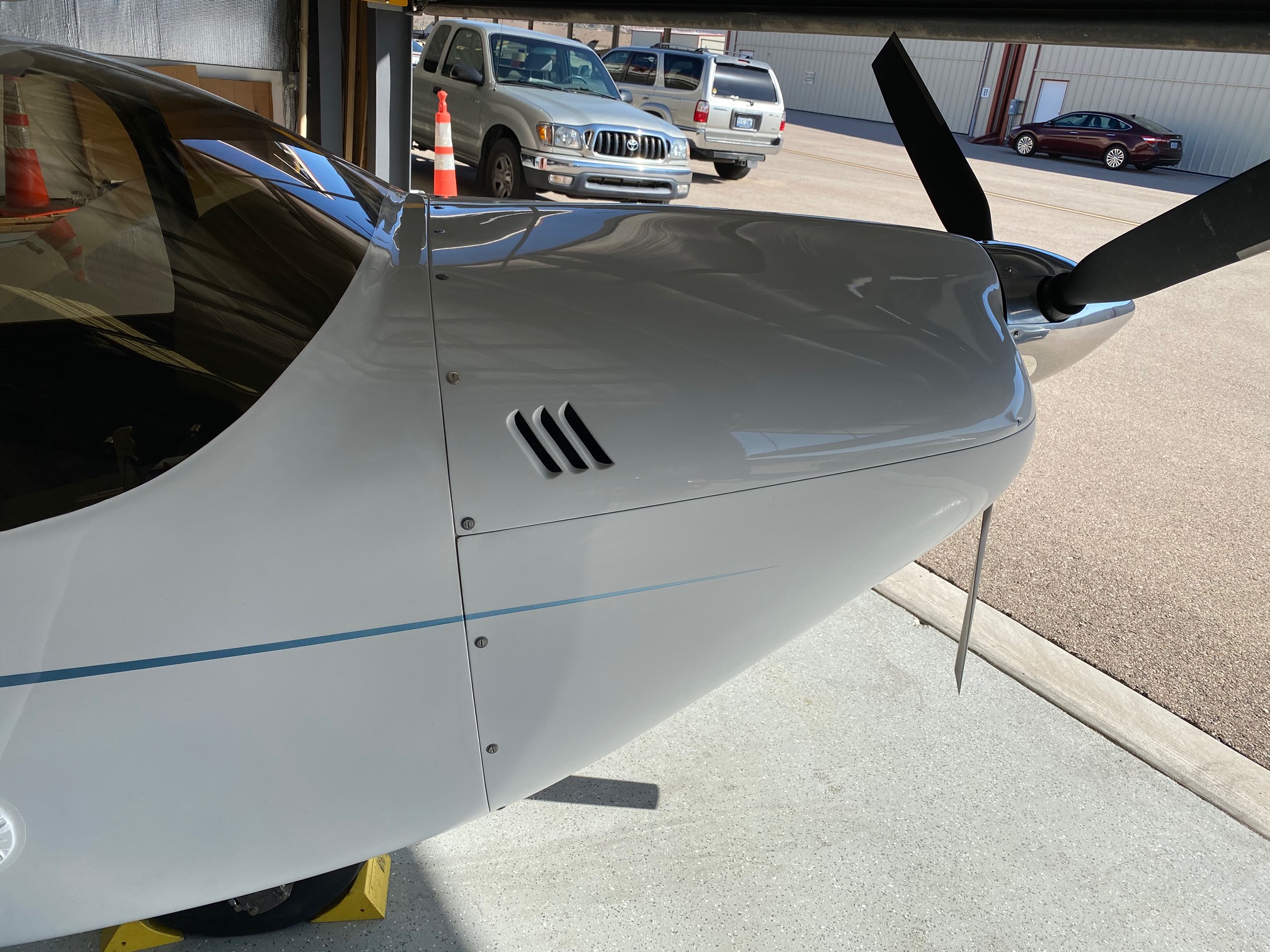

You may want to consider using Southco quarter turn fasteners. They are available in both slotted and Phillips head. I also installed a hinge along the side of the cowl with removable hinge pin, in lieu of fasteners. This makes for a cowl that is quick and easy to remove.
I believe there is a Europa Club mod for the fasteners. I chose to go with one size of fastener -260 even though the thickness of the cowl and firewall flange vary. I simply padded out the back of the receptacle to accommodate the one fastener length.

I have also used quarter turn fasteners, in this case from MilSpec products
https://milspecproducts.com/products
They have two versions- the 2000 and 4000 series. On their advice I got the 4000. These are of warfighting standard, they can easily hold an Apache together. You will certainly not have any problems wearing out the heads, these are TOUGH. In retrospect the 2000 would probably have been fine too- slightly cheaper and smaller.
The big advantage is that the recepticles are adjustable. You screw in the fasteners to the right depth, pull out a small pin and you're done.
Can't imagine having to screw and unscrew the cowlings every time, losing and replacing dud screws. Raimo Toivu, who originally recommended the fasteners to me, doesn't even have water and oil hatches because the cowlings come off and on so easily.
Jeroen
