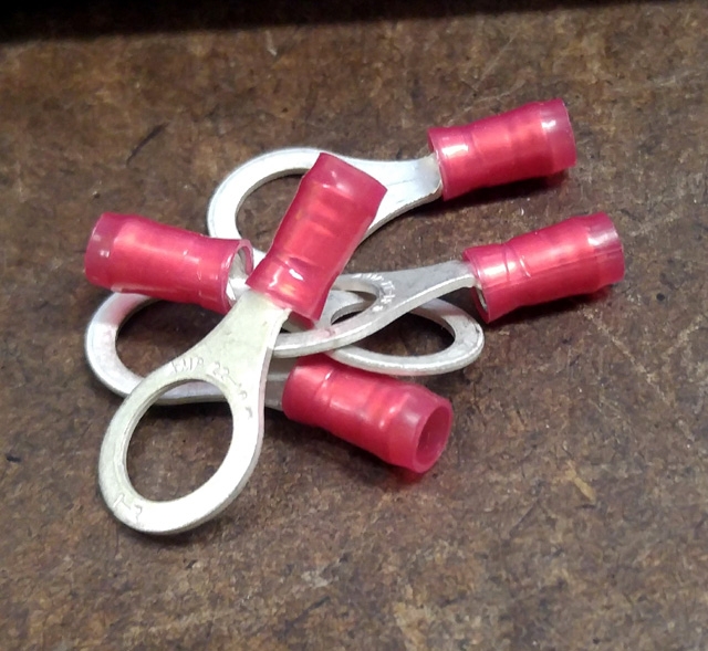

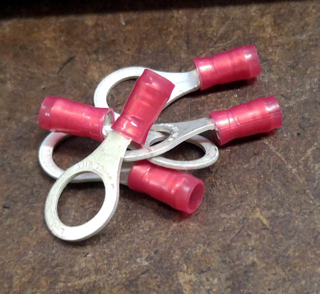

PostPosted: Thu Feb 27, 2020 4:05 pm    Post subject: Connecting small wire to large terminal Reply with quote
At 08:28 AM 2/27/2020, you wrote:
Quickest is to fill the extra space with extra strands from larger wire.
Sent from BlueMail
On Feb 27, 2020, at 1:06 AM, Lyn Robertson <lyn.robertson(at)gmail.com (lyn.robertson(at)gmail.com) > wrote:
I am building an RV14A and plan to install dual P-mags. In the drawings, power for the P-mags is shown as coming directly from the switched side of the master solenoid. The problem is that the supply wire is 20 gauge and the solenoid terminal is a 5/16” stud. I have been unable to find a ring terminal connector that will fit both the wire and the solenoid terminal.
Shoot me a mailing address and I'll send you
some . . .
[img]cid:7.1.0.9.0.20200227180052.0681ad80(at)aeroelectric.com.0[/img]
