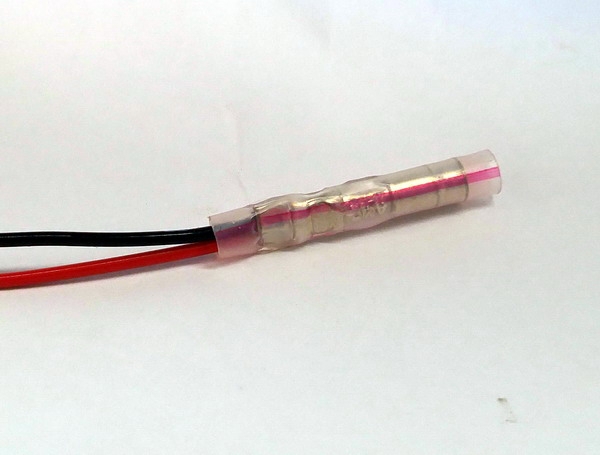

I’m planning my first basic electrical application on my experimental kit....the headset jacks. One 20awg wire will run to the two jacks then split
Please confirm ...in order to split a 20wag wire into two separate 20awg wires using PODG crimp connectors a single blue 14-16awg butt splice would receive the two 20awg wires on one end and a single 20awg on the other crimped end maybe with a second very short 20awg wire added because the space in the blue butt connector is a size too large.

Two 20AWG Tefzel wires will fit nicely into
a RED PIDG splice . . .
[img]cid:7.1.0.9.0.20200216154155.02cf4978(at)aeroelectric.com.0[/img]
. . . with your single 20AWG going into the other end.

I understand...Two 20 AWG wires fit into a red crimp connector.
Is there any standardized chart or method we might call a BEST PRACTICE to calculate how many wires or certain sized in each size PIDG connector?

Not that I'm aware of. The idea is to fill the
barrel with enough copper that you get a
gas-tight joint when the tool is applied.
http://www.aeroelectric.com/articles/CrimpTools/crimptools.html
you probably can't put too much wire into
the terminal. The biggest risk is too little
wire such that the crimp doesn't completely
close down on all the stranding. When in
doubt about too little, strip 2x for length
of exposed strands, double them back before
inserting.
