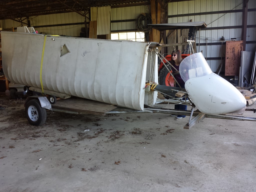

Valid point. I hauled my project on a completely open trailer (looks like a boat trailer, but was custom built to haul a Thorp T18). The wing coverings didn't survive the 600 mile trip, but I figured that had more to do with the 30 year age of the fabric than any kind of wind damage. The tailfeathers got a couple of holes from my inadequate securing of the cables & fittings, but were easily patched. The tail's fabric was in much better shape than the wings'.
