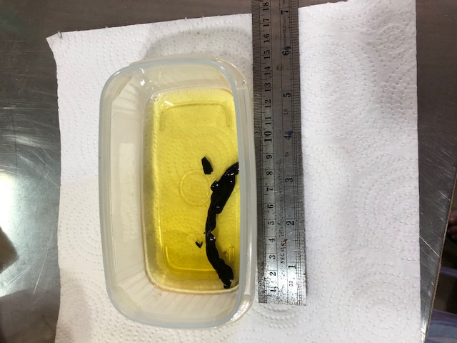

While doing the annual on a 13 year old aircraft, I used a 1 inch tube to siphon out the fuel. I assume the large black rubbery deposit in the photo is part of the internal coating of the tank. Has anyone else had this problem ?
My concern is that the coating is degrading and the fuel will damage the fiberglass and also that the piece is large enough to wrap itself round the finger strainer in the tank.

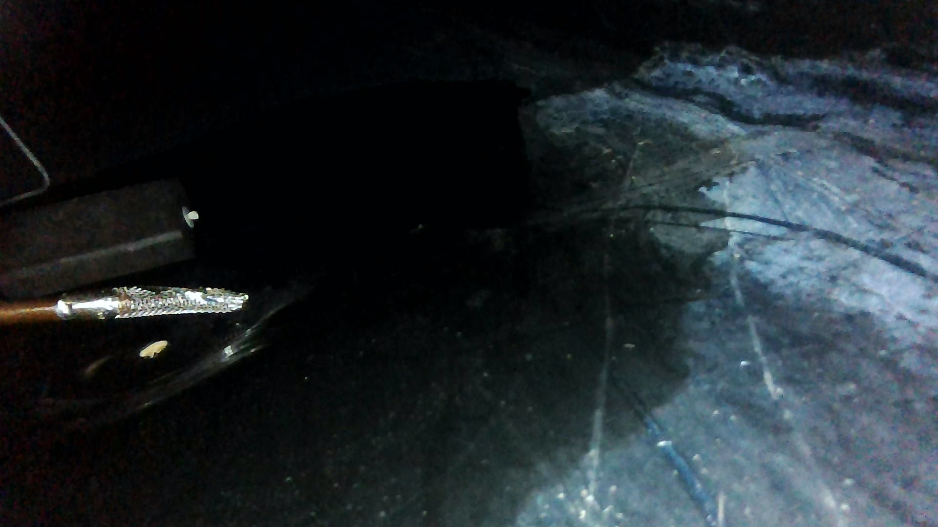

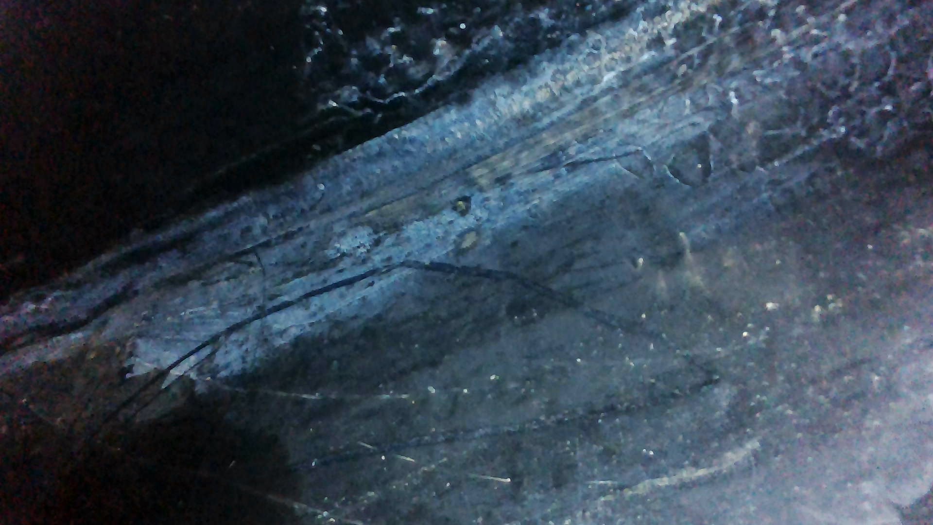

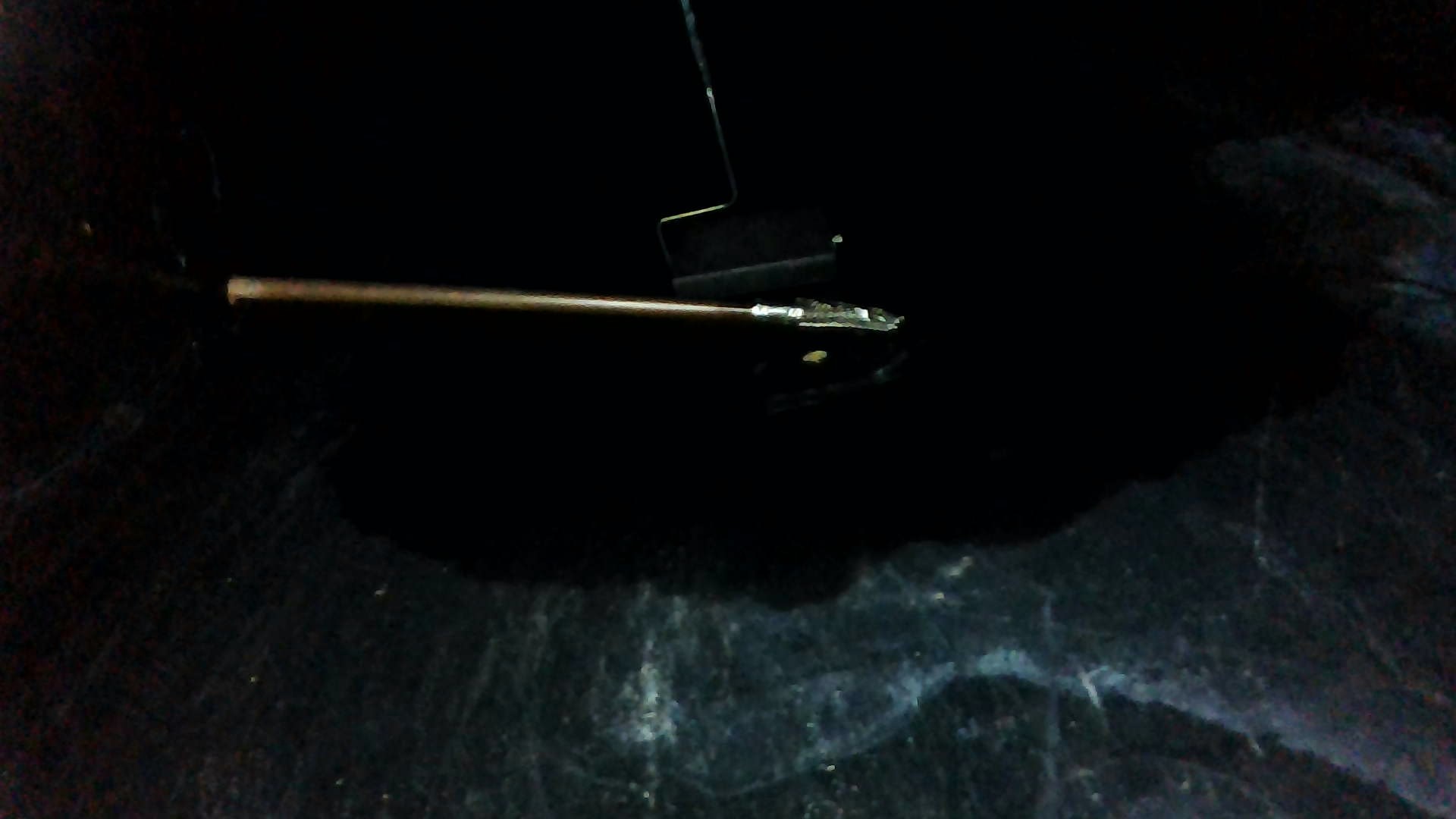

PostPosted: Wed Feb 05, 2020 11:20 pm    Post subject: Re: Fuel tank internal coating degrading Reply with quote
I borescoped the tank and didn't see evidence of flaking although there were color variations
I have never had black deposits in the filters or drain
