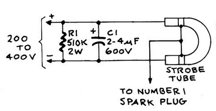

PostPosted: Tue Feb 04, 2020 2:53 pm    Post subject: Testing a strobe tube ? Reply with quote
You need thousands of volts across the terminals. Do it wrong,
and you might not wake up next week. You might be able to hook
it into a spark plugs circuit, counting on the coil to limit
the power. . .but I wouldn't do that unless I was willing to
throw it away.
Few xenon flash tubes operate at such
voltages . . . those are usually
industrial sources of UV light.
Our a/c strobes, vehicle emergency strobes,
camera strobes operated in the 250 to
400v range. To test them, you need both
a steady source of flash-voltage paralleled
with an energy storage capacity -PLUS- a
much higher (1 to 3 kv) trigger pulse
feed to the trigger electrode. In cameras,
this takes two transformers. One to provide
a 200-400v charge on a capacitor . . .
a second to develop the higher voltage
trigger.
One of the simplest strobe circuits was
used in low-cost, timing lights . . .
[img]cid:.0[/img]
My first one plugged into the wall and
developed about 350 volts on the energy
storage capacitor. The trigger pulse came
from connection to the engine's #1
plug.
There's no really quick/n/dirty way
to test these critters other than to
plug it into a functioning system.
Given that its an out-of-the-box offering,
the risks are low.
 Filesize:  43.04 KB
 Viewed:  5104 Time(s)
