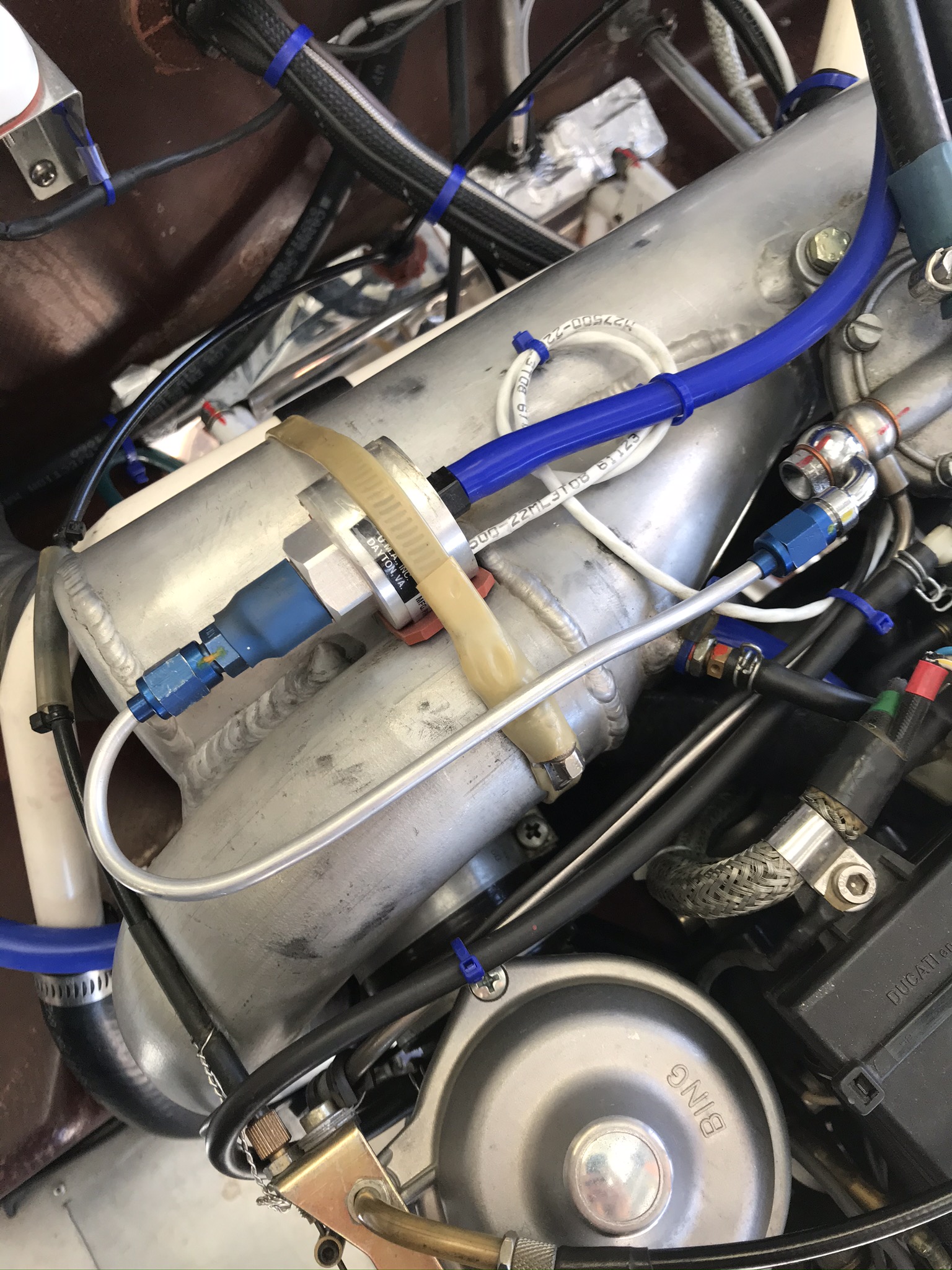

PostPosted: Sun Jan 26, 2020 8:57 am    Post subject: Rotax 914 UMA Differential Pressure Transducer Failure? Reply with quote
Hi Ron,
I have the UMA transducer installed on the of the airbox on my 914 (see picture). No issues in the 10 plus years it’s been installed.
Erich

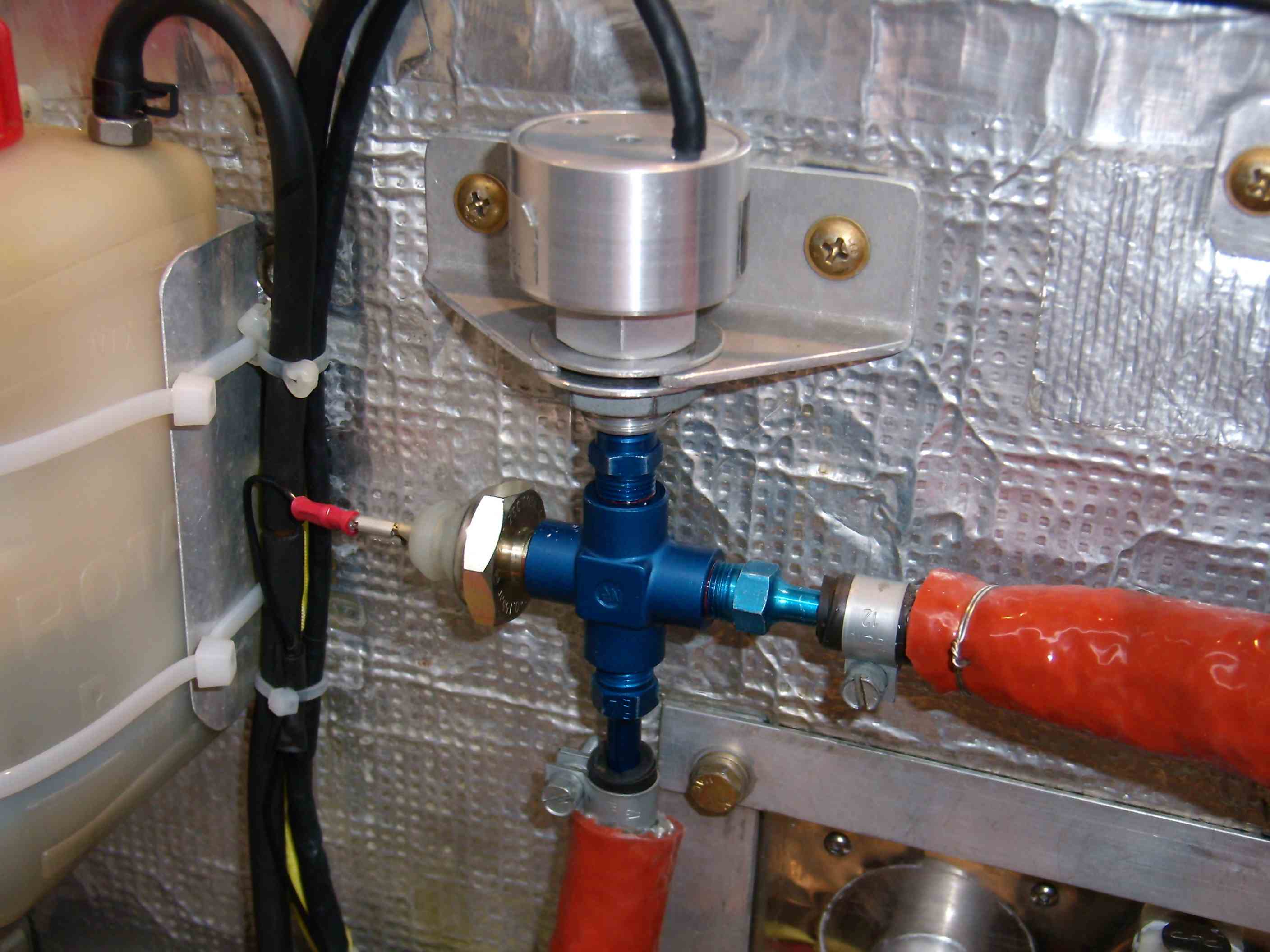

PostPosted: Tue Jan 28, 2020 12:53 am    Post subject: Re: Rotax 914 UMA Differential Pressure Transducer Failure? Reply with quote
Mine failed twice, first time after 30 hours, indicating zero, replaced under warranty, then after 300hours started to give false readings, replaced with a steam gauge.
It was installed on the firewall, see attached picture. Note the engine is a 912ULS, but the UMA sensor is the same as the one for the 914, except that it is vented to the cowling atmosphere instead of the airbox.
Remi
