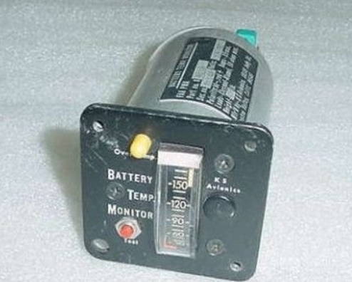

catastrophic. In the earliest days of
wet ni-cad batteries, numerous incidences
of thermal runaway culminating in a battery
fire were experienced. This condition prompted
the 'band-aid' battery temperature monitor
mandate in some aircraft
