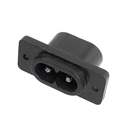

Therefore I am going to install an external socket like this
in the airplane skin, to be easy to connect the charger from the outside.
I am thinking in connecting both batteries to this socket through a SPDT switch, to be able to select which battery to be charged.

Carlos I think your plan is way too complicated. My RV-10 has a fuse protected battery charging cord connected to each battery and going to the baggage compartment. If I want to charge that battery, I open the baggage door and plug into that battery. No external door, no switch.
First select and purchase the charger. With many chargers you can disconnect the alligator clips and there is some sort of plug. Use the same plug on the end of the battery cable. My charger came with one free battery cable, the second one was $10. Many of these chargers use 2 prong automotive plugs which are cheap and available everywhere.
On Sun, Jan 19, 2020 at 1:24 PM Robert L. Nuckolls, III <nuckolls.bob(at)aeroelectric.com (nuckolls.bob(at)aeroelectric.com)> wrote:
At 12:46 PM 1/19/2020, you wrote:
Guys
In my RV-10 both batteries (main Batt - Odissey PC-925, and Aux Batt - Odissey PC-680) are in the back, inside the tail cone, behind the baggage compartment.
This is a difficult place to reach, in the completed airplane, to connect the clamps of a battery charger/maintainer.
Therefore I am going to install an external socket like thisin the airplane skin, to be easy to connect the charger from the outside.
 That's an AC power connector . . . not polarized.
 No feature to prevent reversed connection.
 This is not a very environmentally robust
 device either.
 Is your airplane hangared? How about putting
 a goof-proof connector just inside the baggage
 compartment . . . leave door ajar and plug in
 shore-power. Connector stays out of weather.

  The only time you need to CHARGE a battery
  is if you parked the airplane in a less-than-
  full state of charge. The only time you need
  to plug-in is if the airplane is going to be
  parked for an extended period of time.
  You don't need a switch, there's a way
  to wire a 3-terminal connector to effect
  battery paralleling for the purpose of
  MAINTAINING. But if you anticipate a need
  to CHARGE less than topped-off batteries,
  then we need to discuss the brand/model
  of charger.

Install 2 of these, one on each battery. Fuse at 20 amps.
