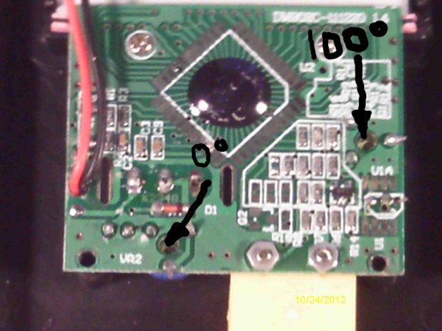

I calibrated the 3 TM-902C hand held instruments. I was able to adjust them to read the same at both 0 and 100 deg C. It seemed to take 2-3 cycles from cold to hot and back to get them to settle down, but once they did they all were very consistent at both ends of the range tested.
As I reviewed Bob's posting I noticed that the boards in mine are a different layout than the one pictured. I'll include a picture of mine if I can get to upload.
On mine one adjustment point is to the left of the yellow connector (6:30 position) near the edge of the board. The second is located at the 3:00 position.
The 6:30 position adjusts the readout at 0 deg C. The 3:00 position adjusts the readout at 100 deg C. As I mentioned earlier it seemed to take 2-3 cycles before it becomes stable.
On both adjustments turning clockwise lowered the value displayed. CCW raised it.
