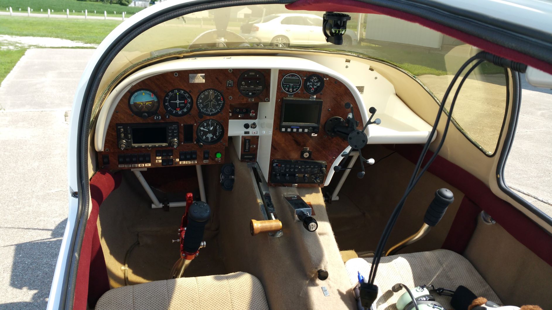

With my Beringer I particularly like having mounted it low on the pilot’s control column which allows left hand breaking with right hand on throttle

Another point worth mentioning is that you can (& I have with approval of LAA) fit the Beringer brake lever on the central console in the same position as the original, thus allowing access to the brake from either seat. David Joyce, GXSDJ

Not sure whether you are comparing it with the original or a joystick mounting. Don&rsquo;t know about the latter (although I can see no reason to think it would be different) but it certainly seems to need less pressure than the original and to be more effective. David Joyce, GXSDJ

I have the Beringer manual lever on my control stick with the original factory monowheel calipers and it works very well. It takes less than .75 inch of travel on the handle to start braking. It has a locking pin in the braking position allowing it to be used as a parking brake which is also very effective. It has enough grab to hold the plane in place during full power a run up.
The lever just clears the knobs on the GNS430 when full forward though, no room to spare.
 Filesize:  282.19 KB
 Viewed:  23530 Time(s)
Lee
