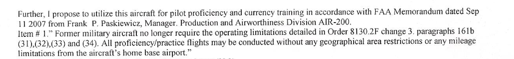

I do not understand this continuous rehash on program letters on where you can fly?
The below is what I have put on my letter for many years. I only detail any actual air shows
that I attend and or participate in as an unpaid performer. Never have I said what route I was
taking.  CJ6’s and all versions of Yak 52’s and many other experimental exhibition class aircraft
fall in the category and class referred to in the attached info have NO area restrictions!
You can fly anywhere at any time in the United States of America that any certified aircraft can.
