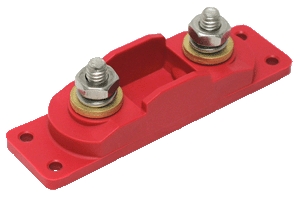

To finish off another thread, if I have a 40 amp alternator and I want to fuse-protect the B-lead would you recommend a 50 amp (or other) ANL fuse somewhere forward, like on the firewall?
Mount a MANL40 (miniature ANL)
as close to starter contactor as
practical as illustrated in z-figures.
https://tinyurl.com/sru9gam
There are a number of offerings
for MANL fuseholders. Avoid the
'auto-audio' types that attach
the feedlines by mashing down on
the ends with a setscrew . . .
[img]cid:.0[/img]
Use a two-stud style only with your
feeder terminals in direct contact
with the fuse tabs.
You could make your own out of delrin
or phenolic . . . two bolts and an
assortment of nuts and washers.
