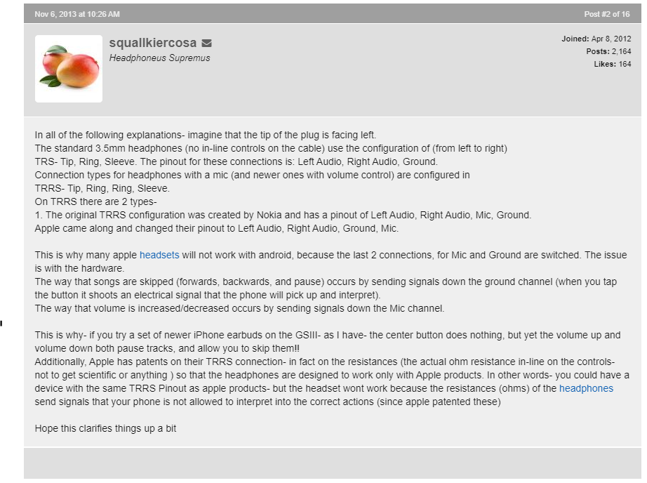

You say 4-conductor.  How is that wired from the phone?  I'd try a 3-conductor patch cable.  Here's a forum post elsewhere that gives some clues to wiring.  Apple vs. everyone else means that the microphone and ground are reversed between systems.
(apologies if images aren't appearing... link should be good).  By plugging in a 3-conductor cable you should be telling the phone to ignore the microphone.

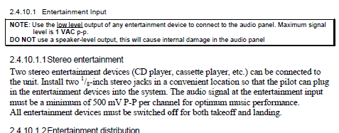

From the SL-15 install manual:
"The audio signal at the entertainment input must be a minimum of 500mV P-P per channel for optimum music performance."  (Max is 1V P-P).
