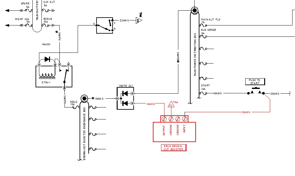

I'm sold on both counts. I'm turning my traditional 6-pack VFR GlaStar into an all-glass IFR plane and I'm wiring it using Z-12 with no endurance bus and no avionics master. I repurposed its hole for the pitot heat switch.
We've been pondering a relatively new
phenomenon that may well justify keeping
the 'special' bus . . .
The e-bus came about because it seemed
elegant to have a plan-b for battery
only operations that minimize loads on
the battery while eliminating contactor
loads on an SD8. Obviously, 'minimizing
loads' in a dual-alternator system
has little or no value assuming the
standby alternator will carry all
of the plan-b loads.
If the s/b alternator in Z-12 meets
those requirements, then we're no longer
concerned with the ENDURANCE bus.
In recent years, we've seen a new constellation
of flight instruments and avionics with greatly
EXPANDED functionality but with LOWER energy
demands from ship's power . . . except . . .
The critters like to 'reboot' if the bus
voltage is depressed below some value . . .
a condition generally limited to a few tens
of milliseconds during starter motor inrush.
The new condition has been discussed and
numerous solutions proposed and some
tried. Some systems feature a small,
support battery wired to support vulnerable
devices during engine cranking. A variety
of control protocols have been considered
The simplest and most elegant solution seems
to be the inclusion of a dc/dc up-converter
set up for an output of 14 or so volts. This
device is diode-ored to supply power to the
'brown out bus' a few milliseconds before
the starter contactor closes . . . and is
kept in the loop as long as the starter button
is engaged.
[img]cid:.0[/img]
A excerpt schematic shown here. Obviously, this
requires a more robust starter push-button. Two
diodes in a bridge rectifier provide the diode-or
function for powering from either the MAIN bus
or the brown-out booster.
Since the dedicated special function bus exists,
the builder COULD carry the legacy alternate
alternate feed path from the battery onto the
brown-out bus.
Of all the philosophies we've discussed, this on
seems the most elegant. I'm going to incorporate
it into the next revision to Z12.
To recap:
(1) the need for an Endurance Bus goes away
'cause the second source of engine driven
power is sufficiently robust to manage
most necessary loads during loss of main
alternator.
(2) The legacy auto switching feature for the standby
alternator serves no practical purpose. In
fact, there's no reason that the s/b alternator
couldn't be paired with the least expensive
of regulators. (a) the probability of ever
needing it is low. (b) all of the warning and
adjustability features of a primo alternator
controller will not add to the utility of
having the high-energy source available
for perhaps a few hours after loss of main
alternator.
(3) For airplanes fitted with brown-out sensitive
appliances, an independently support bus
driven with solid state voltage boost offers
compact, low cost of ownership and maintenance
free alternatives to any form of battery.
 Filesize:  109.58 KB

PostPosted: Sun Dec 22, 2019 7:24 pm    Post subject: Re: The next generation of Z12 Reply with quote
The relay needs to be electrically interlocked with the start button to
prevent the DC-DC booster from supplying current to the starter motor.
Joe Gores

PostPosted: Sun Dec 22, 2019 7:47 pm    Post subject: The next generation of Z12 Reply with quote
The TCW stand by battery, a little expensive, does the same thing with no other system changes. It also is able to keep two Advanced Flight EFIS'S alive for 30 plus minutes in case of contactor issues.

PostPosted: Sun Dec 22, 2019 7:48 pm    Post subject: The next generation of Z12 Reply with quote
Bob, do you have a part number for the brown-out booster? I'm curious about its characteristics (e.g., what's the highest voltage it might produce if the brown-out isn't so bad). Also, if the bus depression is a few tens of milliseconds, might a big hefty capacitor do the trick (charged from the main bus, not the starter feed)?
  is engaged.
[img]cid:16f30d66347326eec31[/img]
  brown-out bus.
  To recap:
      alternator.
      alternator.

PostPosted: Sun Dec 22, 2019 7:58 pm    Post subject: The next generation of Z12 Reply with quote
I completely agree with (1), (2), and (3) Bob. All would be an improvement to our current systems.
As an aside, I have not had any problems with EFIS systems rebooting during engine start. It seems that Dynon, GRT, Garmin, all now take care of this internally since they are all expected to keep working during engine start since they are the engine instruments. With IFR aircraft though, it is nice to be able to program the GNC before engine start, and I've lost the programming a few times during engine start. Very frustrating, especially since even saving the flight plan doesn't yield useful results as many departures and arrivals will not load properly from a saved flight plan. On these aircraft brown-out protection for the GNCs would be very helpful.
Also of possible interest, on the way to Oshkosh last year the backup battery for our PFD starting giving error messages. The builder commented that we were down to only 3 sources of power for it (2 alternators and the ship's battery). To test the theory I switched to the backup alternator (SD-Cool and it was completely dead, which I said wasn't possible. At destination the builder had a look under the panel and confirmed that a wire had vibrated loose.
  is engaged.
[img]cid:16f30dbcc88326eec31[/img]
  brown-out bus.
  To recap:
      alternator.
      alternator.
It's an off-the-shelf product off eBay, banggood, amazon.
Sized to the task. It's an adjustable, set-and-forget,
step up power supply. Here's an exemplar device.
https://tinyurl.com/sf8wwob
Note: lets not run out and buy one of THESE
devices before we do some bench testing. . .
from the constellation of candidates, there
WILL be an entirely suitable device but I
can't tell you yet that it's THIS one . . .
Capacitors have been used successfully in
cases where but brownout bus is lightly
loaded . . . but some builder's plans
called for more snort. Further, the capacitor
boost device called for significant beat-n-
bash on the bench to assemble a number of
components from Digikey et. als.
The upside of the boost-converters is that
they are very nearly plug-n-play and
come in a variety of sizes wherein virtually
all brown-out protections can be addressed.
You lost me . . . how would that happen?
If the pilot inadvertently leaves the brownout relay switch turned on, then the
relay contacts provide a current path between the DC-DC booster and starter
motor via diode, brownout bus, relay contacts, main battery bus, battery,
battery contactor, starter contactor, starter motor, not to mention other
aircraft loads. To make the circuit foolproof, the relay coil circuit should be
wired in series with the normally closed half of a DPDT start push button.
Joe Gores
Joe Gores
Good catch . . .
I've published the P1 edition of Rev N to Z-12
at:
http://www.aeroelectric.com/PPS/Adobe_Architecture_Pdfs/Z12NP1.pdf
Per Joe's catch, I've routed the brownout booster
power through normally closed contacts of the
CLEARANCE DELIVERY relay. So if the switch is
inadvertently left closed during start, there will
be no back-feed of boost power to the rest of the
system. The worst thing that happens is that
some electro-whizzies may reboot . . .
