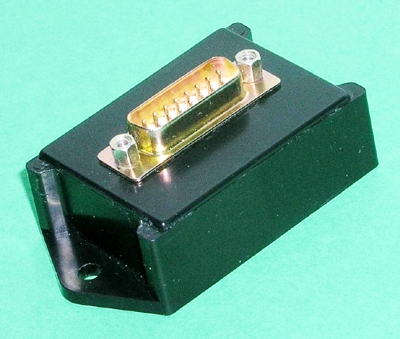

It might even be that the end-product can be fitted
into this stock enclosure
[img]cid:.0[/img]

What is the source for the d-sub enclosure you suggested?
How much current can be handled by a single pin on the connector?

got a bucket full of them . . .
5A but I'd parallel up two pins for each power
path . . . there are plenty of extras. I qualified
this process on a military targets program about
15 years ago.

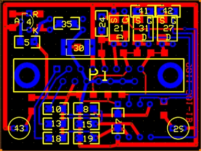

First gate to pass is to select logic level
FETs with sufficient current rating and make
sure you can get rid of the heat in this
2.8 x 1.4 footprint.
[img]cid:.0[/img]
Here's the schematic for this particular layout.
http://tinyurl.com/7m56z8o
Depending on what parts are put on, which are
left off, what the values are and what software
is in the uC, you can do a lot of different things
with it . . . and probably the next generation
wig wag.
