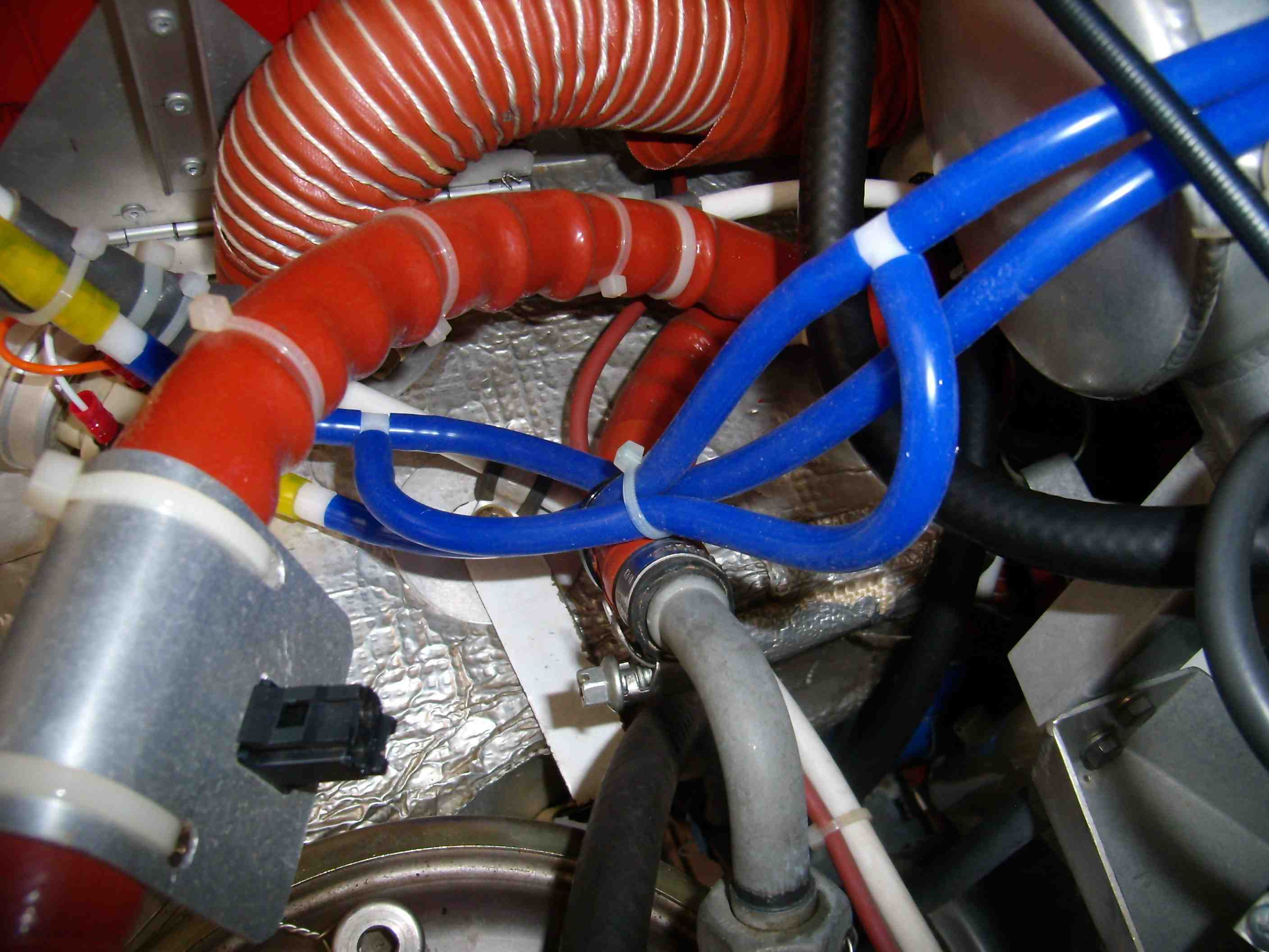

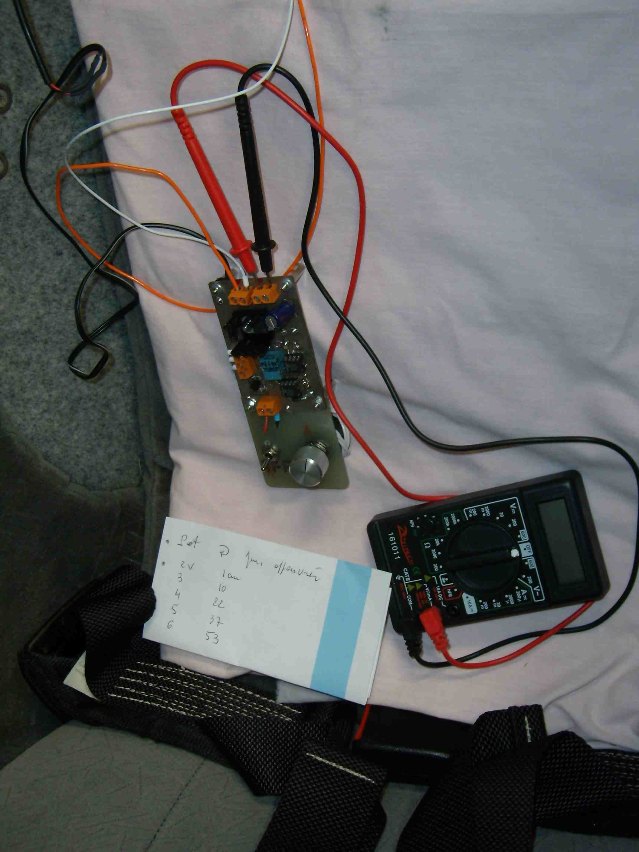

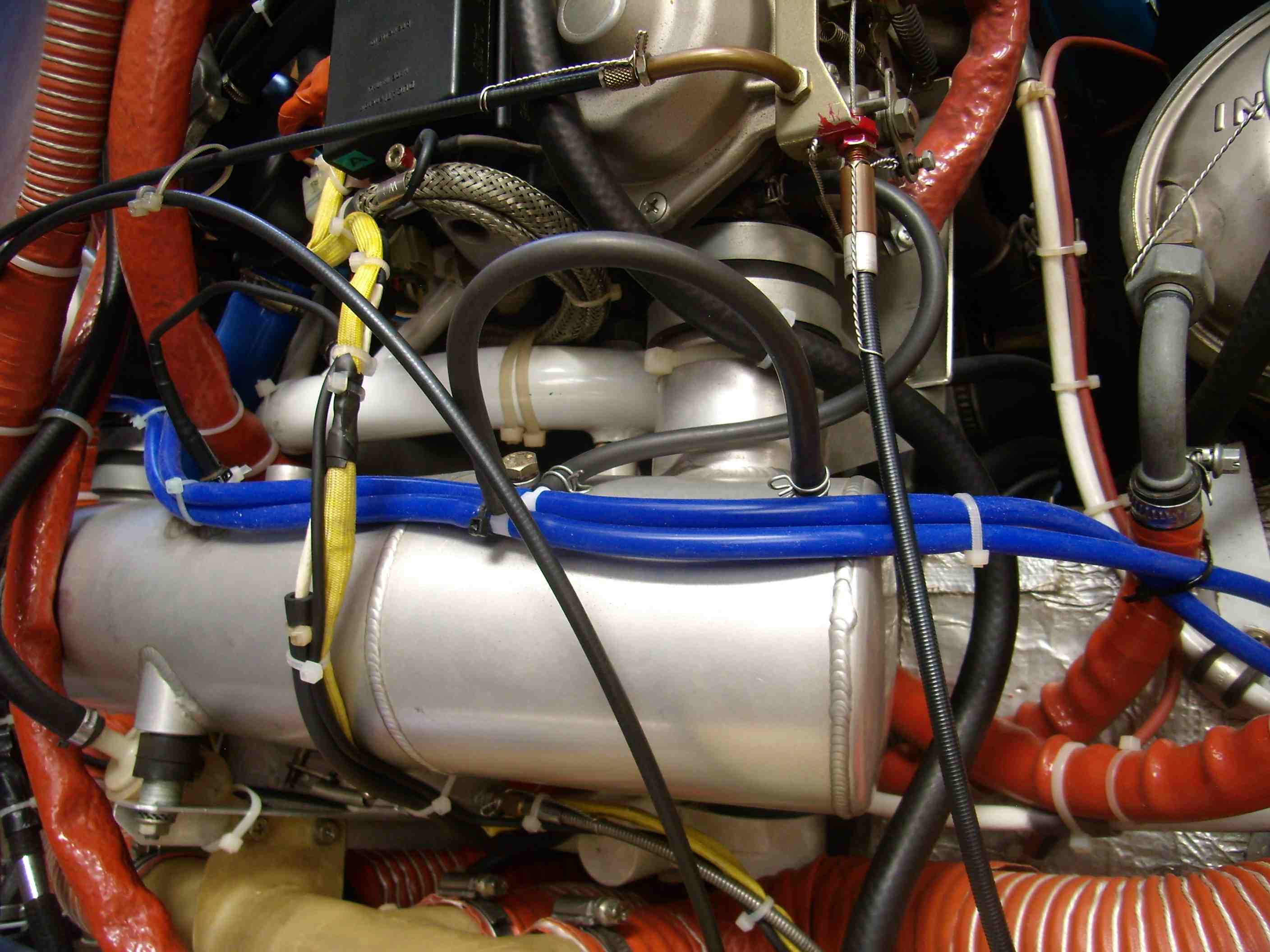

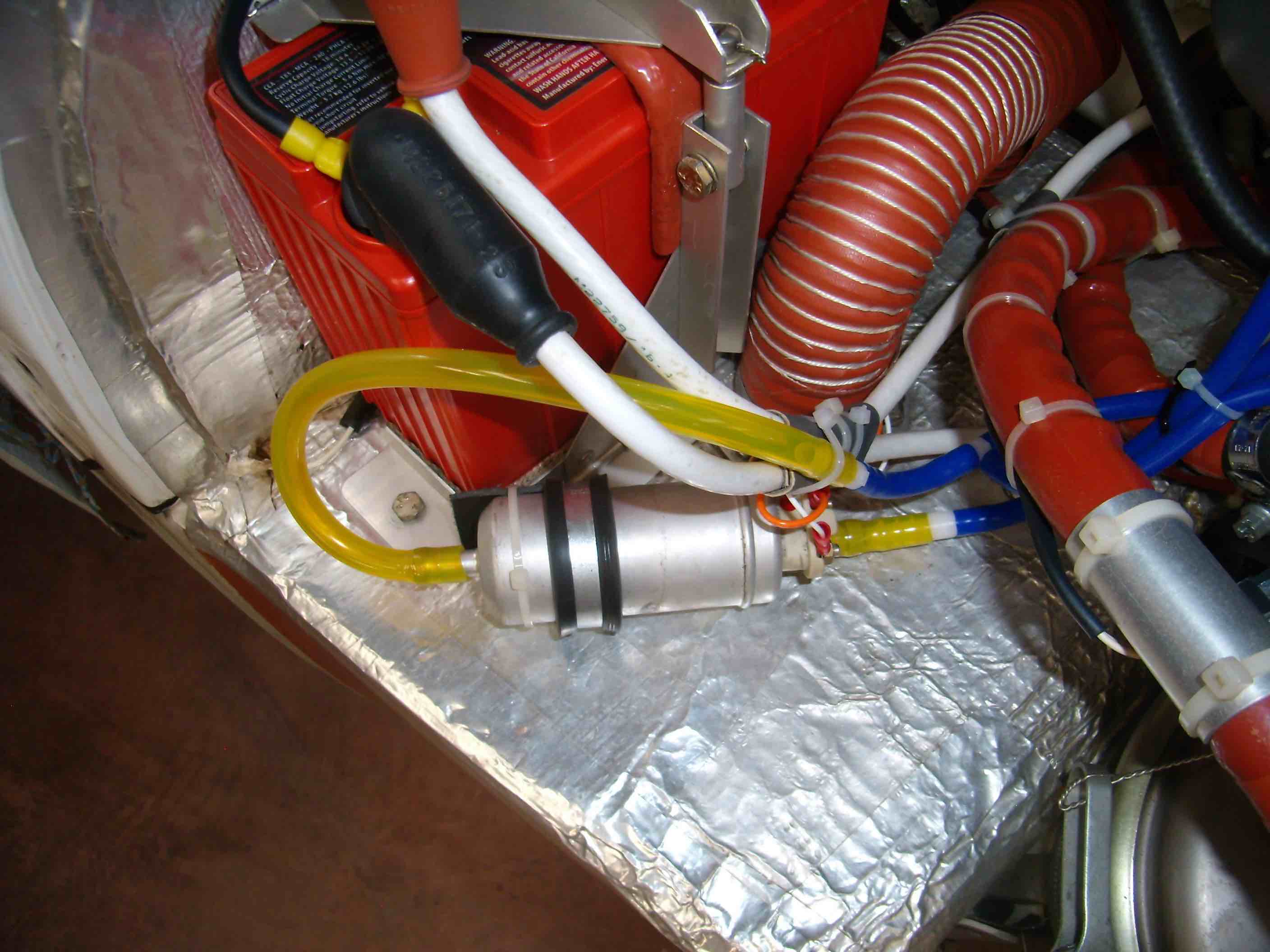

First I want to say that I am not the inventor off the principle of creating a vacuum in the float bowl using an electric pump to lean the Bing carbs. This leaning device was designed about 20 years ago by Michel Colomban, designer of the Cri-Cri and MC100 on which the well known DynAero MCR series were based. He designed his own pump to create the vacuum. The vacuum is adjusted through a potentiometer and the mixture ratio is measured using an O2/ lambda probe. Attached are some original Colomban's drawings (in French, sorry)
My system uses an electric fuel pump (Pierburg E1F p/n 7.21440.51.0) to create the vacuum. The vacuum side of the pump is connected to the two carb bowl vents and the pressure side is connected to the airbox, through a combination of polyurethane and silicone tubing, nylon tees and straight junctions. See attached pictures. The vacuum is adjusted using a potentiometer and some electronics to control the pump voltage. The actual voltage at the pump is being measured during testing.
Initial testing showed that the pump was way too powerful and I had to add a by-pass around it which incorporates a calibrated .8 mm restrictor, to reduce the effective vacuum. In order to calibrate the system on the bench, I measured the vacuum using a U shaped clear tubing filled with water. (btw I remember Colomban saying he was using red wine to better visualize the level). With the by-pass, the system provides the following vacuum levels: 3 volts at the pump=20mm H2O. 4V=30mm, 5.5V=40mm, up to 13V=220mm.
Testing on the aircraft (912ULS + Airmaster prop):
On the ground (altitude 2000ft): at 2700 RPM, progressively increasing the voltage at the pump, RPM increases and when reaching 4 volts the RPM peaks at 2900, then goes down and starts to run rough above 4V.
at 4000 RPM, progressively increasing the voltage, when reaching 4 volts the RPM decreases and engine starts to run rough.
In flight at 10000ft, full throttle, 5000 RPM, propeller in Manual mode to freeze the pitch, when reaching 4 volts the RPM decreases to 4900 and engine starts to run rough.
Interpretation of the results: the vacuum necessary to lean the mixture on a Rotax 912ULS at 10000ft is 30mm H2O approx.
Leaning on the ground at high idle increases the power, which means the idle mixture was way too rich.
Leaning at 10000ft does not increases the power at all. That means that, without leaning, the mixture is not rich enough to prevent the engine to deliver full power as it is with legacy aircraft engines. I suppose leaning would slightly reduce fuel flow of the Rotax at this altitude but I had no means of measuring the gain accurately and also no means of being sure I was not damaging the engine. That is why I stopped the experiment at this point.
Concerns regarding the pump: it is designed to pump fuel not air. In normal use I suppose the fuel cools and lubricates the pump. Pumping air, even at reduced voltage, the pump could be damaged. An alternative would be to use a ventilator. I found some ventilators which are able to provide the required static vacuum but I think there is a risk of overheating because there would be used at zero flow, which is not what there are designed for. Some endurance testing would be required to find out.
Compared to the Hacman, the electric leaning system has a few advantages: there is no modification of the carbs. It is fail safe: if the pump stops working your are back to the normal configuration where Carb bowl pressure equals air box pressure. In case of a problem, just switch it off.
Now why is the high altitude behaviour of the Rotax so different from the legacy aircraft engines? On Lycoming and Continental engines carburettors there is a power enrichment device (improperly called "economizer" by Marvel Schebler) which provides a lot richer mixture when the throttle nears the full forward position. This is necessary to better cool the cylinders heads to prevent detonation at full sea level power. At 10000ft, full throttle will give only about 55-65% power, depending on the prop, so the power enrichment is not necessary anymore. Then the power enrichment and the effect of air density combine to provide an extremely overrich mixture. At full rich at 10000ft, those engines will run rough and the spark plugs may foul if you do not lean. When leaning appropriately, you will see a very significant increase of power.
On the 912 and 912S, the figures provided by ROTAX in the Owner Manual show that the specific fuel consumption at full sea level power is the same as at cruise power. So obviously there is no power enrichment system. (there is one on the 914 but that is another story). The Rotax water cooled cylinder heads temp are a lot lower than those of the air cooled legacy engines and that makes detonation a lot less likely, therefore a richer mixture at full throttle is unnecessary. So at 10000 ft ,the 912 is running slightly too rich due to the reduced density but not to the point of limiting the available power. Flying at 16000 ft over the top of the Mont Blanc, the Rotax runs flawlessly. An appropriate leaning device would for sure provide some fuel saving at high altitude but more testing would be necessary to find out how much.
The attached photos show the pump installed on top of the starboard foot well, the connection to the carbs and airbox (blue and black tubing), the by-pass (blue tubing connected to two tees), the controller and voltmeter on the passenger seat.
Remi

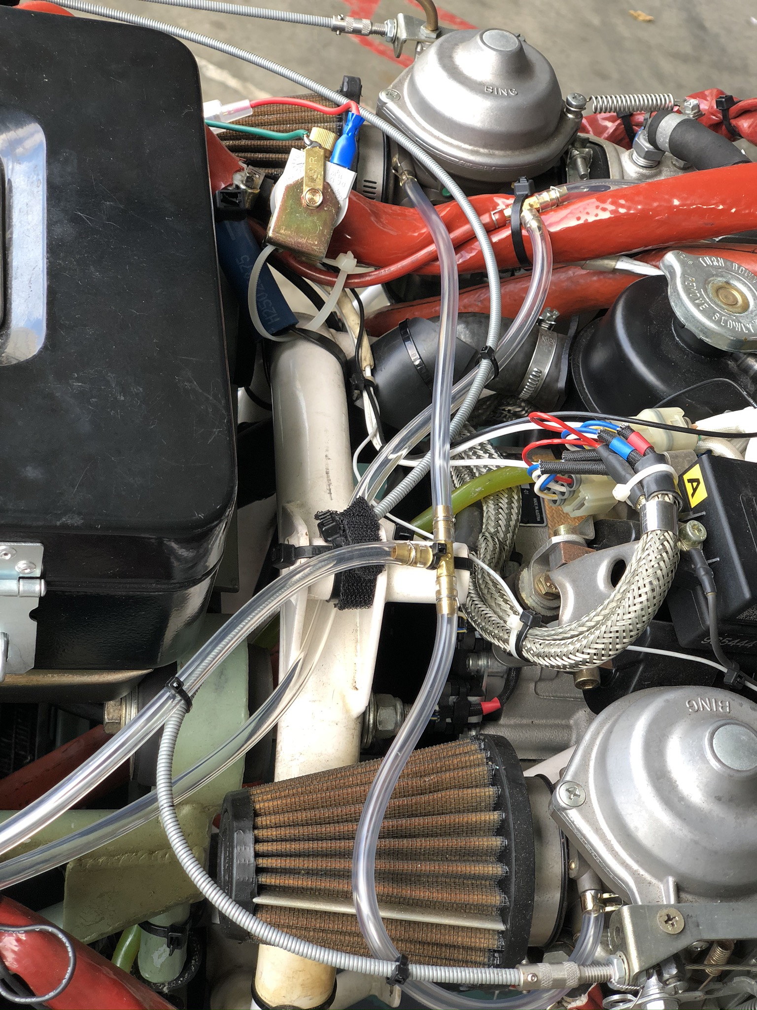

Have you installed it? I just bought one for my 912ULS but they sent me the Jabiru kit instead. I’ve emailed and phoned to get the
Right part but get no reply. I have installed it but don’t know if I can modify the 90° barb out to the filter and orifice. I don’t know what size orifice to drill.
Remi
I’m very interested in your tests. I’m thinking of installing a vacuum pump to achieve same results. I’m not sure what 30mm H20 is in psi?
Coop

PostPosted: Wed May 13, 2020 12:01 am    Post subject: Re: Hacman Gen 3 Mixture Control Reply with quote
Coop,
30mm H2o= .043 PSI
That is an extremely low pressure.
I am working on a new device using an small axial fan to generate the succion. It works very well on the bench. I will test it in flight within the next few weeks and will come back with the results.
Remi

PostPosted: Wed May 13, 2020 1:09 am    Post subject: Re: Hacman Gen 3 Mixture Control Reply with quote
Look forward to hearing. I bought a micro suction pump to try out also. Won’t arrive for two months though, but will let you know.
I find with the hacman taking its suction from the Venturi runs out of suction and I can’t get to peak EGT
Coop
