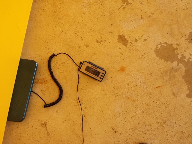

Would original Twinstar wing weight help at all?[img]cid:part1.091BE490.E75638BA(at)gmail.com[/img]

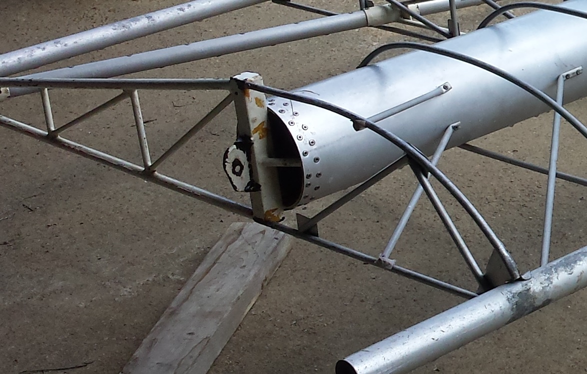

I'm almost certain they are 5". The  root weldment in this pic is 7" tall.
Yep, looks like 5". Thanks,

You’re correct. My Twinstar MKII had 5” spars. I think the change to 6” spars came with the Twinstar MKIII series.
