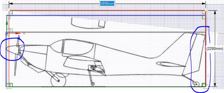

As part of contingency preparation for a prospective trip I would like to check the feasibility of fitting a Europa XS Mono in a 20’ container. The 20’ container is attractive, in that the Europa would just fit in as a complete aircraft with wings detached. Assume the availability of a fuselage cradle, strapping and air bags to fill the remaining void.
Perhaps someone is currently using a 20’ container as a hanger?
The key point appears to be the difference between length of the aircraft fuselage and the available internal length of the container. The remainder is 50mm not much margin for error! On paper it should work? But how does the prospective solution look in the real world?
Diagram attached.
Bob

The rudder's easy enough to remove. So's the spinner!

Hi Jonathon and the three others that replied off list.
Good input. Thank-you.

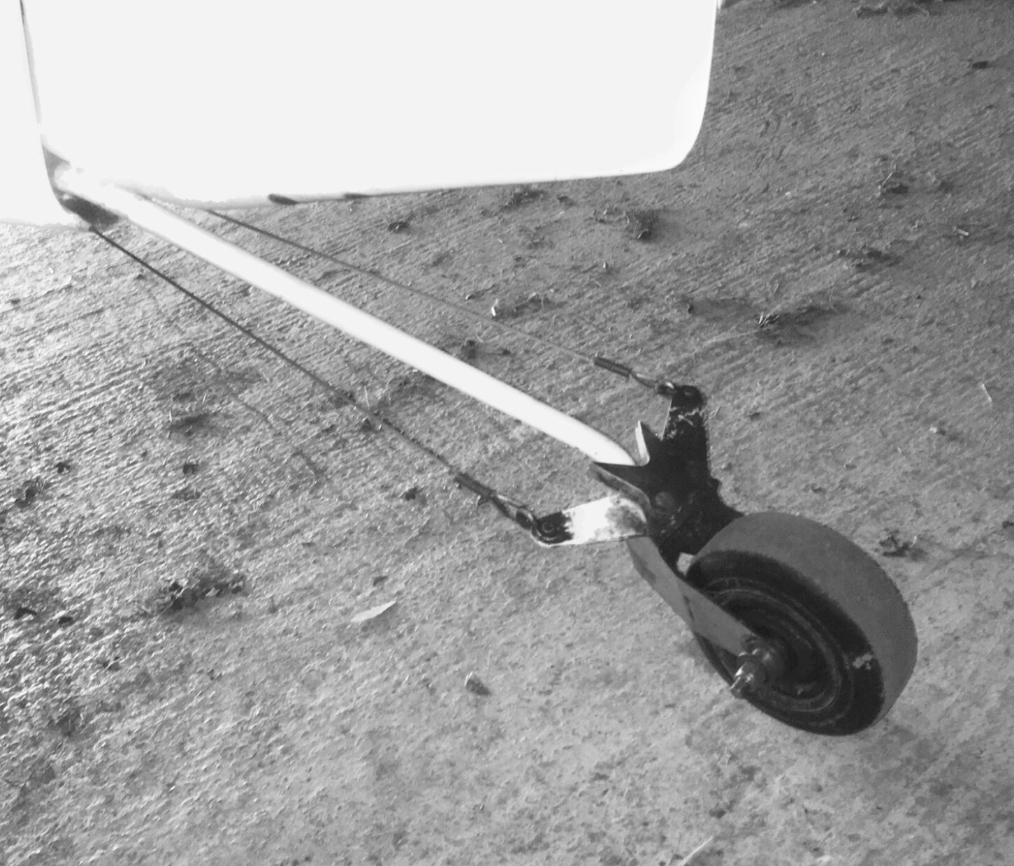

What has become clear is how seemingly perfect it would be for the Tri-Gear. But, in my case, being a tail-dragger with a Singleton tailwheel removing the rudder doesn’t bring a big advantage. See picture. The Singleton tailwheel projects a long way beyond the fuselage. Furthermore the rakish angle of the Mono on the ground also consumes marginally more of the available length inside the Container compared to the Tri-Gear. (See picture below)
Noting in the ideal circumstance I would not want to remove a control surface.
Nevertheless it has been a good exercise. A 20 foot container is great contingency option. Thanks to all for the advice.
And for the record I love the Singleton tailwheel. It is just so much more forgiving than its predecessors.

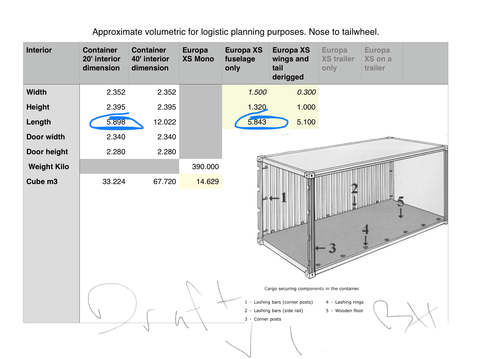

What about putting it diagonally or using a 30 foot container.
I know when i was looking at storage in a container located at an airfield i ruled out a 20 foot container.

Hi Patrick.
Thanks for your useful comment, a slight twist may help!
Am reconciled to the use of a white gloves service or the 20 foot in any hopefully rare hypothetical worse case recovery. Whenever I’ve had an issue to date I have been able to solve with parts carried or have received outstanding support from European based Europa Club members or general friendly airfield support in Europe.
ISO shipping containers usually come out of the factory as 40ft or 20ft, the universal size for intermodal transport and shipping. A 20ft container is are always available. The 30ft is rare by comparison and is often a cut down 40ft. The price paid for hiring a 30ft container would likely be the same as a 40 foot. The larger the container the less chance a small port on a small island would be able to handle in a contingency situation of trying to get your plane back from the middle of nowhere. If constrained to not use multimodal containers the costs increase. So ease of using multimodal transport is key. The cost of handling increases with size. So the movement of a 20 foot container is say £1000 to £2500 depending on where in the world you are stuck. A 30 ft or 40 ft would be say £1800 to £3500.
It is possible to contract out the solution. A white gloves service capable organisation could sort out the return, paying £1500 to well over £10000 . Key is what was the incident that necessitated the contingency and what event the existing aircraft insurance covers. What is paid for the insurance and what does the insurance actually cover in respect of recovery, if anything.
White gloves service: A premium delivery service, with special attention to details, especially with fragile or very expensive items, such as works of art (i.e. a Europa).

What an ordeal Robert - thanks for sharing such great detail though - the rail shipping loadcase insight is an especially useful tip.
I have my Mono at home in my single UK garage at the moment and as a result of this post, decided to take a few measurements to see how/if mine might fit into a 20ft container.
The image of the Mono in side view [attached] comes from the Owners manual, scaled to the right length and height for my aircraft. The envelope outlines shown are the 20ft container dimensions in red, my garage dimensions in blue and the dimensional figures from the manual in black. It is clear that removing the spinner will save some space (how much depends on your prop spinner - for a Woodcomp the saving is ~30mm), as will removing the rudder.
Interestingly, with the rudder removed, the rear of the fin is more or less vertically above the tailwheel (Singleton tailwheel), and its removal saves around 250mm on the overall length of the a/c on its wheels.
It may also be possible to get some extra length clearance in the container simply by turning the attached rudder to one side - and there is always the possibility to position the aircraft diagonally in the container of course.
My garage is about 200mm wider than a container and at a push i can stow both my tail-planes on top of each other in the cockpit space (yes the doors do close - but plenty of padding needed), and the main wings will go leading-edge downwards on some supports alongside the fuselage (no tools or bench in the garage then of course).
I also have a Mono trailer and the aircraft goes into my garage space comfortably in width and height - but i did have to extend my garage doors to accommodate the length of the aircraft on a mono trailer, to 6200mm.
