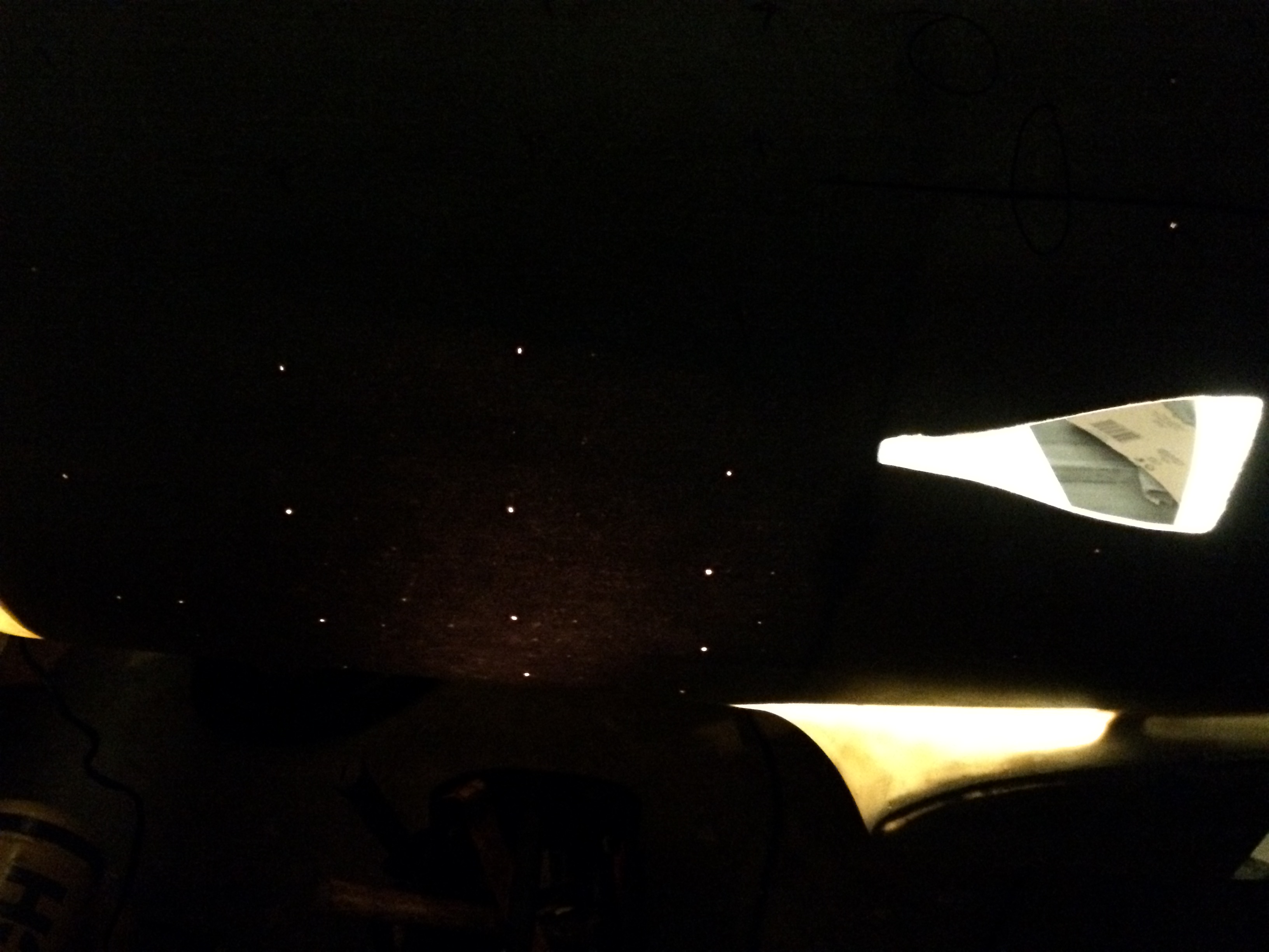

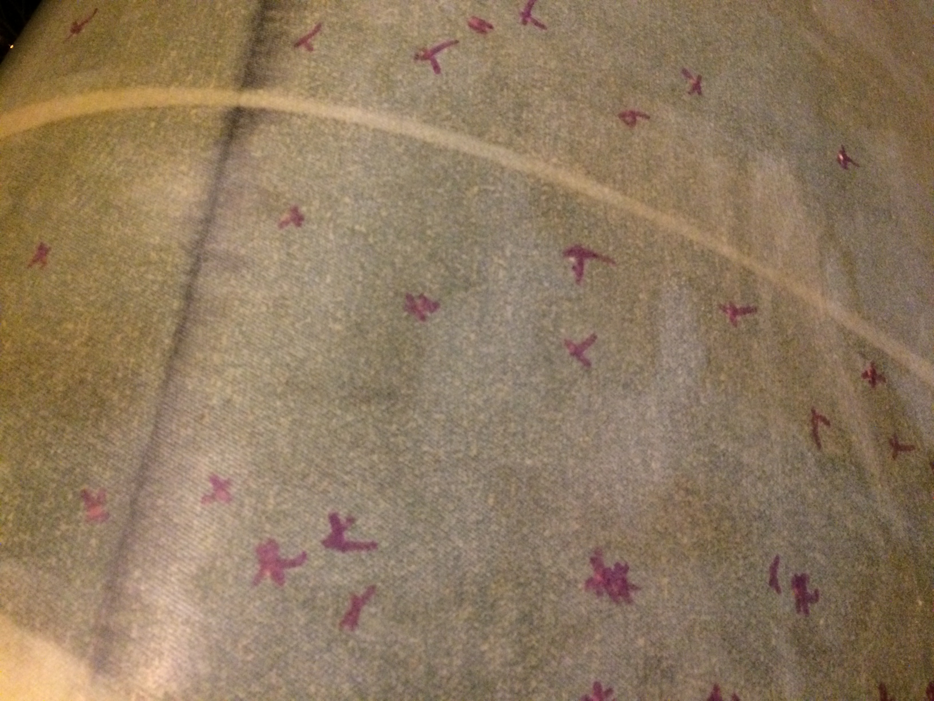

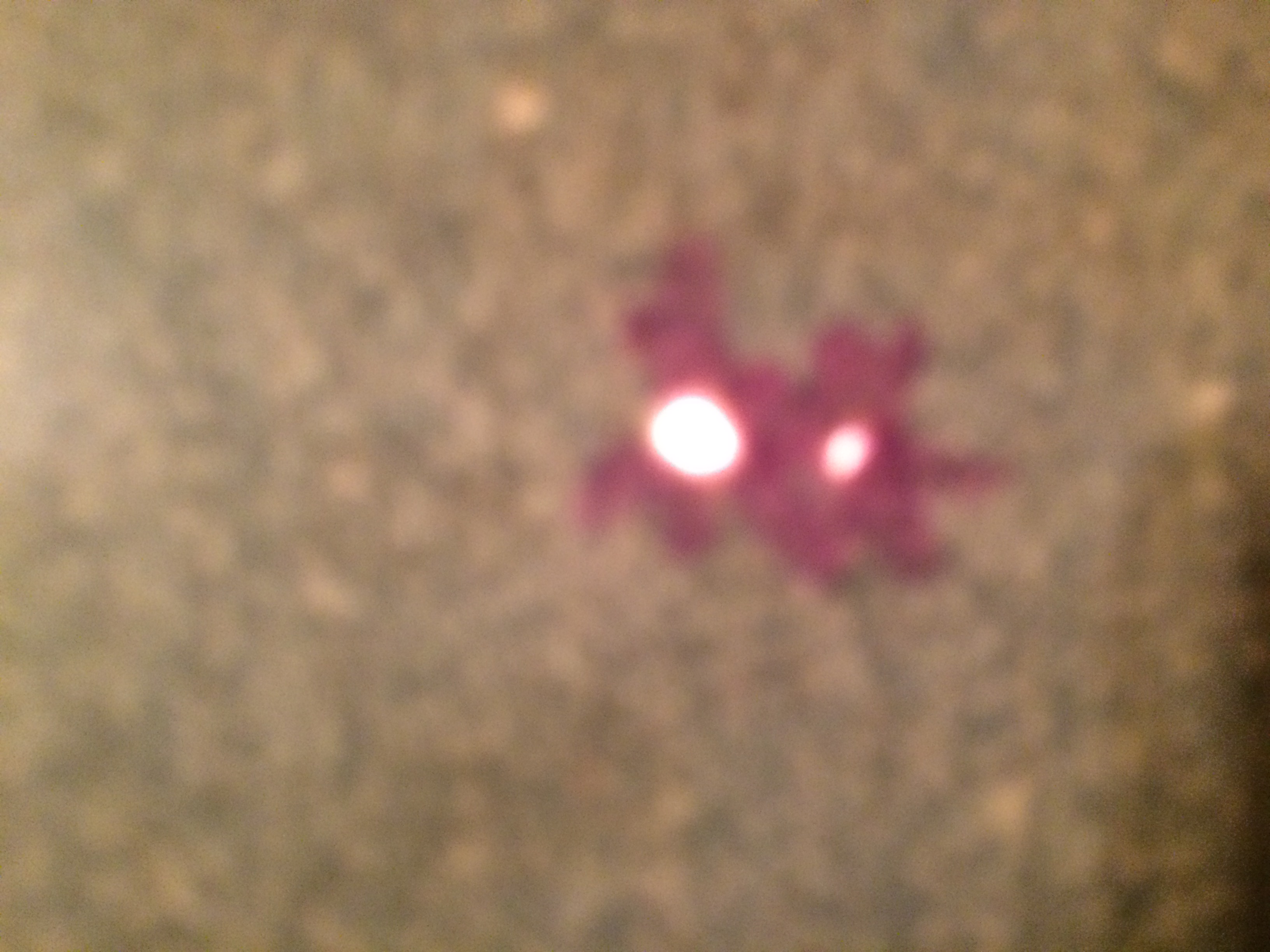

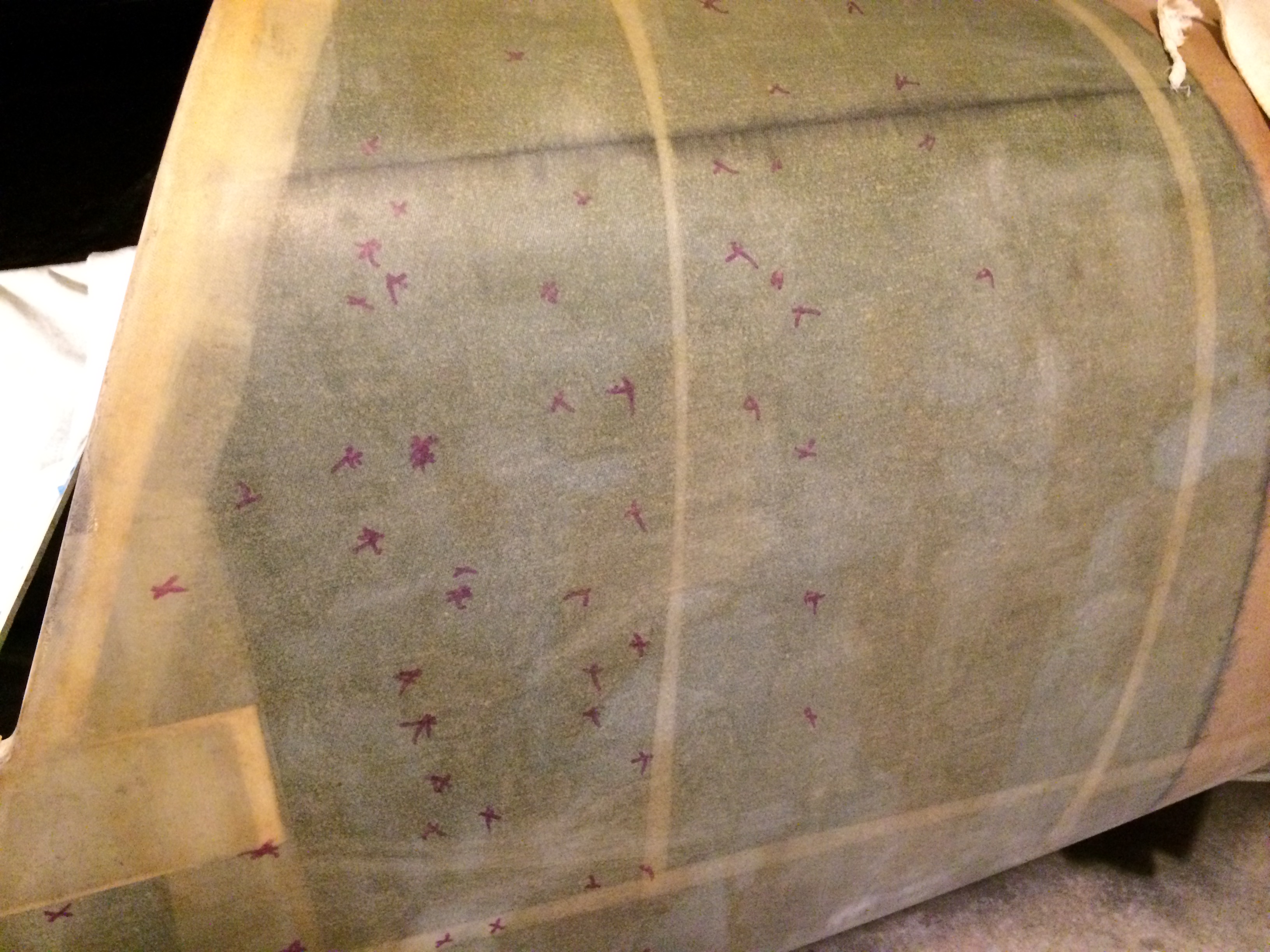

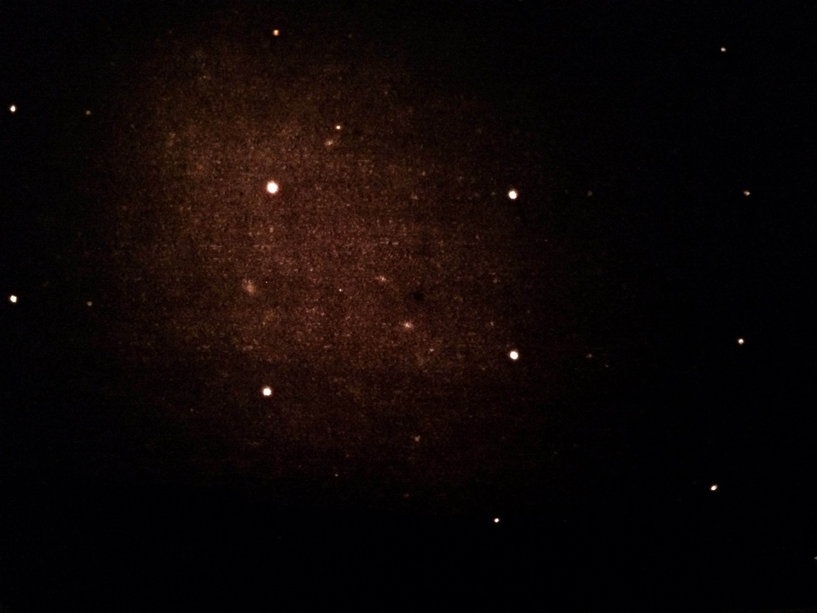

Dear Pulsar folks,
Attached are the pictures of the voids I have discovered during the construction of my Pulsar.
I have a shop light shinning on the inside of the fuselage and the voids are noticed on the outside of the fuselage. I have marked a tiny x over each void. I estimate that I have marked around sixty of the these total.
Please examine and let me know if I need to include any other information or photographs.
Thanks to all for your help in advance!
Clyde

Clyde,
These voids were probably created in order to allow the resin to flow better so the fiber glass cloth on both sides of the foam core would attach better to the foam core. I don't think you need to worry too much about it. You are welcome to ask Mark Brown the original designer of the XP if you wish to have a peace of mind. Someone in the Pulsar group should have his phone number.
Solly Melyon
