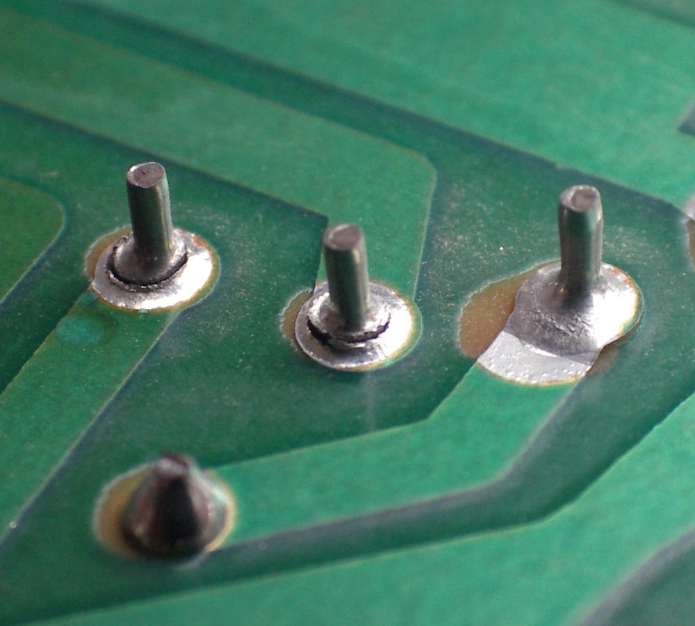

[quote="kjashton(at)vnet.net"]Just watching a video the other day about old solder joints that break or crack due to hot/cold cycles or mechanical stress. They are difficult to detect with the eye but I think I would try to touch as many of your joints as possible with a small soldering iron.
-Kent
I had this happen on an automotive dashboard mounted environmental control that worked intermittently. The circuit board had a control side and a power side. Some of the power side solder joints looked like this photo. I had a theory it happened on the power side due to greater thermal excursions perhaps in combination with other factors. Remelting fixed it.

PostPosted: Wed Nov 06, 2019 12:13 am    Post subject: Engine monitor display scramble from EFI sense line EM2 fro Reply with quote
I think I may have found the culprit in a bad solder joint on the DB37 connector that is used. It was not on the pin used for the injector pulse in question but on a nearby pin that is used for the crank angle sensor, which is known to be a noisy signal at the best of times so careful shielding and routing of the wires is called for. Unfortunately inside the crowded confines of a DB37 connector back-shell, this is a difficult task to isolate from the other wires sharing this connection. So a bad solder joint on an already known noisy wire packed tightly with my suspect wire, sounds like a plausible cause.   Quick and easy repair, but I'll have to wait until the weekend to go back up to the airport to test it.
Thanks for the comments

> EM2 display is rock steady (up to a 10 minute ground run) but with no
> RPM or any fuel, power, or efficiency data. Connect the line and it
> immediately will scramble. I estimate that the frequency of the
> injector pulse on this line would only be at max about 100Hz at 6000
> RPM. I've considered that a simple low pass RF filter to ground may
> work as the frequency that I'm trying to measure is well below what
> the filter would remove, but would it still have an effect on the
> pulse width? which would be undesirable as that would effect the
> signal driving the #1 primary injector.
>   I'm hoping that someone can suggest an easy fix so that I can
> implement it when I get back up to the airport this weekend, other
> wise if more data is needed to help find a solution I will take a
> scope up there and try to get some more detailed data.
>  Right now our days are getting pretty short up north here so it's
> dark by the time I get off work, so I'm restricted to weekends only.
> Thanks for any help that can be provided.
> Todd Bartrim
