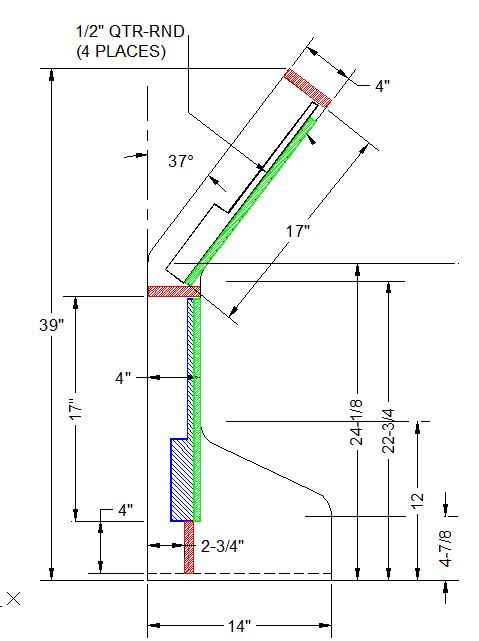

Interesting idea (and well executed). I'm sitting at my computer, trying to visualize what it'd be like to add a 2nd monitor above the current one. Trickiest thing for me (after retraining to look up/down instead of side/side) would be managing my progressive bifocals.
Charlie
I set up the screens for a 25-27" viewing distance
(37 degree forward tilt on upper screen).
You might check on a prescription for 'computer
classes' . . . a one distance cut on the lenses.
Zenni and others are very inexpensive for on-line
orders.
I've had both lenses replaced due to cataracts and
the depth of field is phenomenal. I'm putting
work product on the lower screen and reference
materials on upper screen. I barely need to tilt
my head up to access upper screen data. I'm 99%
functional without corrective lenses so that
helps!
The biggest 'worry' so far is that the
footprint on the table is dictated by the monitor
width and tilt angle (to keep solid support
centered on CG). This puts my mouse a bit further
out to the right. I'll have to see what human
factors arise from that change. I've got a
plan-b in mind if that proves prolematic.
