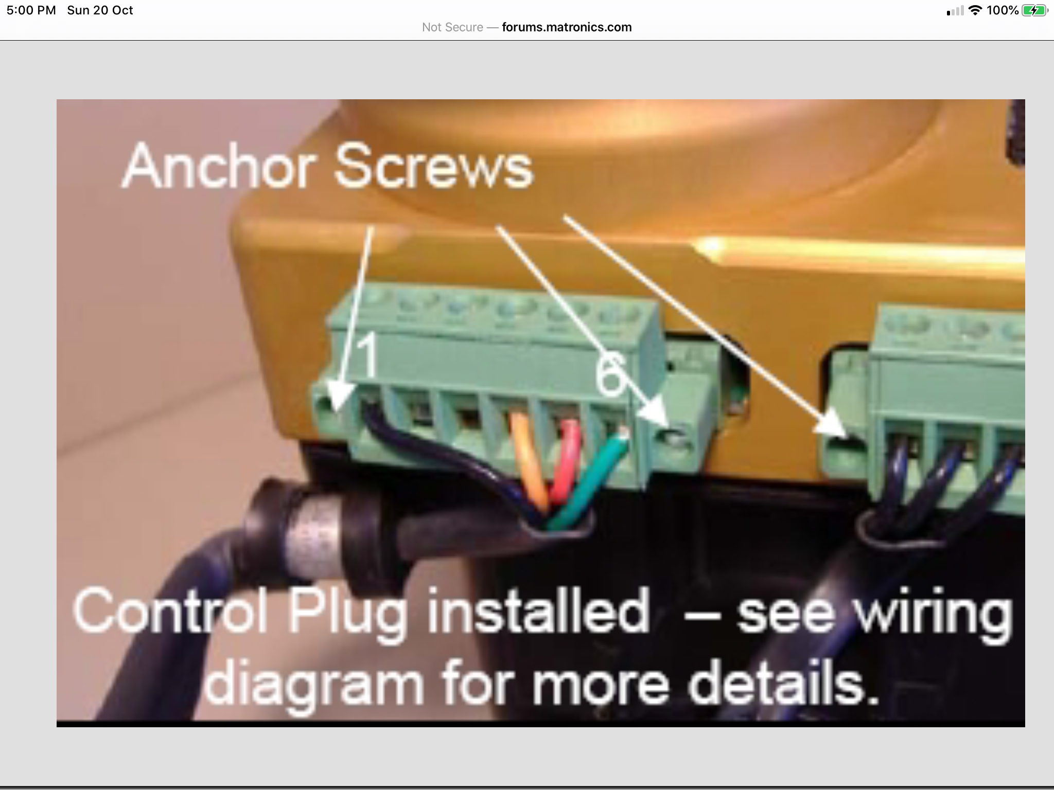

What’s a good way to attach a diode to the Pmag connector? The diode has small solid wires that go to screw down sockets #1 and 6 that also get one 18-20 ga stranded wire in each socket .

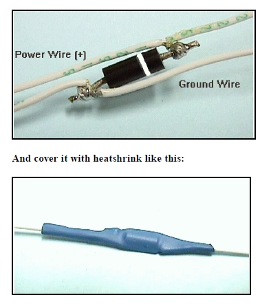

Or in-line with a technique like this:
[img]cid:.0[/img]

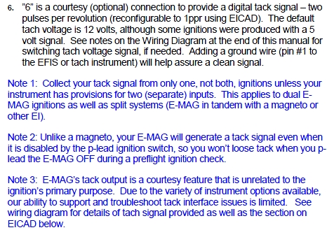

Quoting from EmagAir's installation data
[img]cid:.1[/img]
Adding the suggested diode depends on
the tachometer being incapable of working with
the stock, 12v tach signal emitted by
the eMag.
Adding the diode clamps the 12v signal down
to 5v for such cases. Do the Tachometer
instructions specifically state that the
input signal cannot exceed 5V?

After reading the manual on the GRT EIS I conclude that the tach signal should be 12 volts as you surmised. Should have read that first, but then I wouldn’t have seen the clever way you installed a diode in-line. That was worth the post. Never in a million years would I have come up with that on my own.

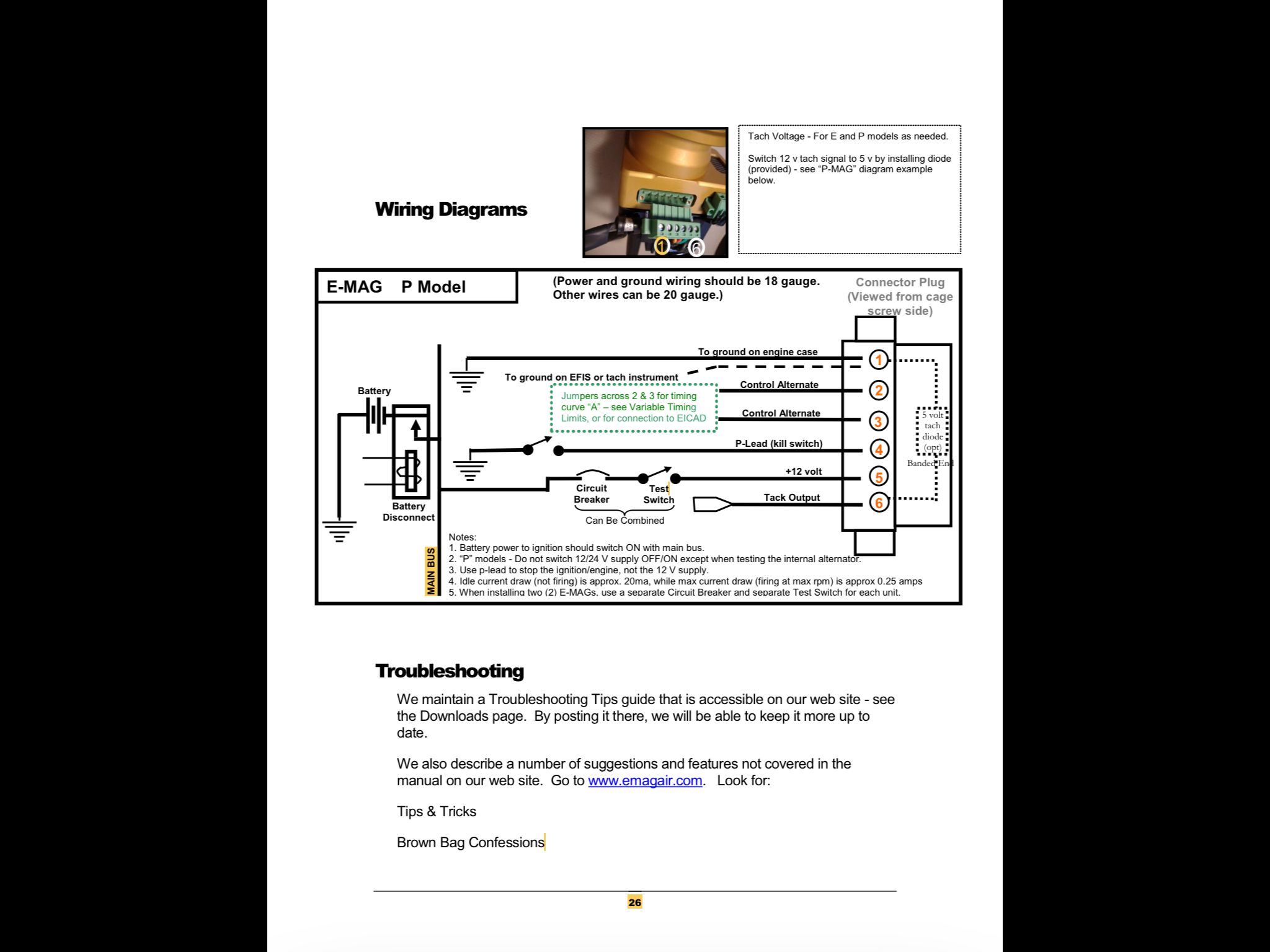

The clip from Emagair that you posted points to other issues and the reason for a separate thread. And that is how to configure and connect the EIS and the Pmag for the tach signal. Because the EIS looks for one tach signal per revolution and the Pmag generates two tach signals per revolution, one system’s configuration will need to be changed. They are both reconfigurable but I don’t know which would be better/easier.
Also confusing is that Pmags note #1 says to “collect the tach signal from only one Pmag unless your system has provision for two separate inputs.” The GRT EIS has only one tach input but two magnetos can be connected to it. Where do you hook up a second Pmag to a GRT EIS if the instructions to connect are in conflict?
If magneto #1 is working the EIS will read that signal but if magneto #1 is disabled (as during a mag check), the EIS will read the tach signal of magneto #2. Pmag note #2 states that a disbabled Pmag will still generate a tach signal so you won’t lose tach during a mag check. Huh? If a disabled Pmag is generating a signal, how do you not “see” it? What am I missing?

The eMag ignition outputs a tach signal even
if in IGN OFF condition . . . I'd just hook
up one ign to the tach and call it good.
