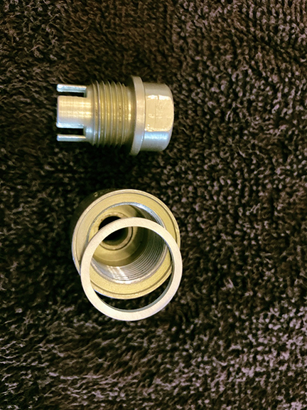

It’s a simple thing to rebuild them. Doug Sapp provides the parts and all that’s needed are two 17 mm wrenches. For those check valves that are too far gone from internal corrosion, the replacements that Doug builds are excellent. Regardless, whether you rebuild or replace, they still need to be swapped out every few years. No way around that no matter who makes them.
Just me, but I like to replace the soft lead washer with a soft aluminum crush washer that’s been coated in WD40 to reduce deforming during tightening. Very solid seal. Attached is an image.

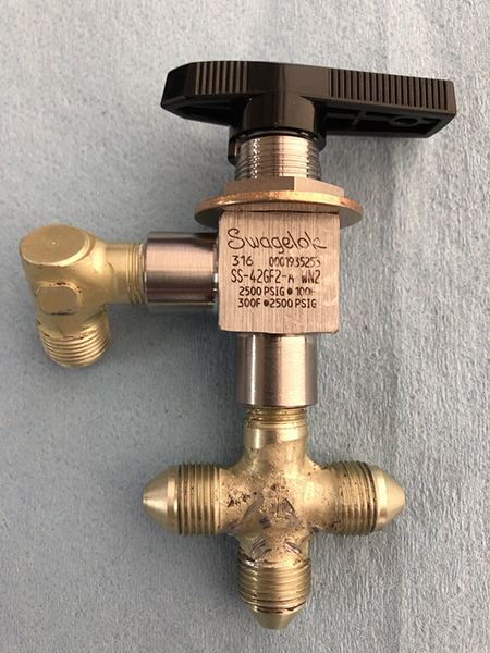

Personally, I’m not a big fan of the Swagelok check valves. They are not very robust. Have seen too many fail. On a flight to Oshkosh a few years ago one of the members of our group had several fail by the time we got to Nebraska from Arizona. Spent a long time on the tarmac at the Lincoln airport replacing them with Chinese ones, which kept working for the next three years.
Exceptions are the Swagelok main and emergency on-off valves. They are fantastic and seem to last forever. The 90 degree, 2-port one is SS-42GF2-A-WN2 with the black handle. Attached is an image of one configured for the main air.

The aluminum crush washers are generally available on Amazon, searching first by outer diameter in mm.

You will find a large selection of both copper and alum. Metric crush washers at McMaster Carr. They are listed by ID, OD and thickness.  I could give you a part number now but not in the hangar so may guess wrong.
I have been using the alum. ones for years for all the check valves and numerous other locations like rocker shafts and various plumbing fittings, etc.
