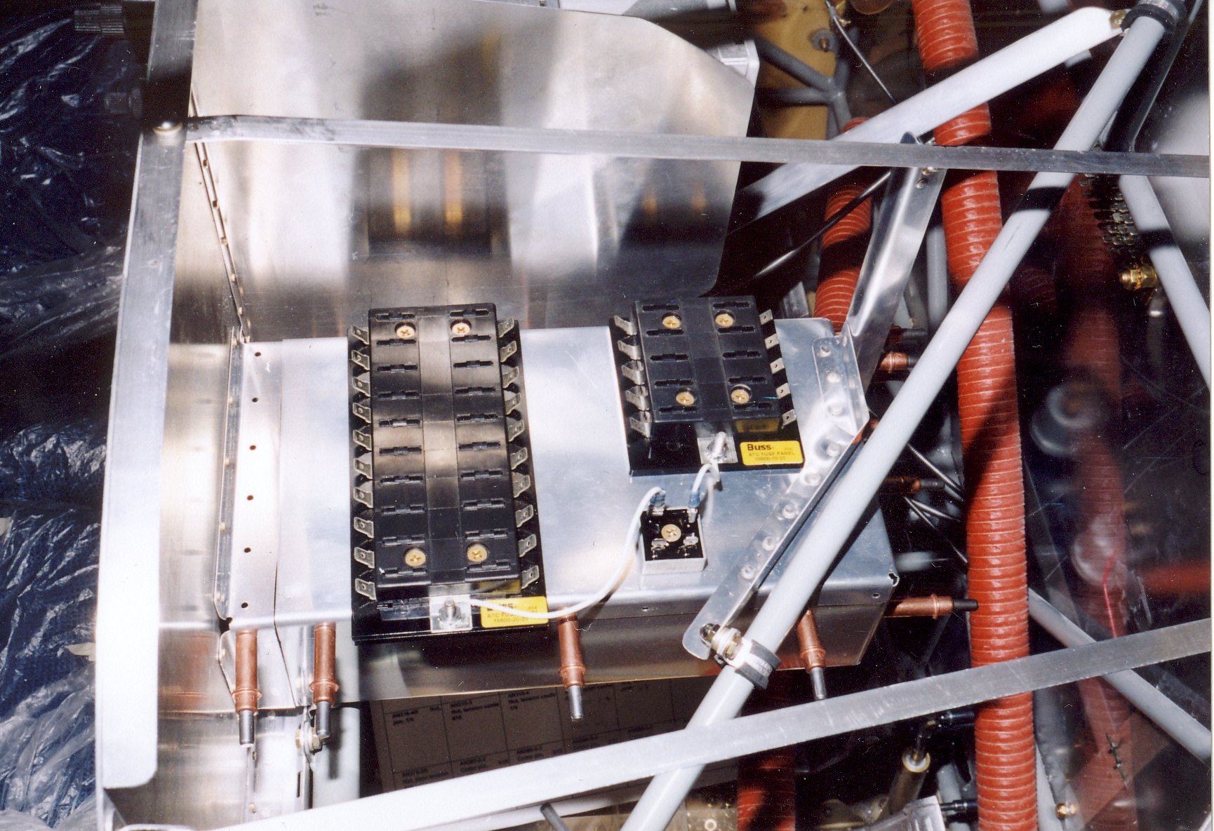

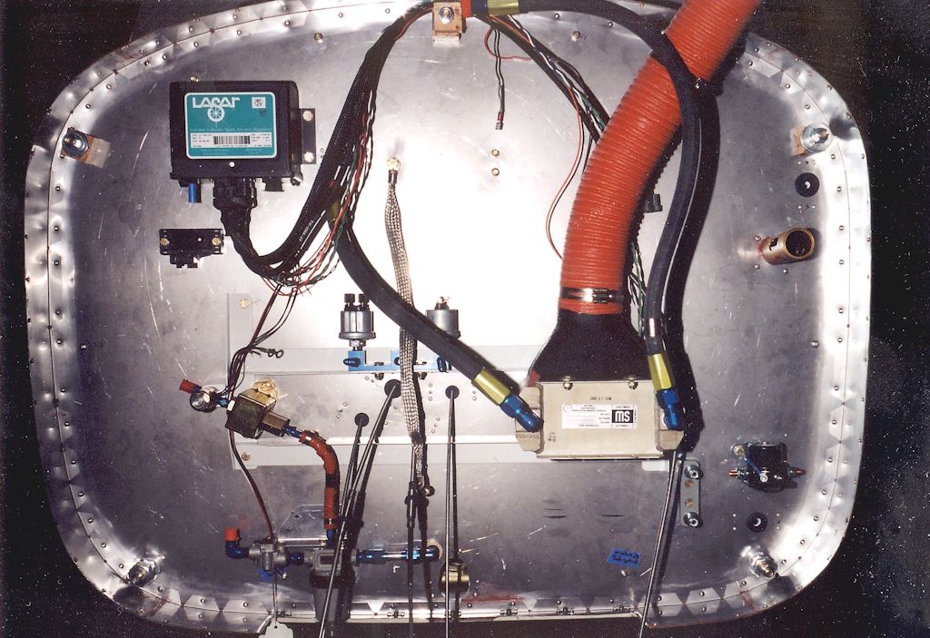

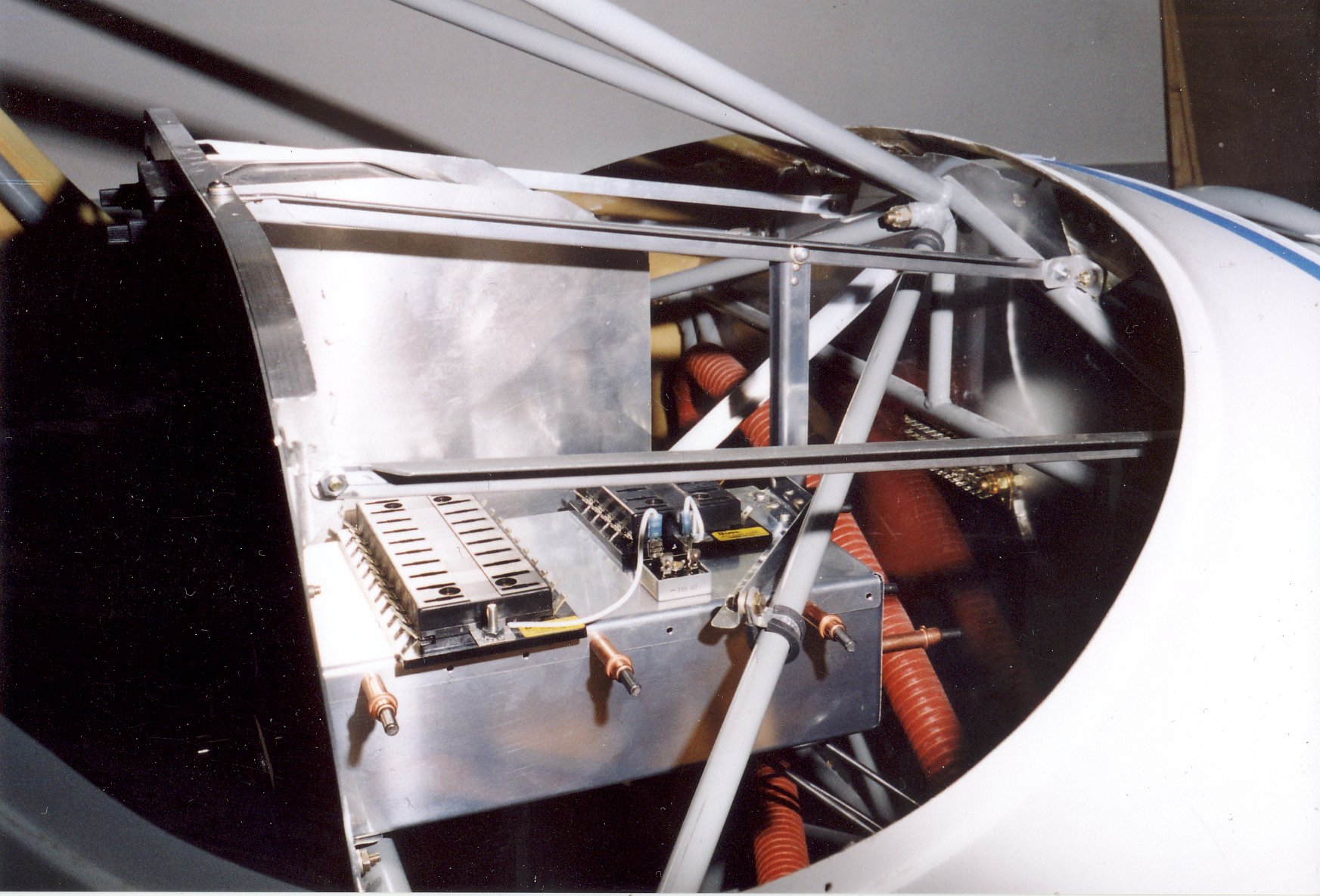

PostPosted: Wed Oct 09, 2019 8:03 am    Post subject: Wiring Diagrams and Pictures Reply with quote
[img]cid:part1.6A3C4AED.85AE870C(at)gmx.net[/img]
Rob hard to find some pictures from 16 years ago Smile Here you see the two fuseblocks of main and essential bus, if you go to the right you see on the FW the forrest of tabs (under that grey tube) from the ground bus and the big brass screw going through the FW where on the other side a flexibel strap goes to the engine. This is a plexi FW fitted to    see where to drill holes before fitting the real FW.
[img]cid:part2.E241114E.7FE857E8(at)gmx.net[/img]
[img]cid:part3.22023B8A.B2ED6A62(at)gmx.net[/img]
Thanks so much!

Mauledriver(at)nc.rr.com wrote:
just some random pics from my RV10 build of some years ago....
Thanks so much!
I made contact with Aerotronics and Jason Smith helped me out greatly and supplied me with a custom wiring diagram for my setup. Can't say enough about Aerotronics!
Currently building a Bearhawk 4 Place.
echristley(at)att.net
PostPosted: Tue Oct 15, 2019 11:52 am    Post subject: Wiring Diagrams and Pictures Reply with quote
Beautiful work, Bill, and I wouldn't change a thing. But, just a suggestion for other people considering those fuse blocks. You can get fast-tabs that have the wire exiting at 90 degrees. It really cleans up the wiring, and allows the bundle to lie flat.
On Tuesday, October 15, 2019, 11:21:53 AM EDT, Bill Watson <Mauledriver(at)nc.rr.com> wrote:
Fuse blocks and firewall ground
Dual Battery tray and wiring with ground
